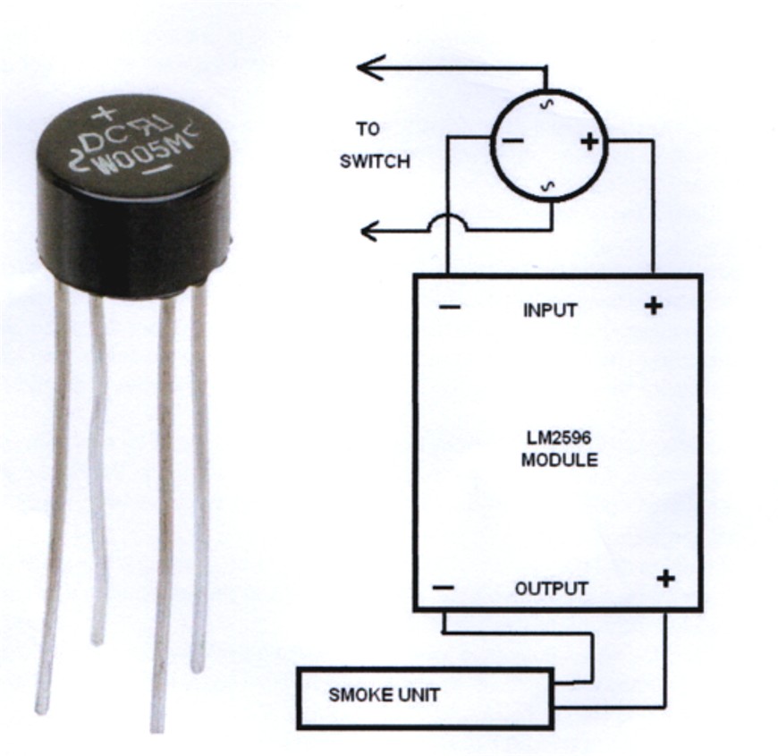

But it is polarity sensitive. It was a fellow Forumite that helped me when I wanted to install a 5v smoke unit.

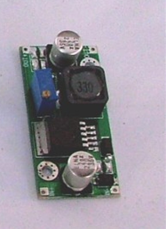

My line is really an end to end so slow speedsis there nothing you can put between the pickup wires before they go to a decoder to limit the 24v down to 14v max , I'm not an electrician so might be a dumb question.
There are variable adjustable voltage boards on ebay
View attachment 232563 But it is polarity sensitive. It was a fellow Forumite that helped me when I wanted to install a 5v smoke unit.
I'm not good with these things so I don't know it will suit your needs.
Mick, they give fixed DC voltage.. No good to drive a motor forwards / backwards at variable speed.
