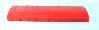

As for the canopy, it was obviously produced with its multiplicity of compound curves as it refused to straighten out with the applied heat of the blowlamp. But, waste not want not, I went out after tea and savagely attacked the edges with a hacksaw. Both sides now have a series of apparently indiscriminate cuts and the canopy has been straightened (I hope permanently). The edges were reinforced with wood strips behind them. I have used ABS glue and loads of mini clamps so I`ll know this morning if it has worked!
