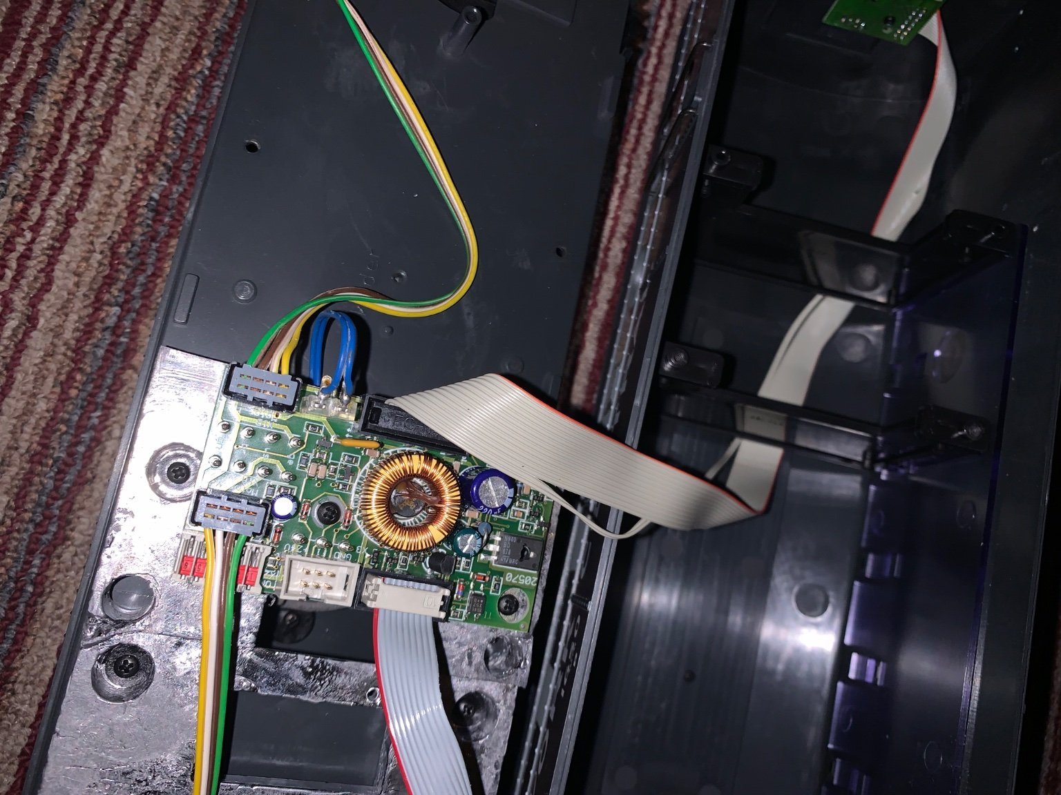

The below picture is of the main board that was in an LGB F7 A unit that I used to own. From the picture, can you identify the parts which make up the starting delay circuit?

Not easily..
A guess (amongst others) would be the orangey-yellow thing at the top of the board, and the big inductor.
But there will be more to it than just those.
It is a different circuit to the Massoth unit.
I assume you have a problem with one of these?

About seven years ago, the starting delay circuit in an LGB F7 that I owned stopped working (the engine would move at about one or two volts). And this happened after I had removed one of the wheel sets to clean them. In any case, a few weeks ago, I bought another LGB F7 (it was brand new, had never been run). I ended up bringing it to a friend of mine who fixes model trains, given that the traction tire needed to be replaced. He ended up replacing all of the engine’s gears, given that three of them had cracks. Afterwards, I brought the engine home, and the starting delay circuit had stopped working, just as the one in my other F7 had. I ended up repositioning the metal strips that are in the motor blocks, which fixed the problem (the engine now will not move until I give it at least seven volts ). This is very strange and confusing, and I am trying to figure out why this happened.
