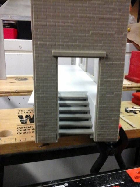

Cut and assembled the loading platform:
That 1/8" styrene had been sitting around for years. Yes, the other end wall fits properly.
The stair stringers came as a second set for the coaling stage, where I chose not to use them. The treads will also come from that kit, suitably shortened; I won't use the risers.
I will install more supports underneath before attaching the platform to the shed walls.

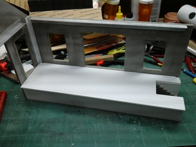

With the loco shed braced, I turned back to the goods shed:
I CA'd the loading platform to the left-hand end wall and side wall, then CA'd the right-hand end wall in place before reinforcing the corner with styrene angle and epoxy.
Yes, the platform has "stone" facing even though the shed is brick: The stone is what I had to hand.
The end walls have a vertical bow, which I hope will vanish when I put the other side wall in place.
Exterior view. I wonder whether I should fill in the bottom of the windows, which are very close to platform level, or apply safety bars or some such.
The stairwell.
I shall paint the interior before attaching the remaining wall.

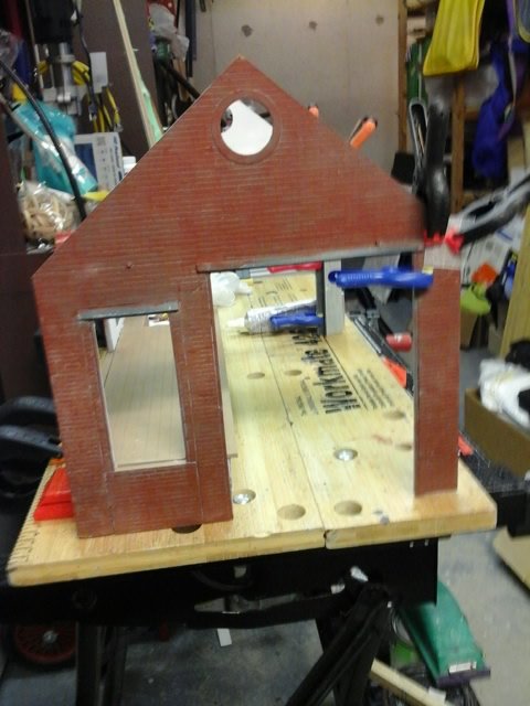

The goods shed end walls are restored. I found a forgotten tube of E6000 industrial adhesive that had given me good results on other projects, so I have hopes it will work equally well here.
I used black styrene left over from the hopper wagon builds to fish the wall pieces together ...
and a length of ABS 3/8" angle to straighten a bowed wall piece as well as reinforce the joint.
I shall wait a day or three for the glue to cure before a bit more interior painting, and then fix the fourth wall in place.
