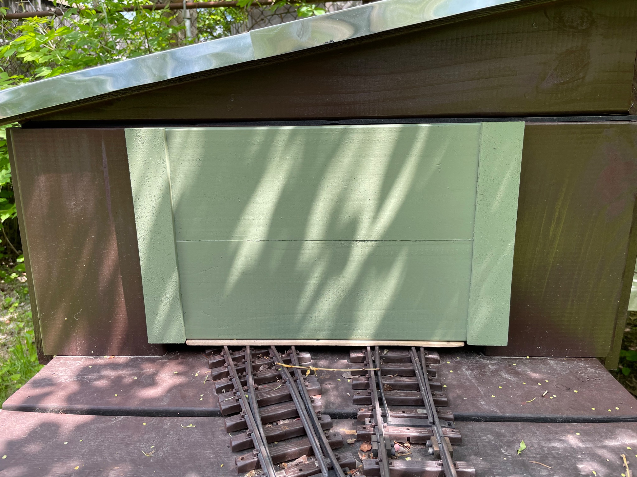

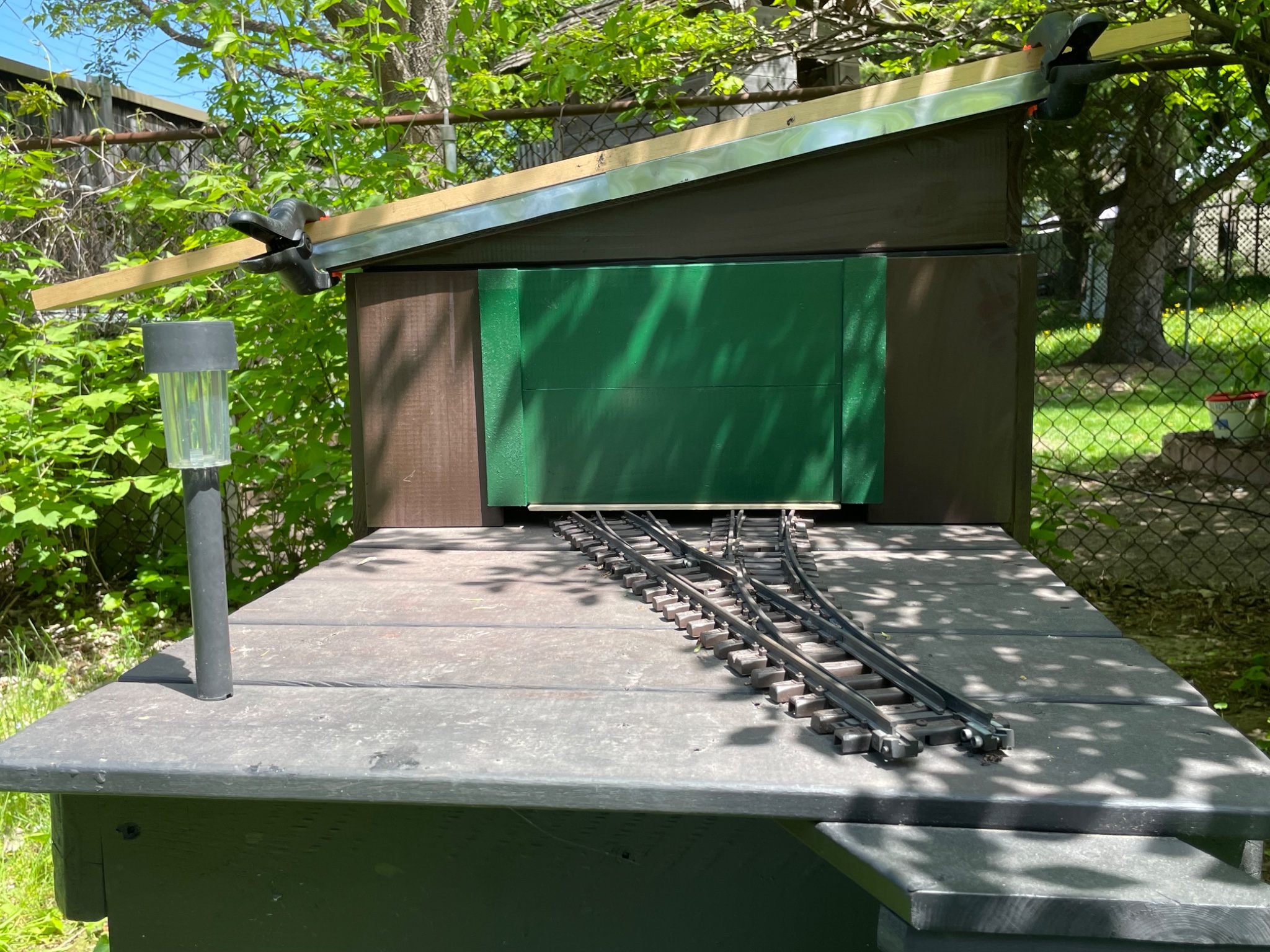

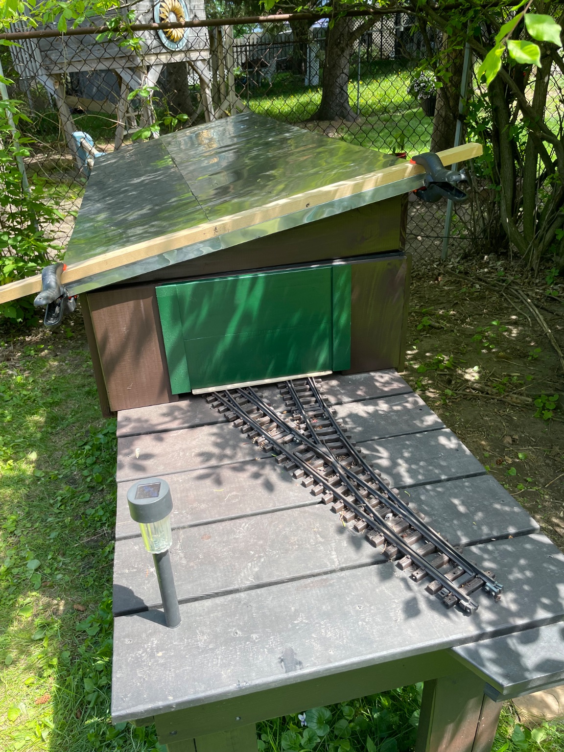

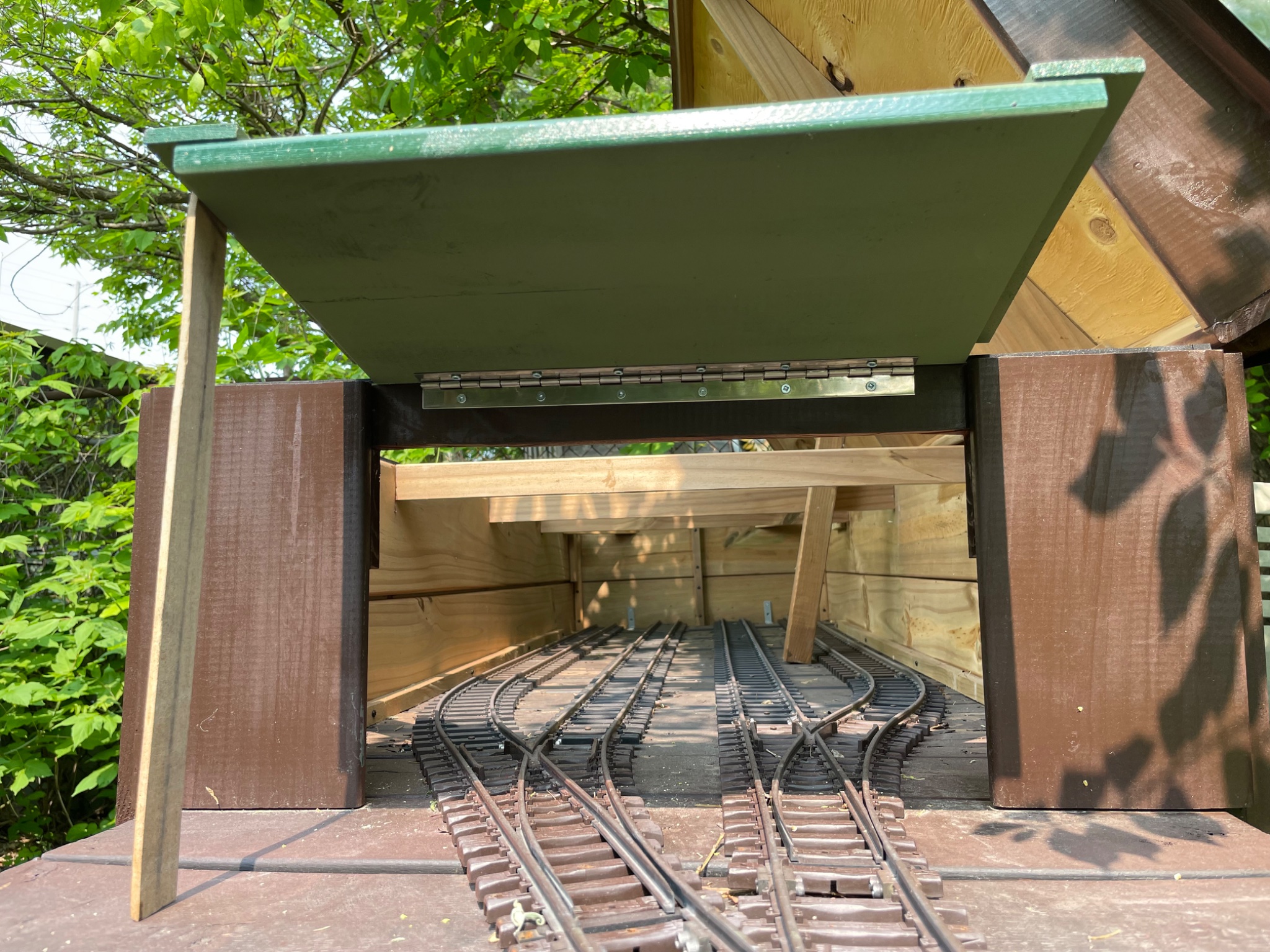

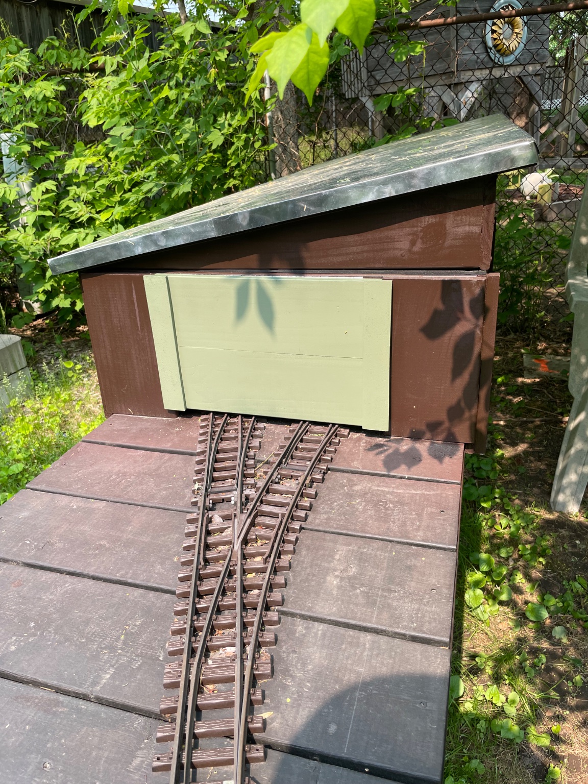

Errands run and Herself victualled, I went down the backyard (yes, in the mid-afternoon sun; Ol’ Sol had finally burnt through the veils) and installed the hinge on the train door.
The piano hinge is advertised as being stainless steel. We shall see :wondering:

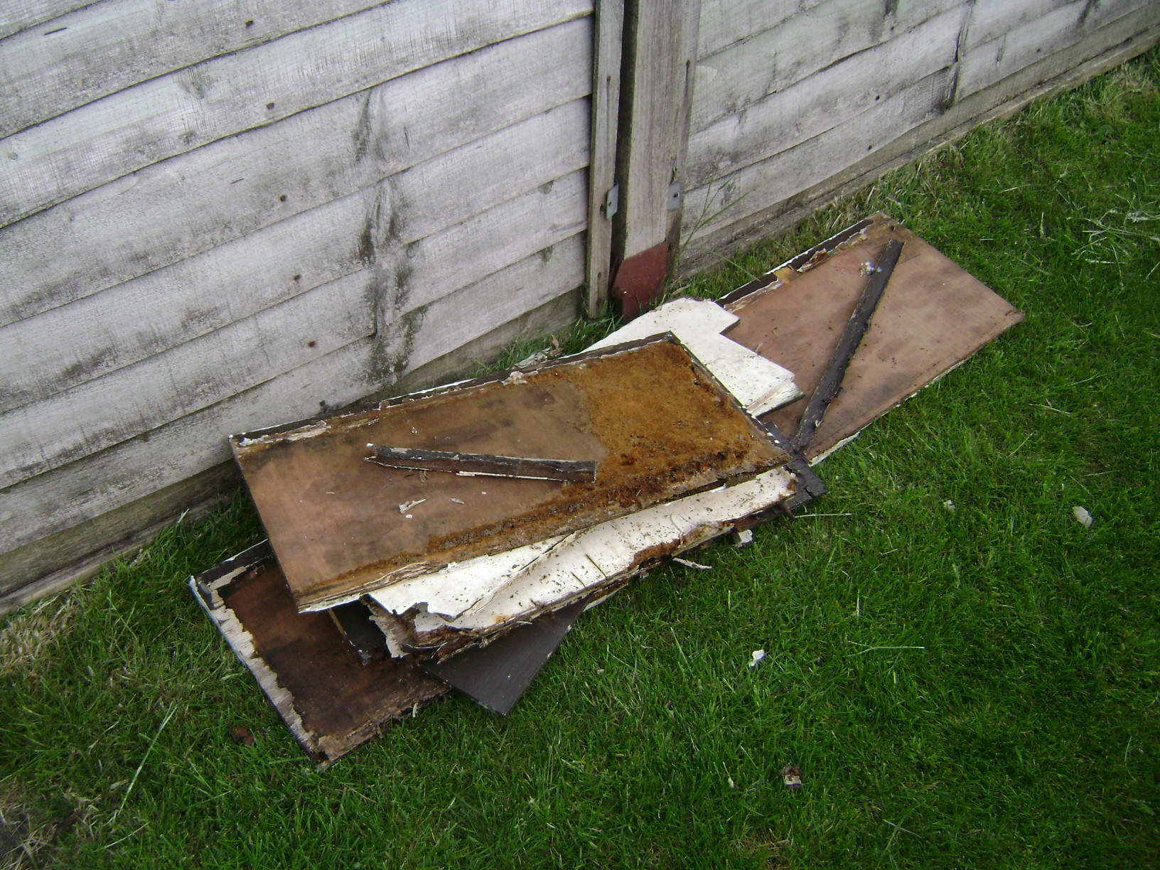

I had a lean-to shed on the back of my garage in which was stored an "instant train", in that it lived in the shed and was available for immediate use. I had been planning its replacement for a while, but last weekend one of our cats jumped on to its roof from an adjacent fence and part of it collapsed. Here it is today, on its way to the tip. The orange beard on the top sheet is some impressive fungal growth!
Nine years. And this was so-called weather-proof, boil-proof "it'll last for decades" marine ply, the best I could get, and it cost a small fortune to get the "quality" I was assured it had.
Its replacement will be made from Filcris plastic sheets, already in stock and delivered cut to size.
I broke my own Rule #1: Wood has absolutely no place in a garden railway.

I think it took me 15 years to reach that conclusion, learning the hard way :banghead:. Timber and plastic seem to be about the same price these days, and the wood sold in the UK is usually so awful it is a no brainer for me now.

Ply outside as you have found is certainly a no go no mater the so called quality or how well you protect it with even varnish or roofing felt. Your construction would have been ok with external grade gravel board covered with felt that can give very long life. My boards made with such have been outside near 3 decades now.
