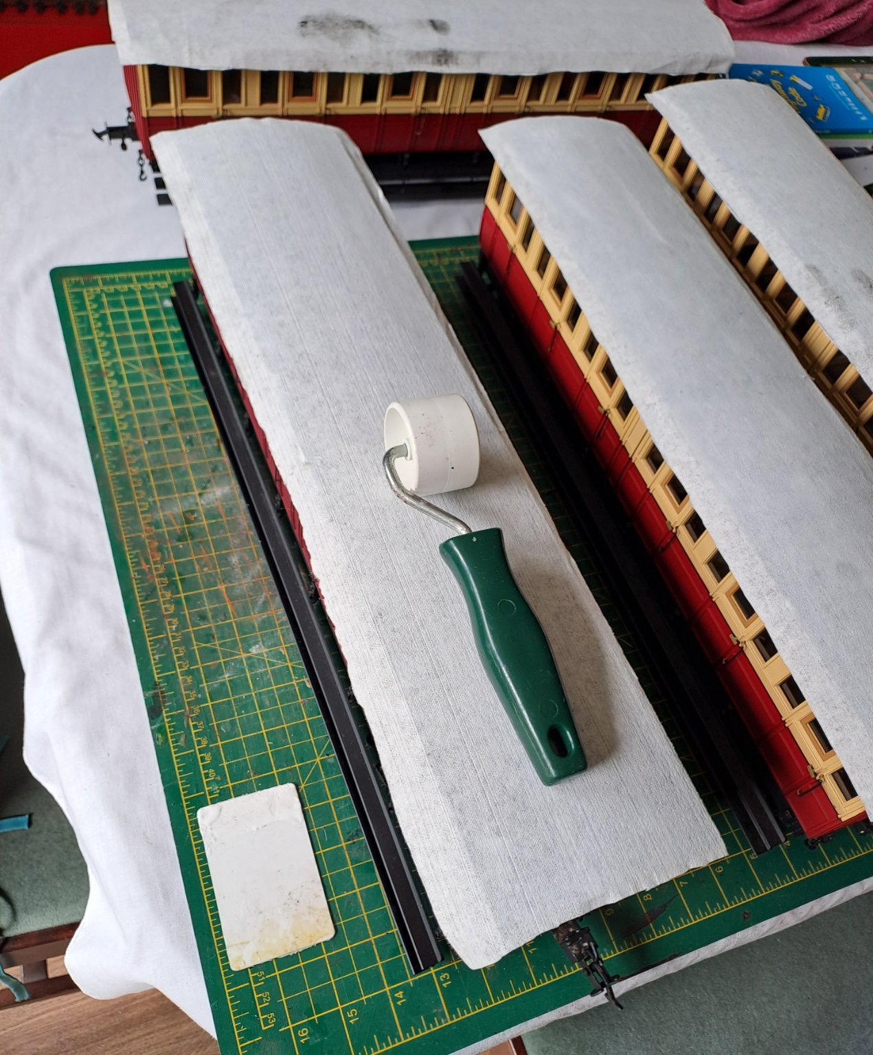

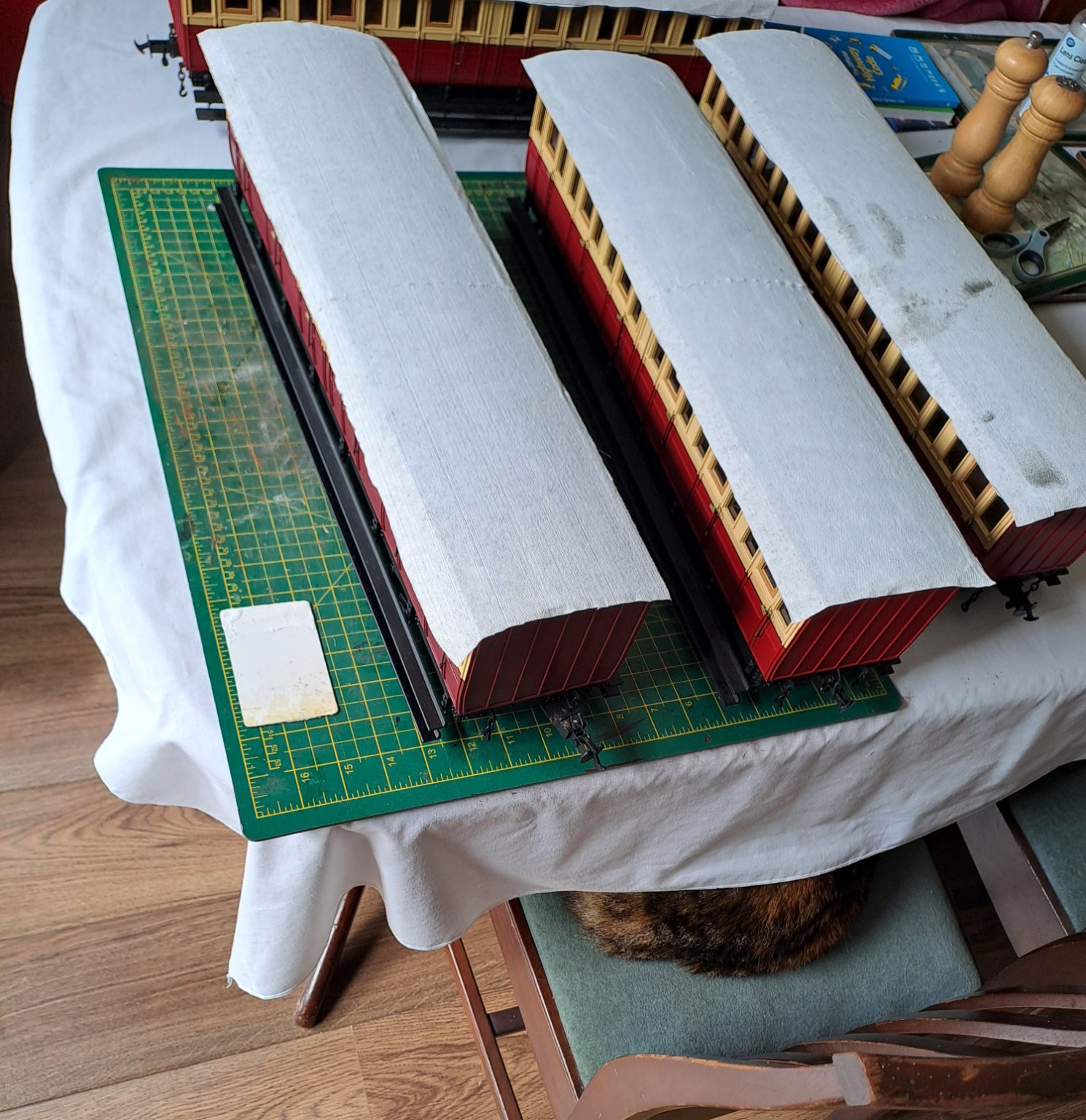

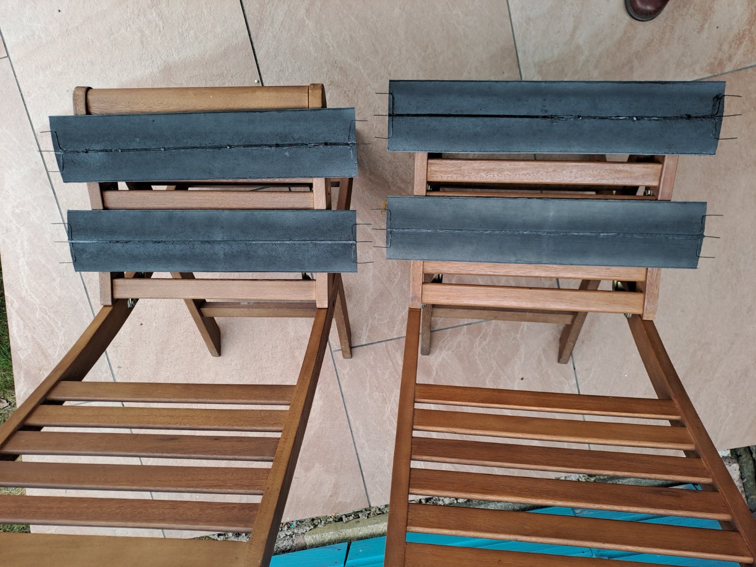

All this talk of roofing, P Paul M I thought I'd post it on here, Today's progress so far, material cut to size and guled on with pva.20250816_113839.jpgjust checking I've enough for the job,

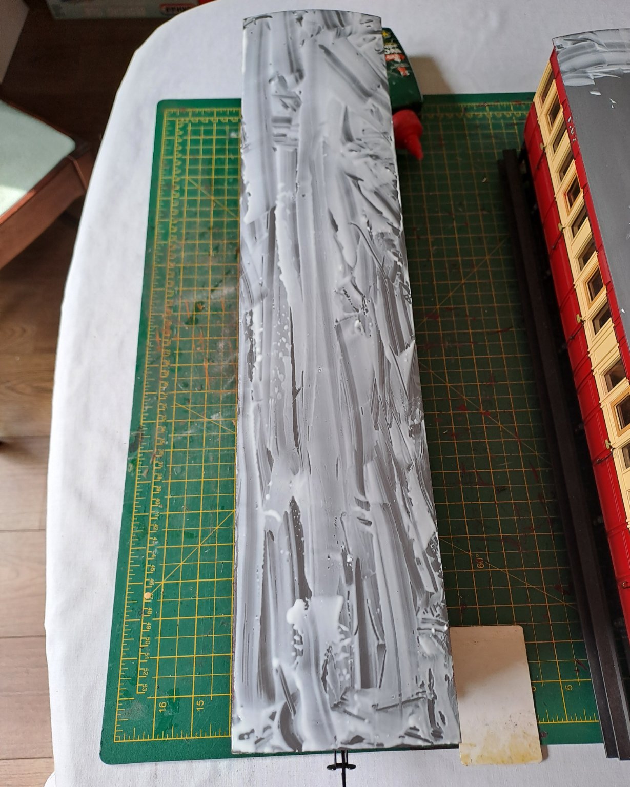

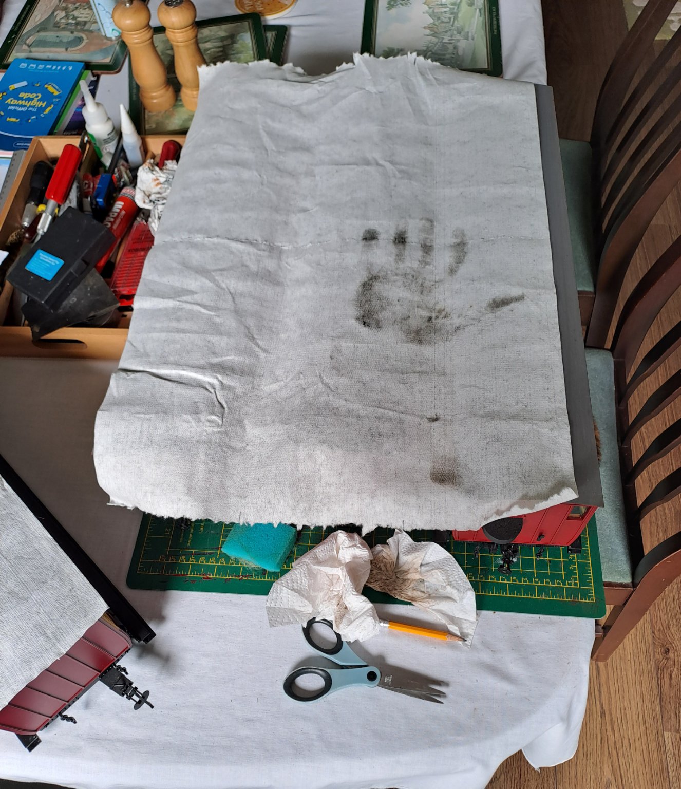

20250816_130632.jpg20250816_132013.jpg20250816_133913.jpg PVA spread on towel put on and rolled, especially the tear off perforationsand leave to dry

Another good option is an old duvet cover, the material is quite thin. Though best to use a plain one. Oh dear are we becoming a sewing site?

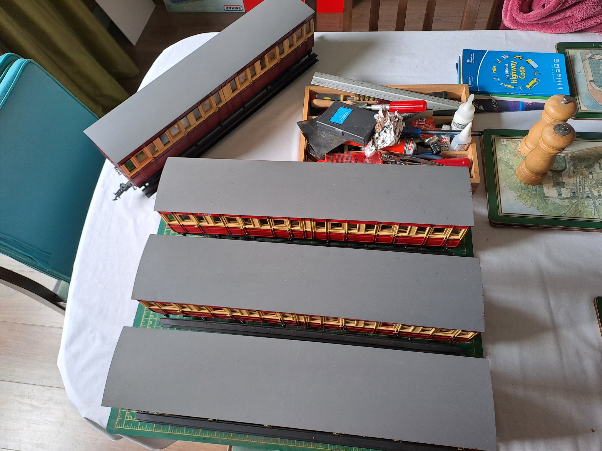

Decided to take the roofs off, easier said than done, 2 screws at the top of the blanking panels, but on the inside, just in reach of the screwdriver, will be fun tightning back up:worried:
Covering trimmed, and either conduit or just cables and junction boxes fitted. 2 also had guttering put on, the rest will have to wait until I get more plastistruct 1x1mm.

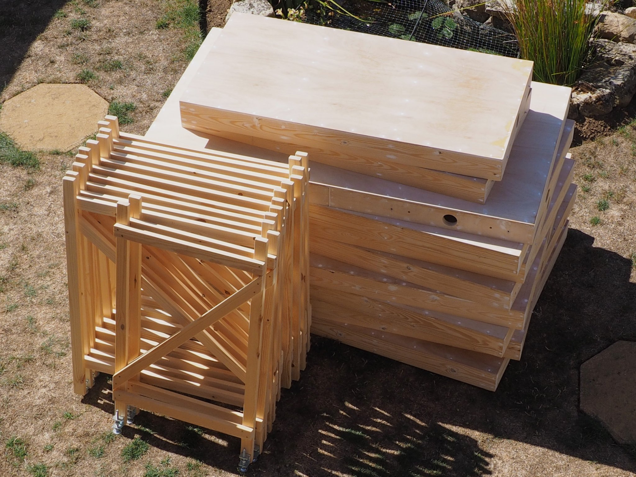

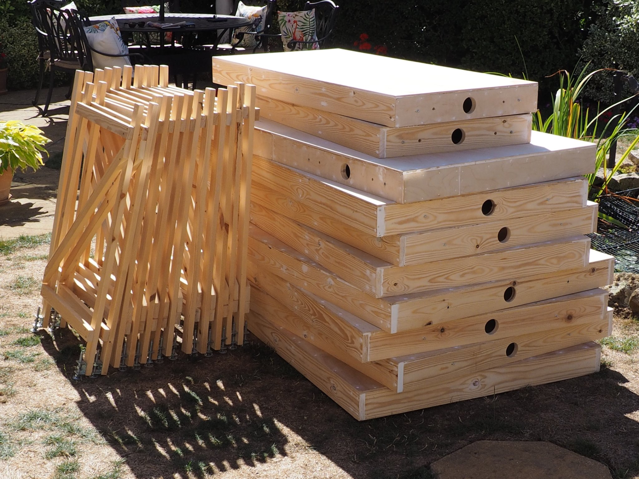

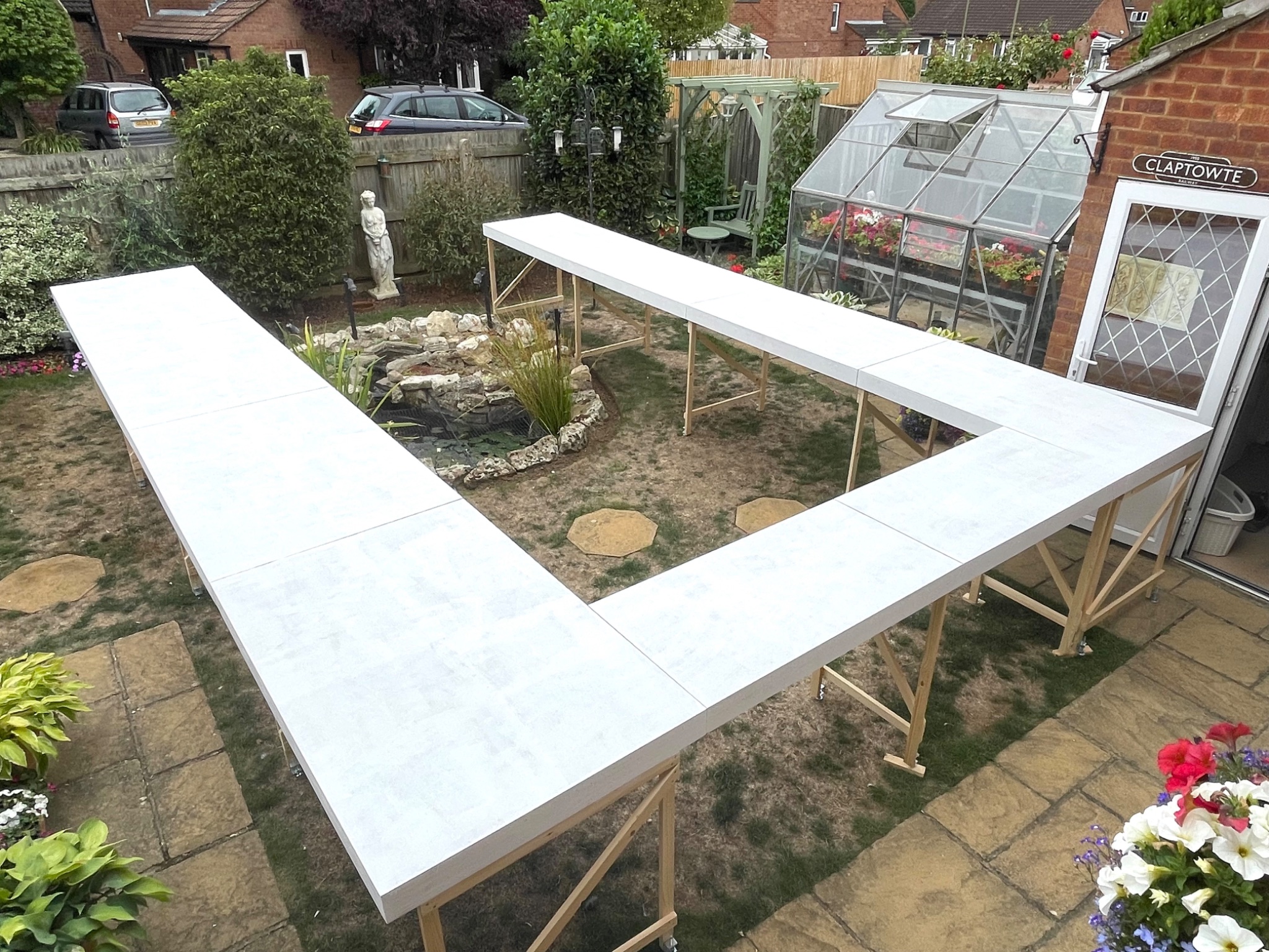

After 30 years of modelling in G Scale, I have finally built some baseboards, with a view to screwing down some track and bringing the Claptowte Railway to life. The baseboards are not finished yet. The first issue is that despite counting several time, I under ordered the number of metal alignment dowels required, these will be another week before arrival. Here is a couple of views of the boards and legs waiting to be put together.

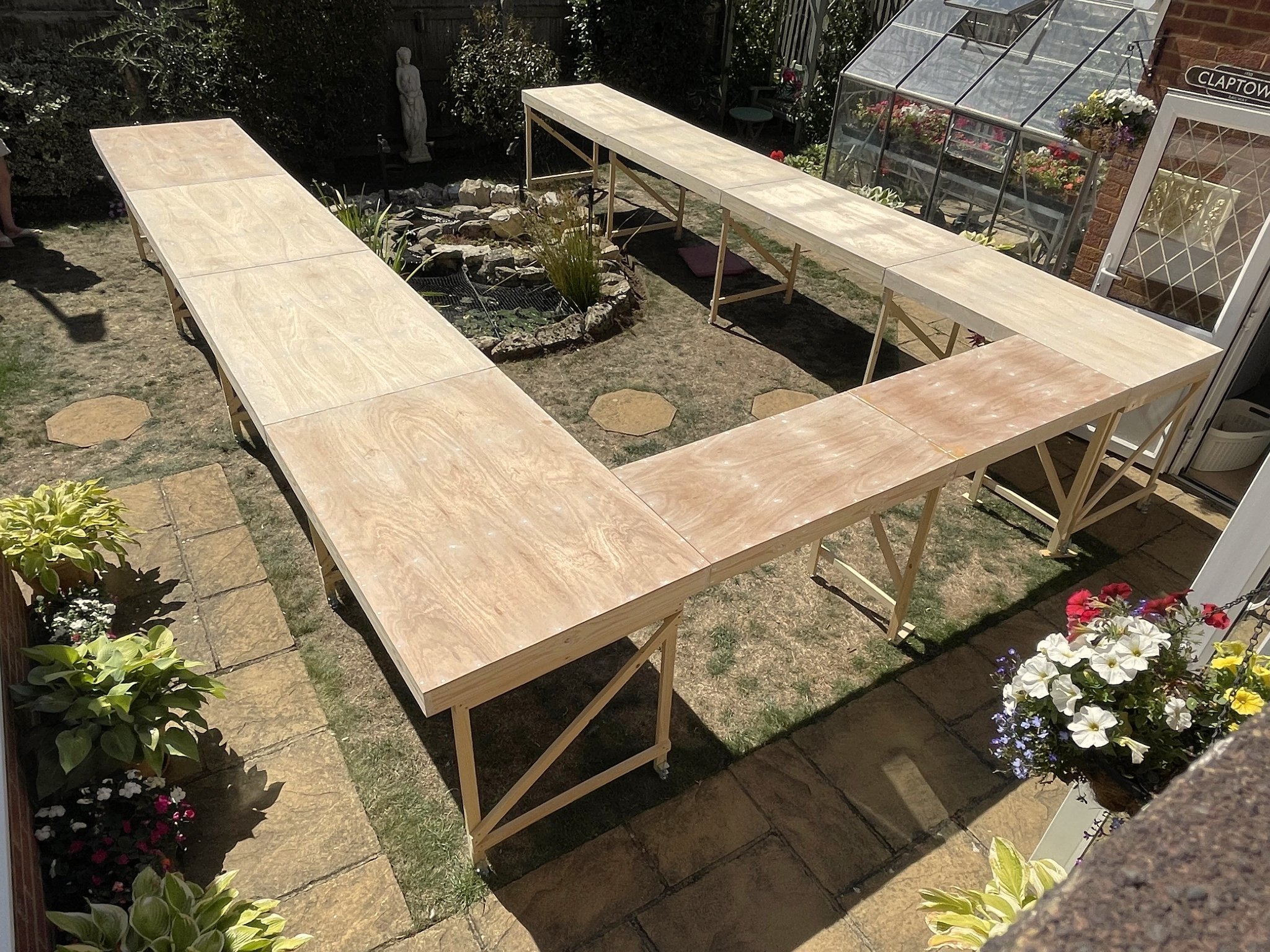

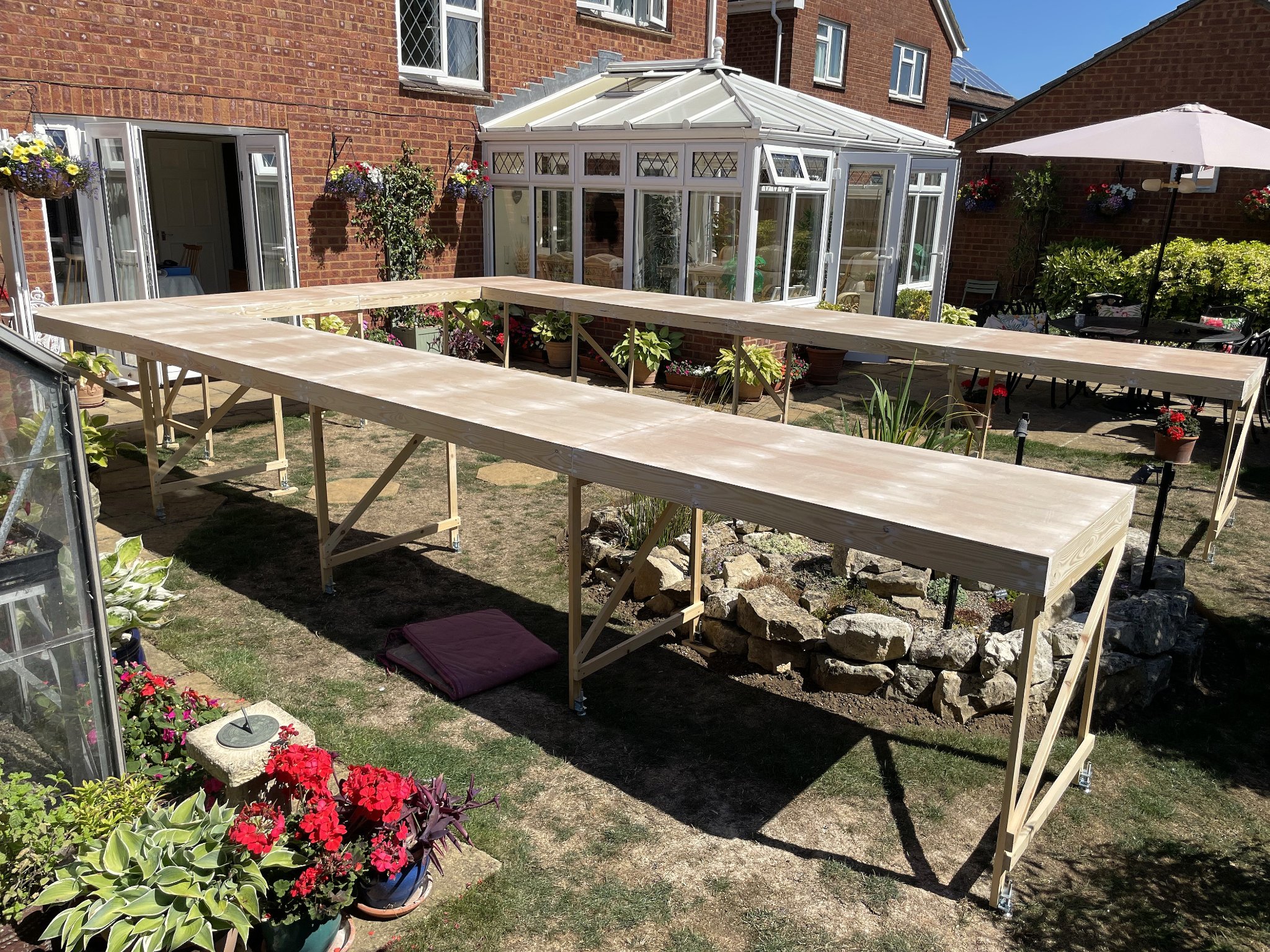

It is intended to align all of the boards using locating dowels, the majority of the boards will the be locked together with toggle latches, screwed to the sides of the boards, where these cannot be fitted, where the boards turn the corners, bolts, washers and wing nuts are used. The boards were jury rigged, using various clamps, for these photos, the side latches will not be fitted until the sides have been painted.

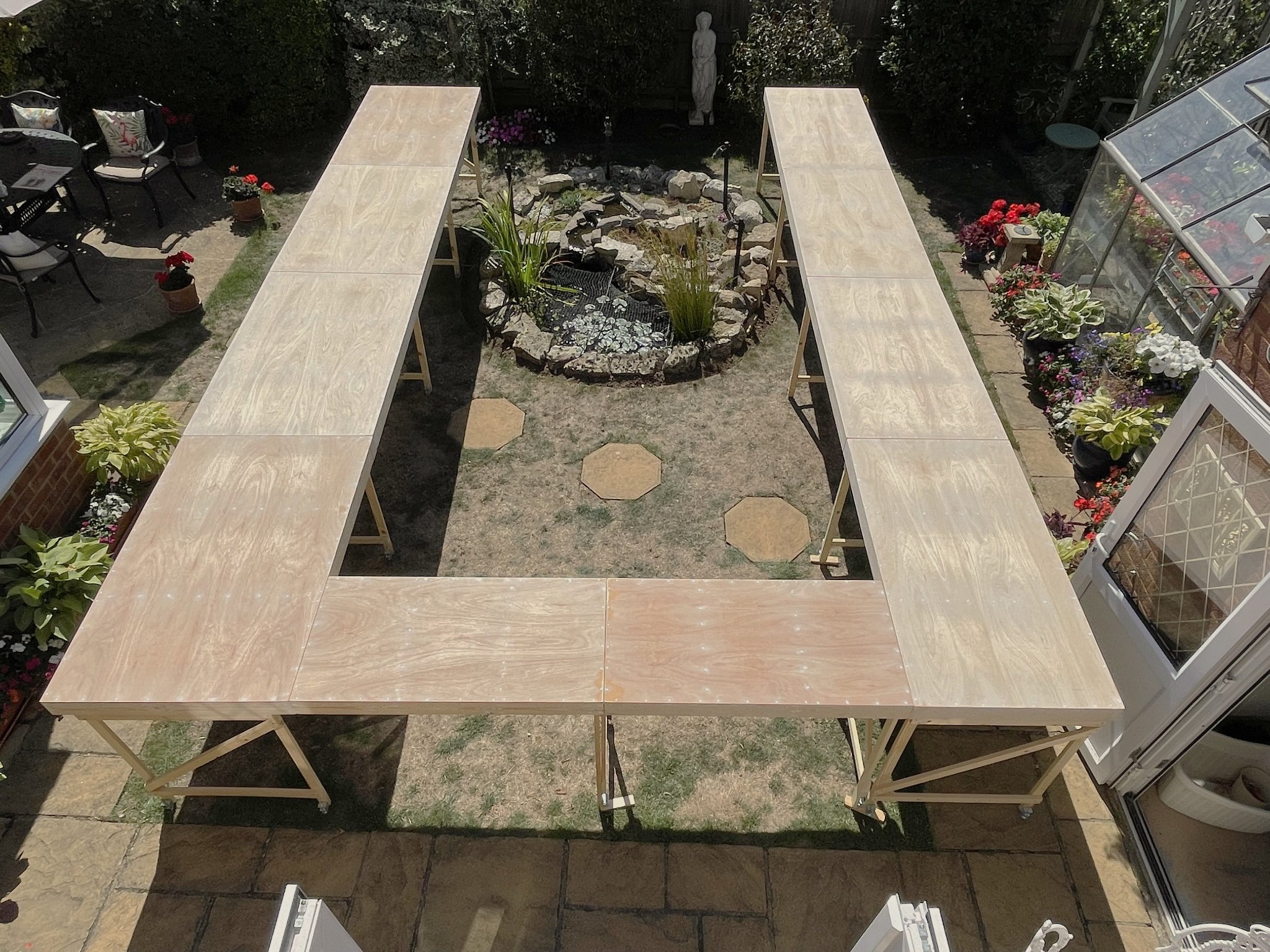

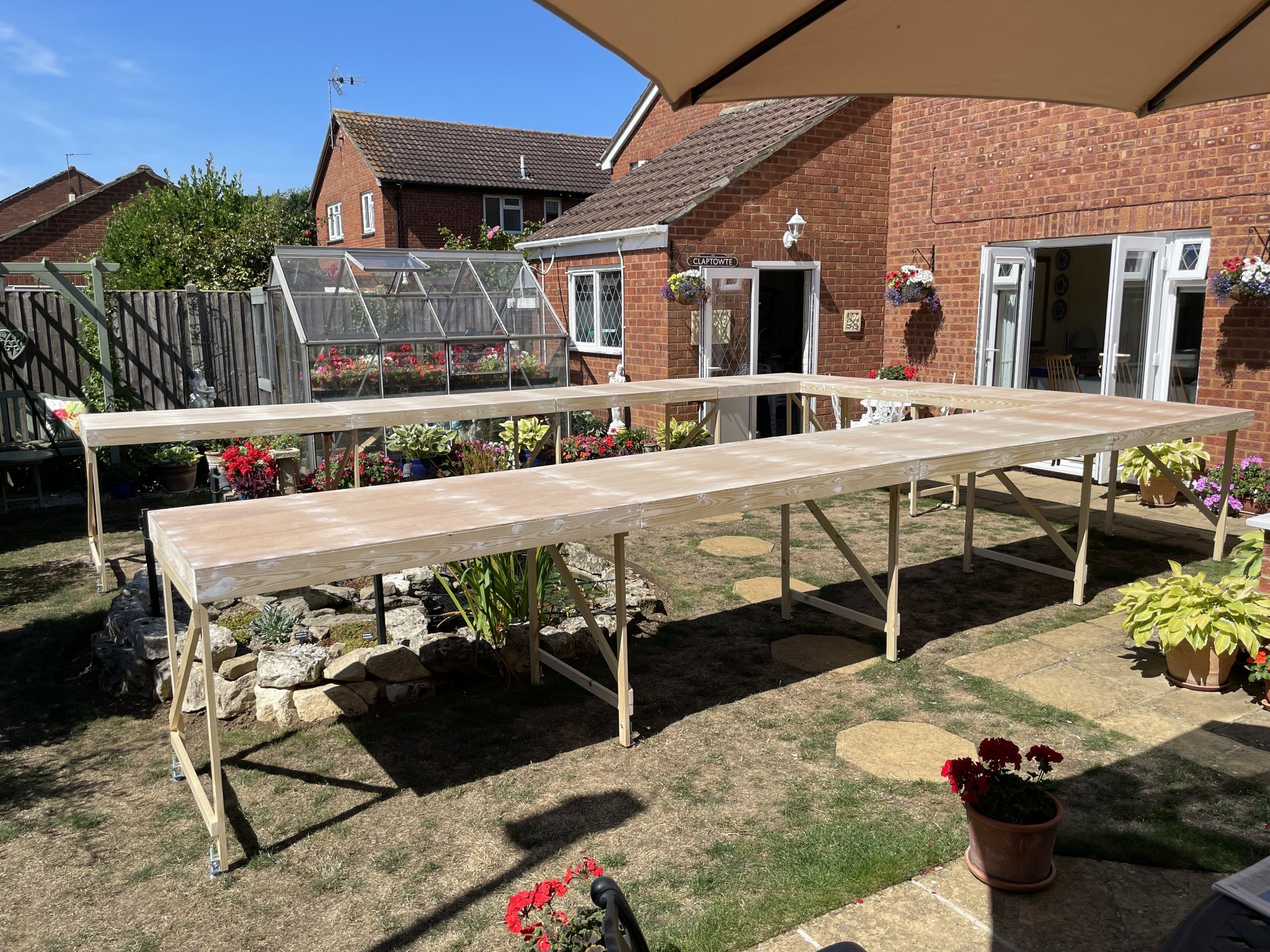

Having put the boards all together for the very first time, with the fine weather, I thought I would make a start painting them with a primer coat. I surprised myself by almost finishing them all, I was just left with the top surface of board number 10, before I ran out of paint. Off to the store, tomorrow.
Almost as if it was made to fit that space in the garden.
Do you have anywhere big enough to set up the whole thing under cover?

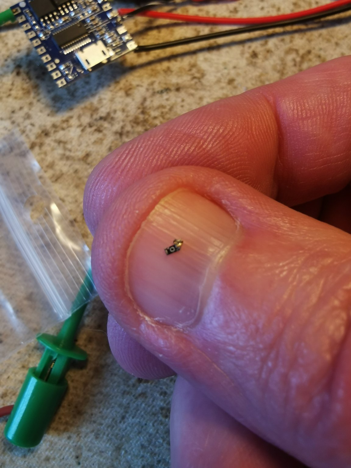

It doesn't get any easier, removing small surface mount components..
The tiny blob of solder on the end, is nearly as big as the component!
I had to give up a job as I couldn't see the 100 micron wires I was soldering.
I'm long sighted with astigmatism, so I can't focus close up, even with corrective eyewear.
My distance vision though is excellent....
