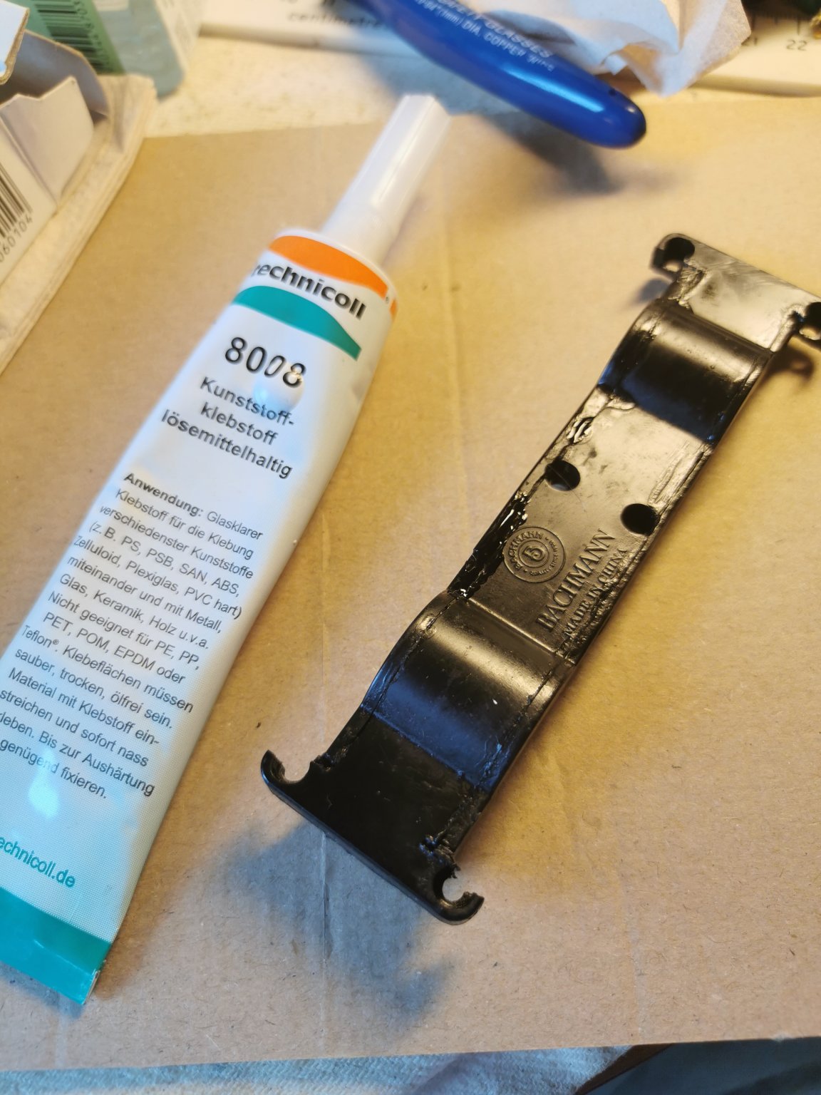

The only adhesive I recommend for LGB plastics..
Here being slowly built-up to fill the voids, where the cutting of the 'block had not been too accurate.
This will be given 24 hours, before I reassemble the unit.

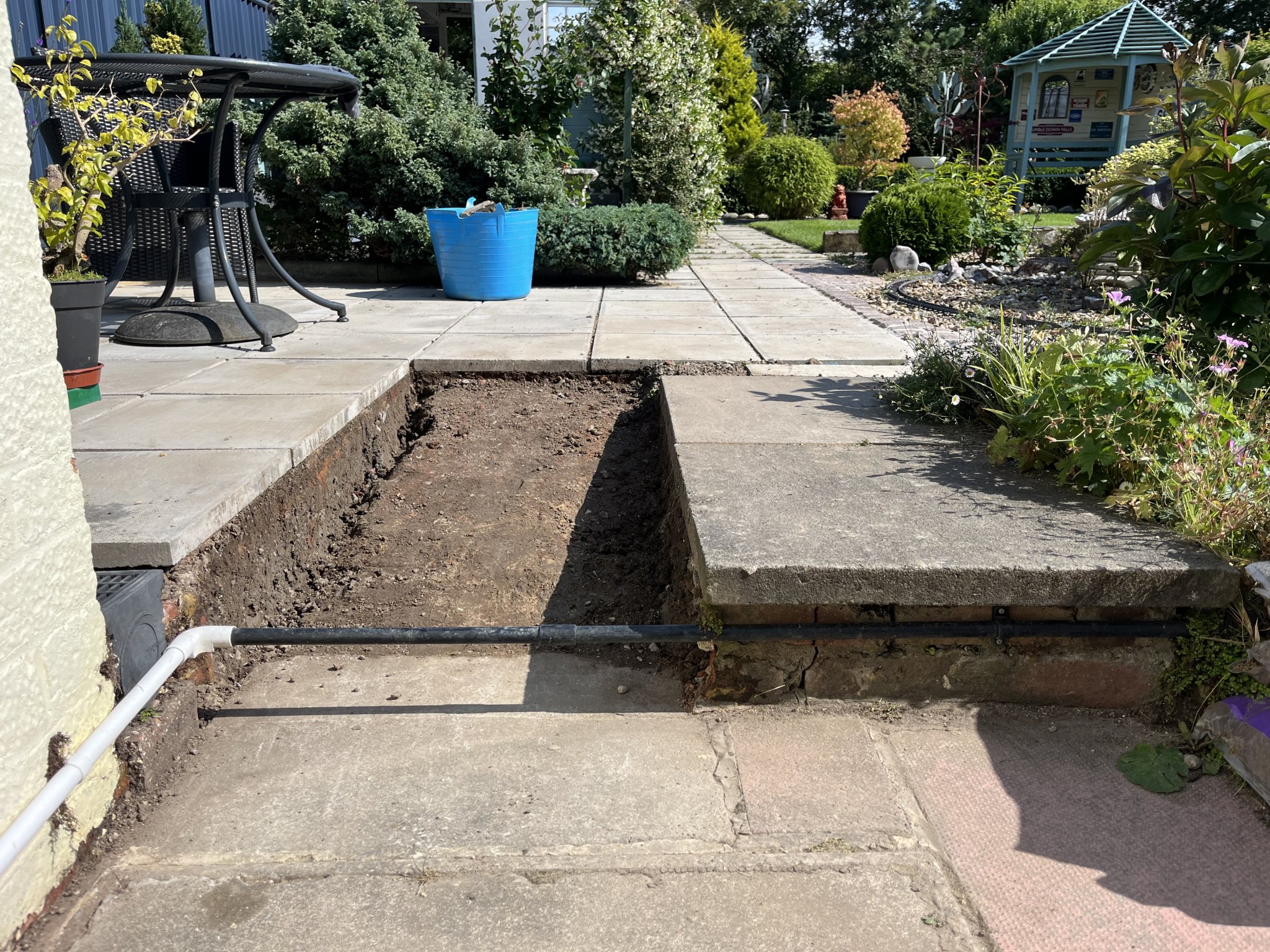

Started to get power back to my points. The mains transformer and controller are all in the garage, and before the ramp on the path, we had a step and the conduit ran under the step overhang. When the ramp was put in this was no longer practical, and lots of thought how to get power over the path. the solution is an arch to support the conduit.
The remain of the step, with the conduit:
The ramp, and no place for the conduit;

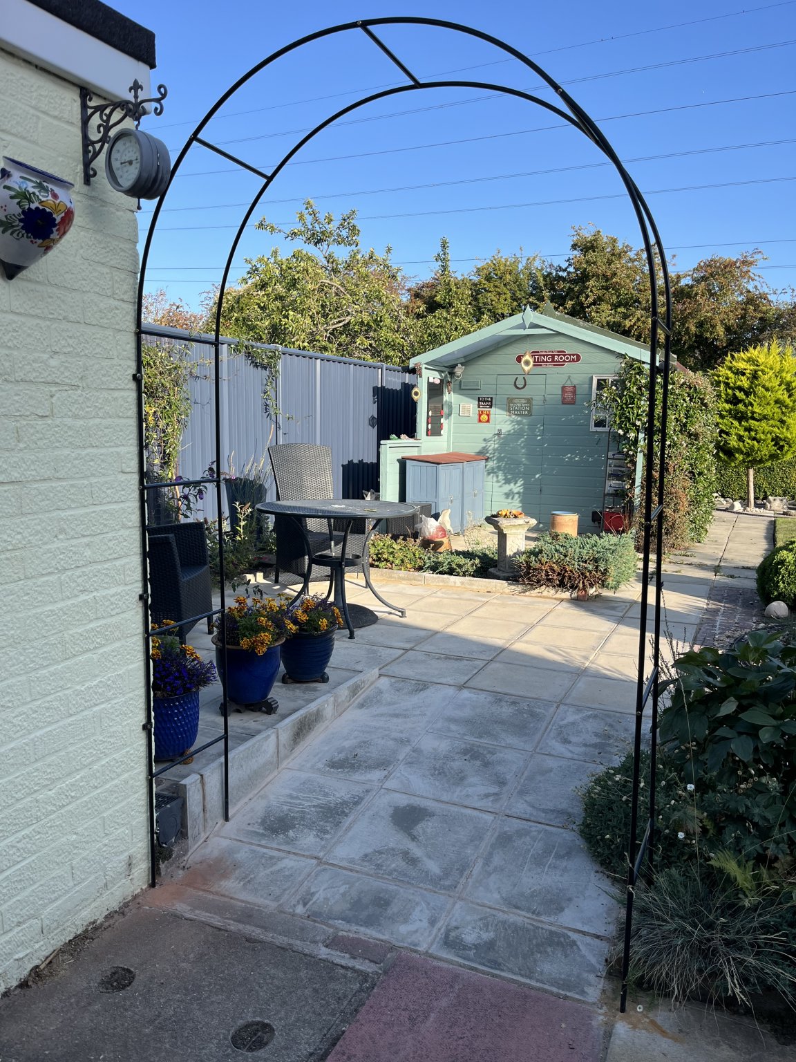

Three options:
1) No power to the points.
2) Run the power in a duct in the ground.
3) Run the power over the ramp (at height).
Option 3 and an arch;
