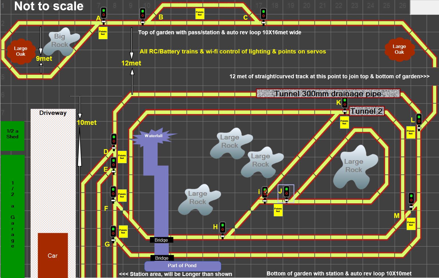

Suggestions or comments before i start this venture?

Now got most of the track & buildings, but open to any suggestions on design. Trains will all be RC/ battery. The points will be on servos & lighting via relays all via wi-fi. Thanks.

How would a typical single service operate on this track layout? It's hard to visualise what the service patterns would be and how many trains run at once just from looking at the diagram.

Something coming off the branch line has no where to go. If the crossover H to K was the opposite way around the train could reverse.

My thoughts are that a train leaving the Station area has no way to reverce to get back short of stopping then a run-round of the loco to get to the other end of the train. Layout and size of garden always likely to be a restricting factor but could one of the reverse loops be revised?

Looks like your drawing was done using Hornby Railmaster! Just FYI I have in the past run my (indoor DCC) G scale layout with Railmaster. The 4 amp limit doesn't affect me.

As mentioned earlier, it is hard to understand what your modus operandi is, there seems to be some tail chasing, but also end to end, a brief explanation may assist us in giving advice.

How long is Tunnel 1? Don't make it too long, not longer than 2 arms lengths, because you'll have trouble retrieving any train that breaks down in there....

Also your track from K to H in the middle of your plan; I would mirror that arrangement with RH points, so that any trains from the terminus and the line at the top of your plan from point L can be reversed....

It's probably already said but once you return from the large oak loop you are then stuck going around the circle.
If you lead back into the circle the other way it would probably work OK.
You could change the diagonal within the circle the other way to achieve a similar result so you can go out and back without getting trapped. :nod:

Collectors,
What software are you using there?
LegoCad? :D
AnyRail is a good free model rail design software. If you substitute flex track for the set track curves once laid out, a fairly large layout can be designed with the free version.

Collectors,
The trains are all RC battery & the Wi-Fi switching is ewelink & works fine in my house & have just put another router in the garage for the railway for a good signal around the garden. All of the switching on ewelink units can be pulse or on/off which is great for points or lighting.
