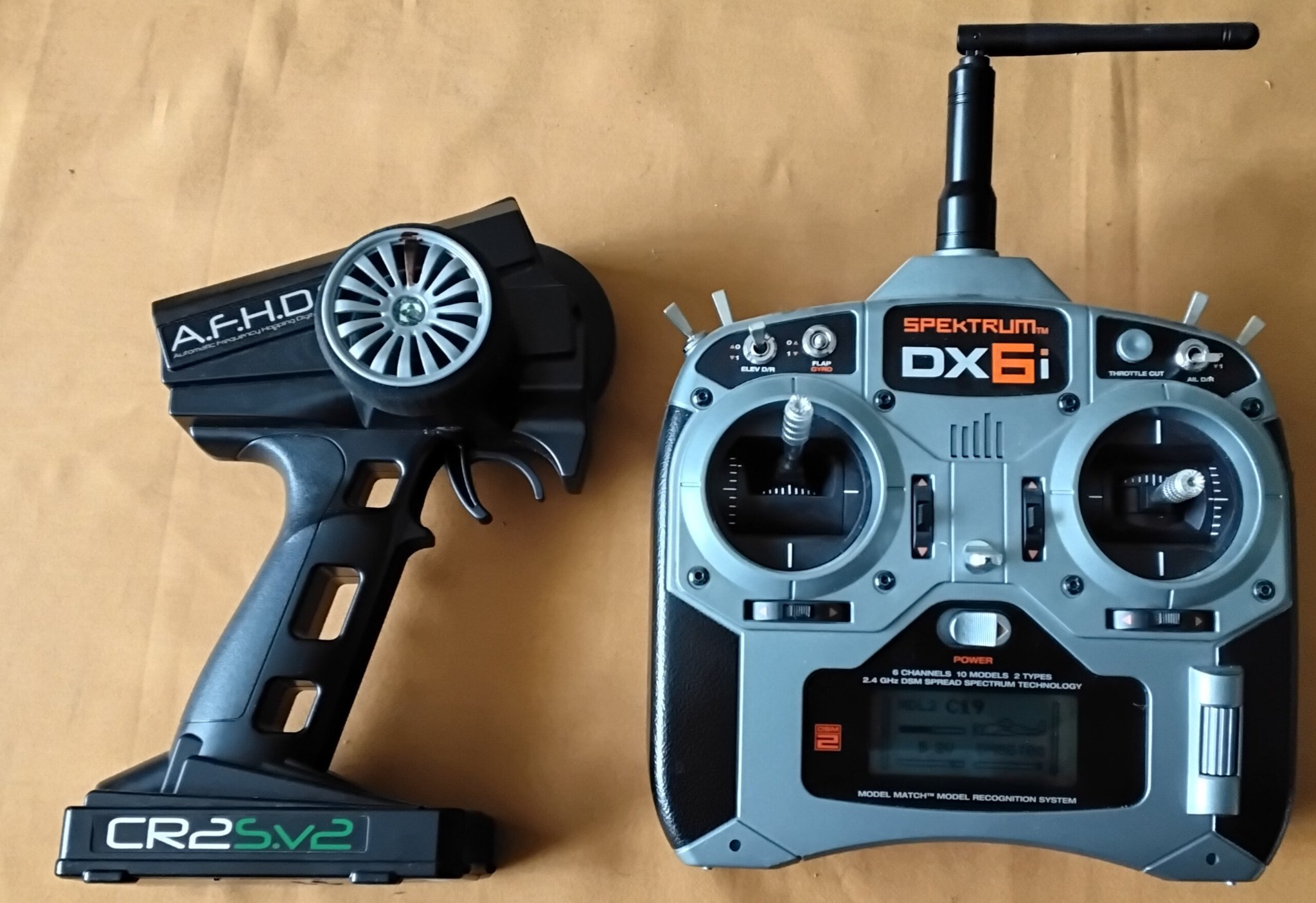

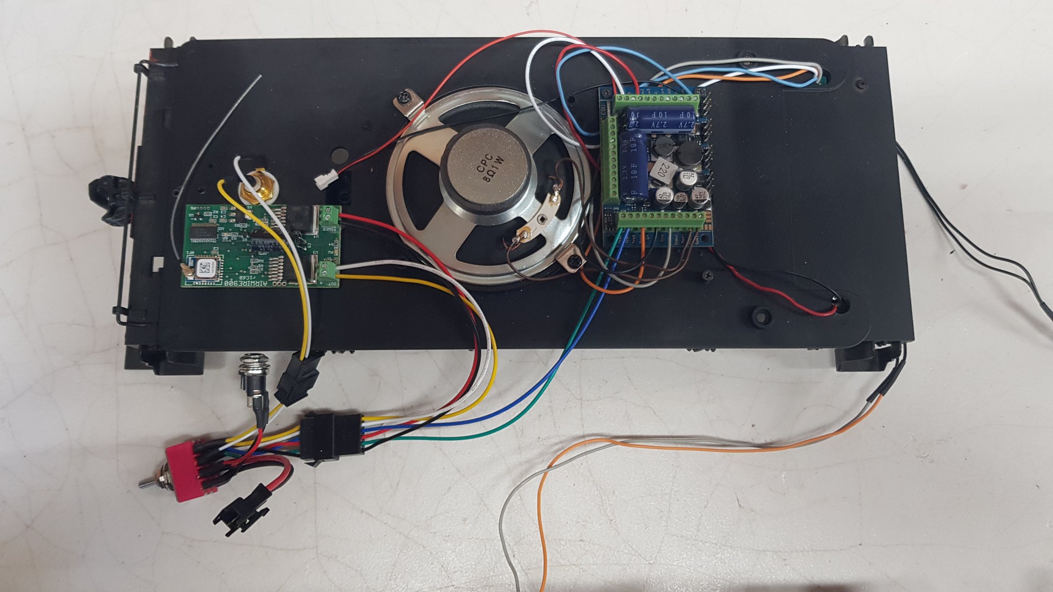

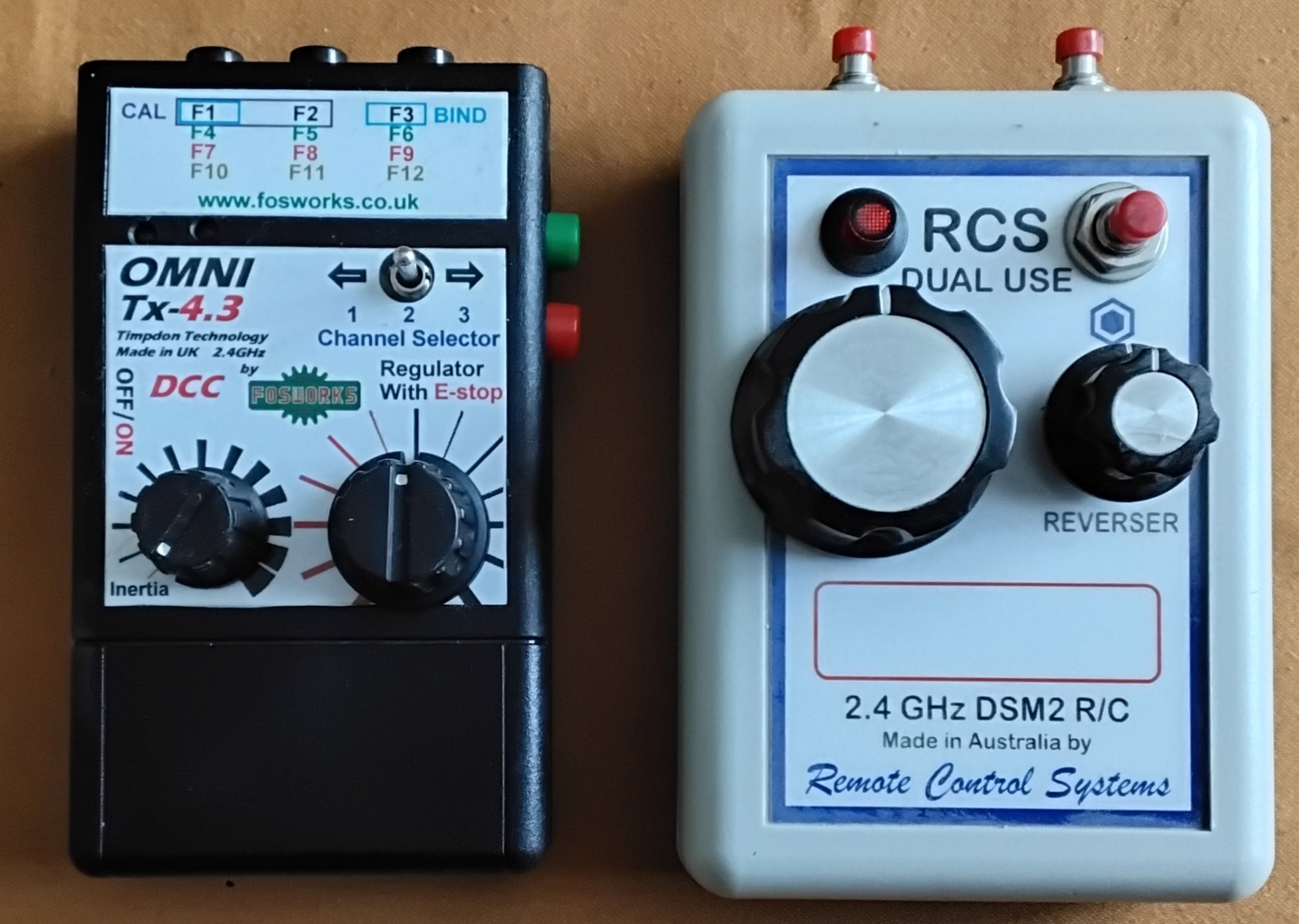

I have one or two live steam locos (and one battery) that are all controlled by those cumbersome and over spec'ed "twin stick" model aircraft style transmitters (TX). My recent program of converting my electric track powered locos to Battery/RC/Sound operation has taught me that there are much more compact and handy forms of TX control out there. I have so far used Fosworks, RCS (not longer available) and now RC Trains products to operate my converted electric locos' functions. All the makes use TX's of the compact hand held type with only the minimal function controls needed. Some will even allow multiple locos to be bound to and individually controlled from one TX.
Question - If possible how do I go about employing a similar style of simple compact hand held TX with my existing live steam roster. I only want just one (or 2) TX and not to have to stand the cost of replacing all the RX gubbins and servos on the locos ? I.E. What one might describe as a "bind & play" to existing installed RX's solution.
Current live steam "twin stick" TX retinue to replace - Spectrum DX6i, Planet T5, E Sky (Roundhouse supplied), Futuba T6EX, Saturn XR4 & Exminster EX7. I have "binding plugs" where supplied.
I also have 3 battery locos that were supplied with those infernal ABSIMA (Abysma
) CR2S.V2 RC car thumbwheel type TX's. I would love to ditch these for a similar hand held TX solution. They just need proportional Forward/Reverse & Sound on/off
Your thoughts and advice please
Max
If there is any doubt, my nemesis below !

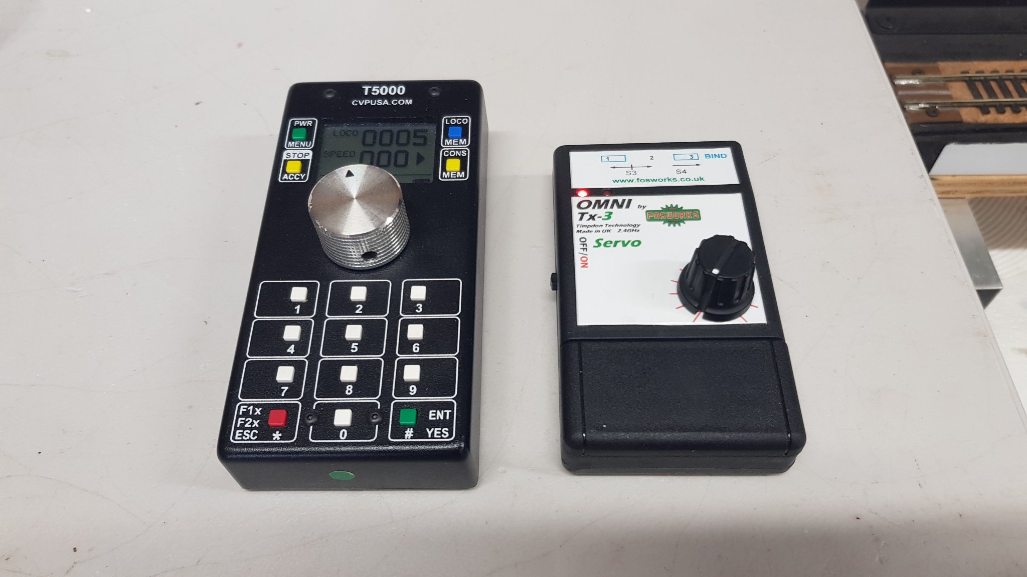

The sort of thing I am aiming for
