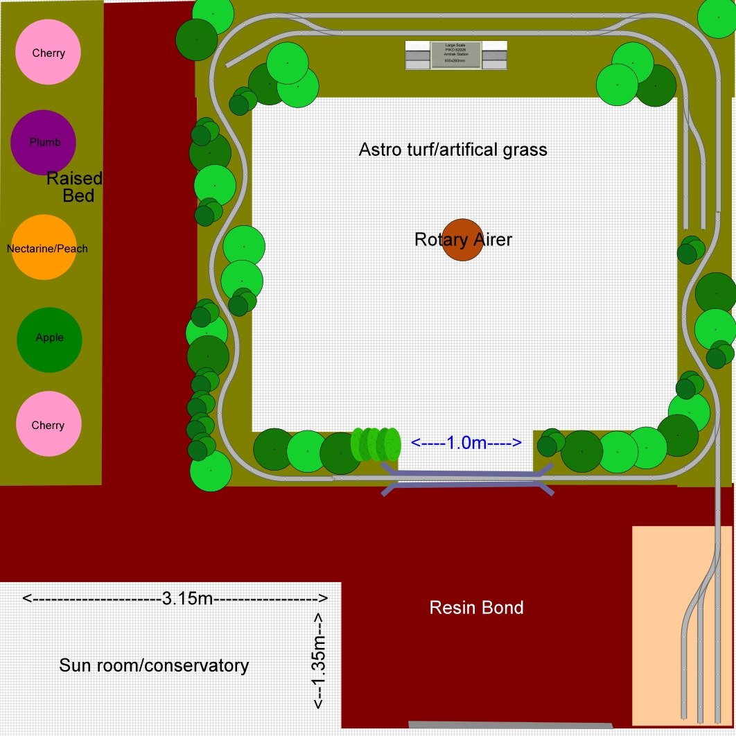

This is the plan of my back garden and Blassen-Hugel Gartenbahn a freelance European meter gauge narrow gauge railway using LGB equipment currently track powered locos 7 in number, but I have stared converting to RC battery power, I may consider live steam eventually.

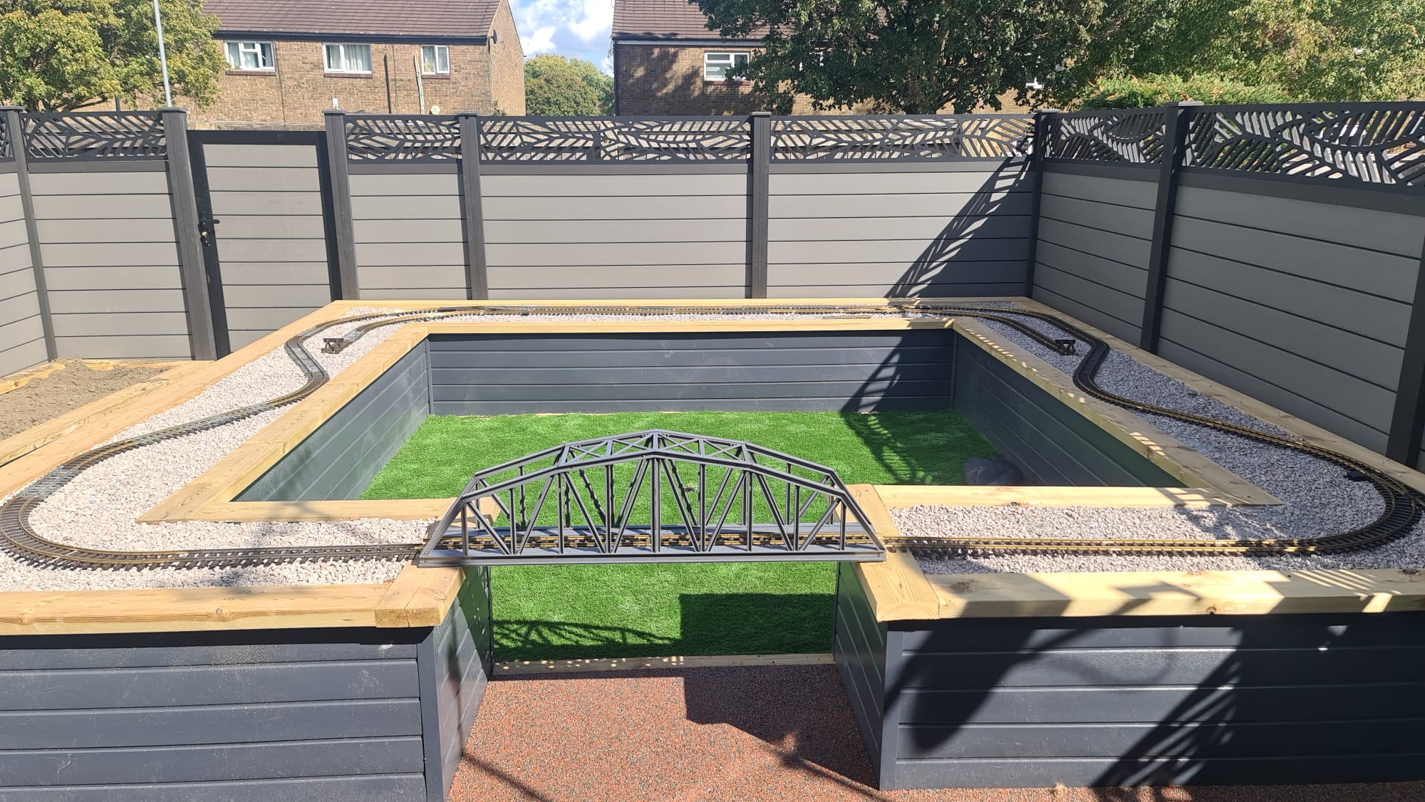

This was the pre rainstorm build.
Welcome DianeTape DianeTape , that is a very nice neat looking setup you are building.
I am also building a raised bed railway, running battery R/C trains.
I waited a few months after filling (our winter wet season) before laying track and roadbed, after a few hiccups things seem pretty stable now.
I used a mix of broken up concrete, bricks, soil, sand and leftover roadbase as fill. Mostly broken up concrete and sub soil.
You can speed up the settling in by watering the beds with a hose (if its not raining much) and then just top up the gravel on top as it sinks in.
Good luck and I look forward to seeing how your line develops.
