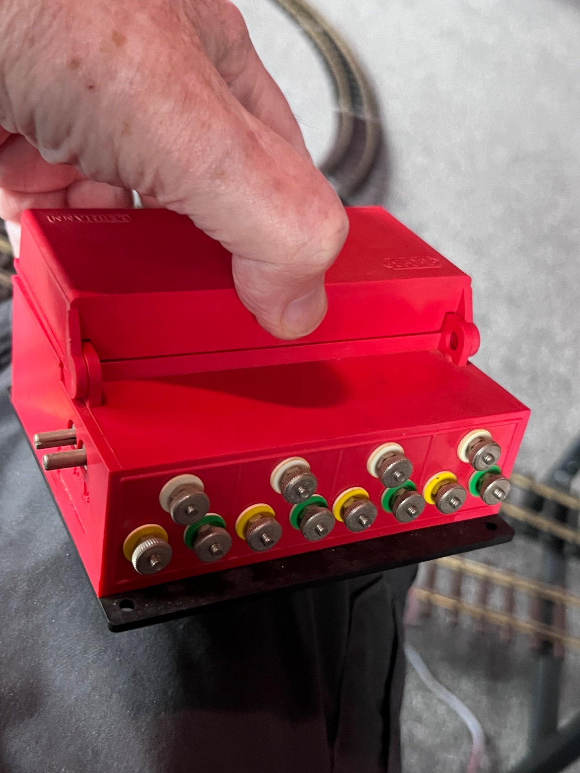

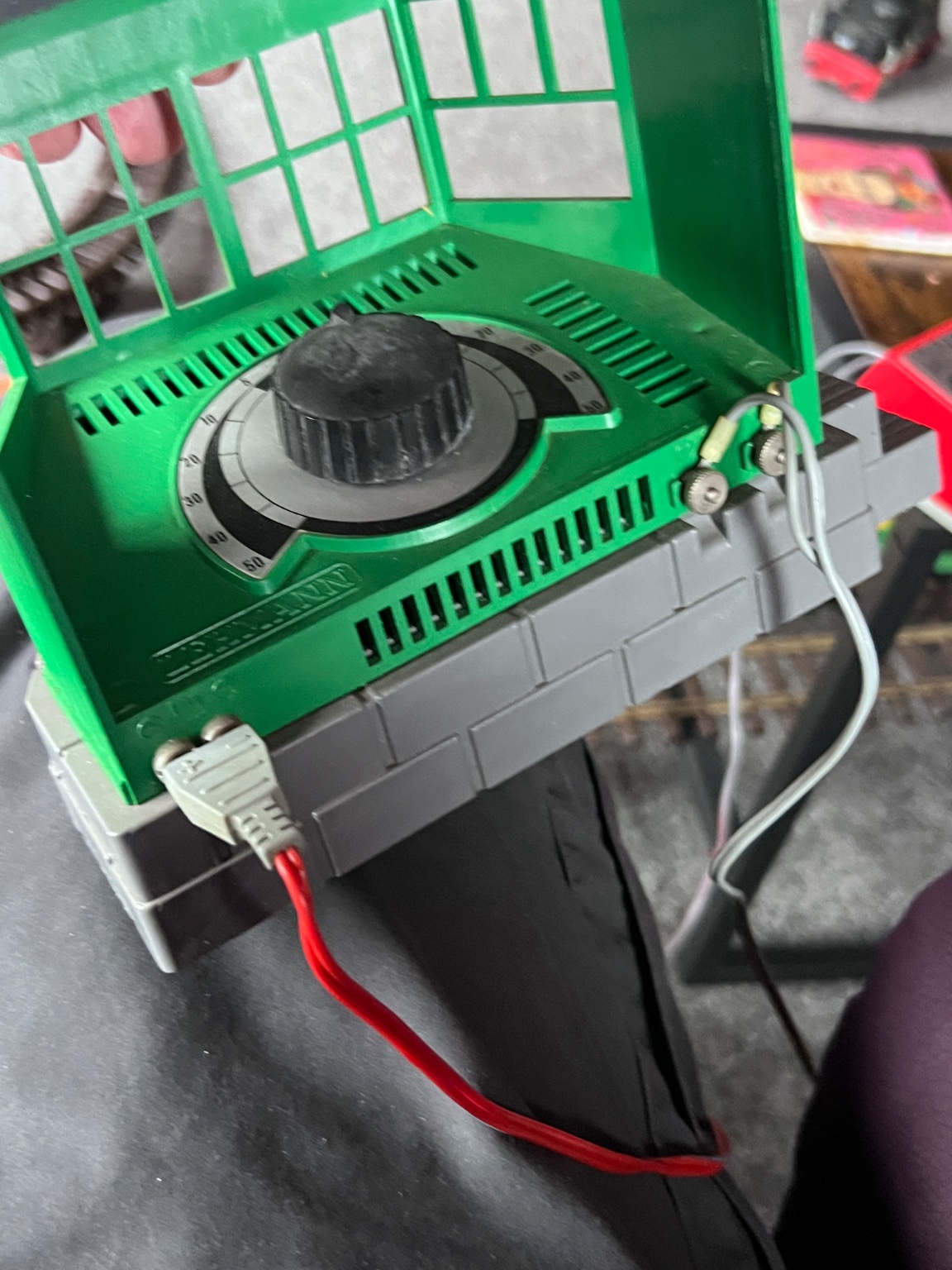

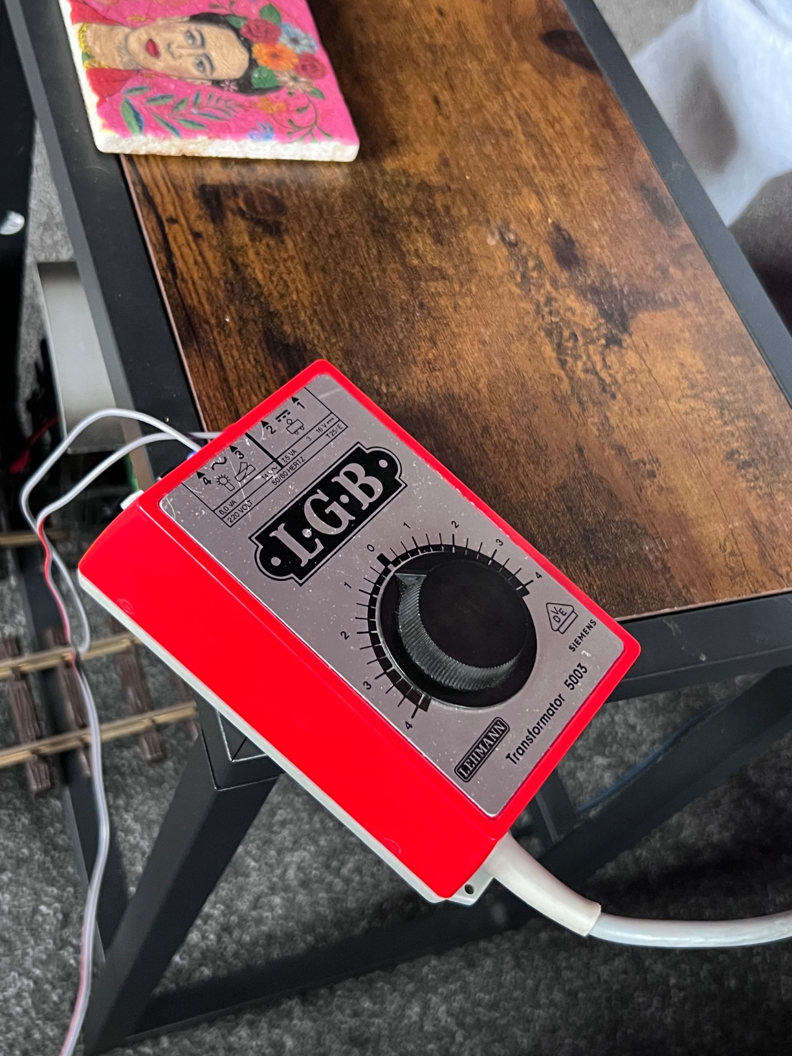

Should have added that I think I understand the points switching now - two cables into the red switch box then three to each point. However, I’m less sure how I used/why I needed the green controller as well as red transformer. Could they be coded to different trains in the 1980’s?
As your system is quite old, the only way you can run both your locos at the same time, is to have a controller for each. You will also need a separate circuit of track, isolated from the other circuit....

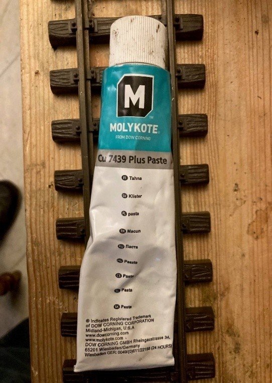

Please use this tip: use "copper grease" when you build up your tracks.
It can take over 300 degrees celcius and will not be washed away by any rain.
It will keep your track for years to come clear from electrical interruptions due to bad connections !

That’s interesting thanks. I’ve seen it advertised for high temperature lubrication but had not realised it is also good for electrical connections. Do you spread on top of cleaned tracks or concentrate it on track joints?

It is not electrically conductive as a product. It helps seal cleaned joints from water and dirt between rail surface and track clamps. So clean all surfaces to be mated to be effective. Do not use on rail head. Max
Do not spread it on top of the rails, you will get traction problems!
The working of the copper grease is only the prohibiting of wheathering the contact surfaces in a railway joint.
This will result in a everlasting perfectly continuous good electric contact between the two to be connected surfaces.
Even when the rails is moving , because of walking over it or because of temperature changes between day and night, the grease will prevent corrosion of the rail contacts. I am running it for about 8 years now without any connection problem!
In fact using this grease, everywhere you can think of it being contact improving,is a must and prohibits the need to change from rail power to battery power.
Also the use of thick wires next to the railway connected to all separate rails sections is no longer needed!
SO GO FOR IT AND YOUR RAILWAY WILL IMPROVE SIGNIFICANTLY!

As mentioned, your locos do not have independent control.
You can run both on the same track. They may or may not run at the same speed. or, as mentioned, set up a separate loop, eg, an inner and outer loop, connected by points. Or something rather more clever….

Just taken a look at your pictures. Your tube of Molykote CU 6349 performs the same function as "Coppergrease". As noted by another your 2070 loco is of an older design, the PDF I posted will not be of much use, sorry for any misinformation contained. However its exterior condition appears to be very good. I never knew all the motions on the 2070 loco were once metal. On my version they are plastic. Max

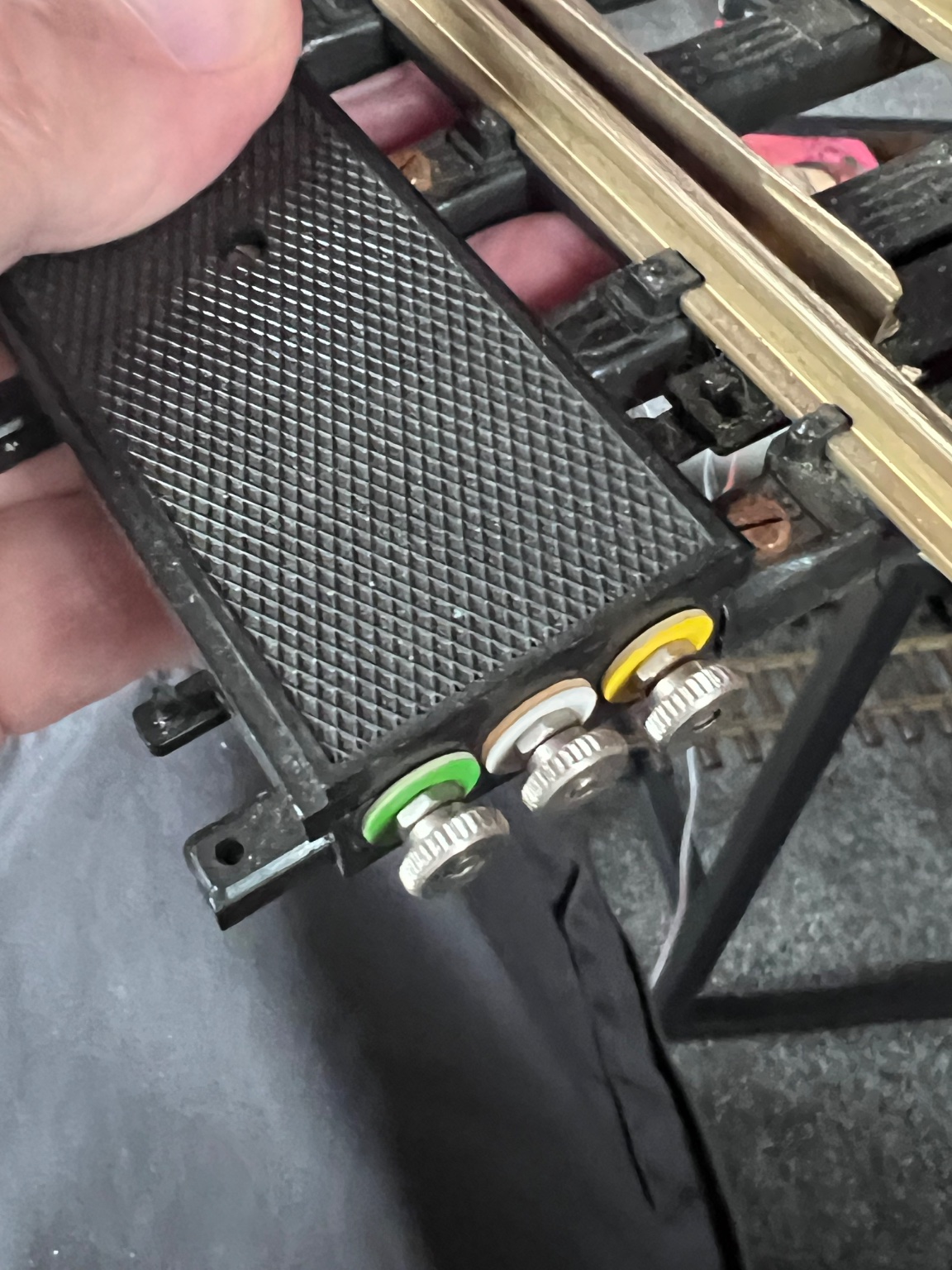

yes. but there is the question, if the two cables to the red switch box need to be AC (black and white from the trafo), or DC (red and blue). i forgot that, because i am using the (newer) EPL-system switches. (i think, AC, but i am not sure)
i hope, somebody of the other old men can answer the AC or DC question
(for future expansions: if you want additional switches, go with epl system. LGB provided a 'how to' for integrating the old switchmotors into the epl system)
the green controller needs a transformer from household to 18V DC (the idea was to not have to lead household voltage into the garden) you could connect the green controller to the red and blue contacts of the trafo (dialing the trafo to full speed) and regulating trainspeed with the green controller.
or, if you buy a transformer for the green controller, have two separated track sections.

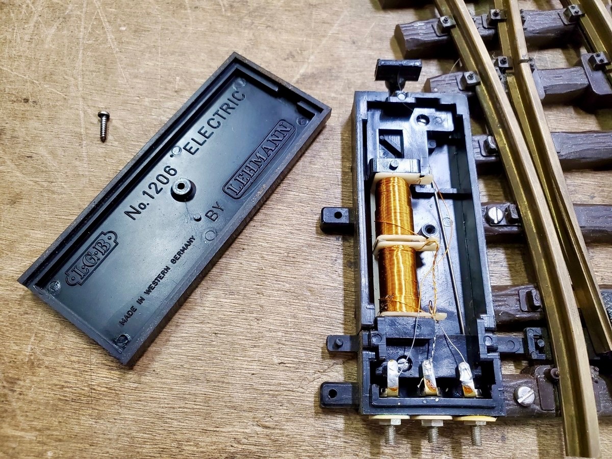

The older LGB solenoid point motors, with a three wire connection, will work with momentary DC or AC current.

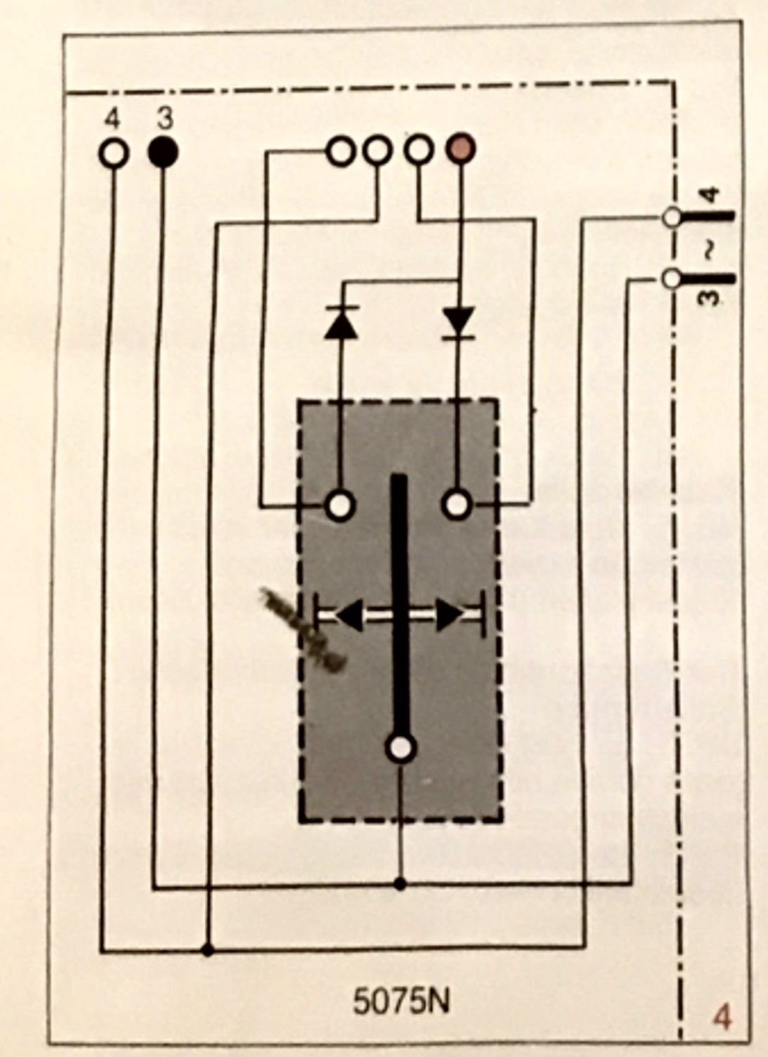

if these old switchboxes had diodes inside?

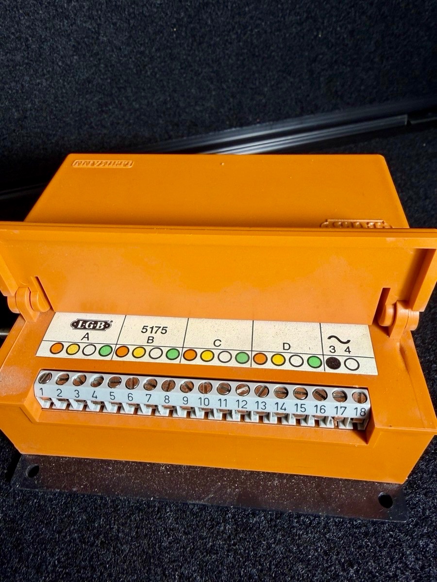

The old red 5075 switch boxers don't and neither do the early orange 5075s. Later 5075N/5175 switch boxes have the diodes and also a connection for a solenoid point motor (that is there are 4 connection points per electrical switch). Which terminals you use depends on whether a solenoid or EPL point motor is being deployed.
I've never been familiar with these LGB switch motors. I wonder how they compare to the newer design, as far as reliability in the outdoor setting ?
The big knurled knob connections can be more robust than the later screw terminal blocks..
But other than that, pretty similar, in my experience..
