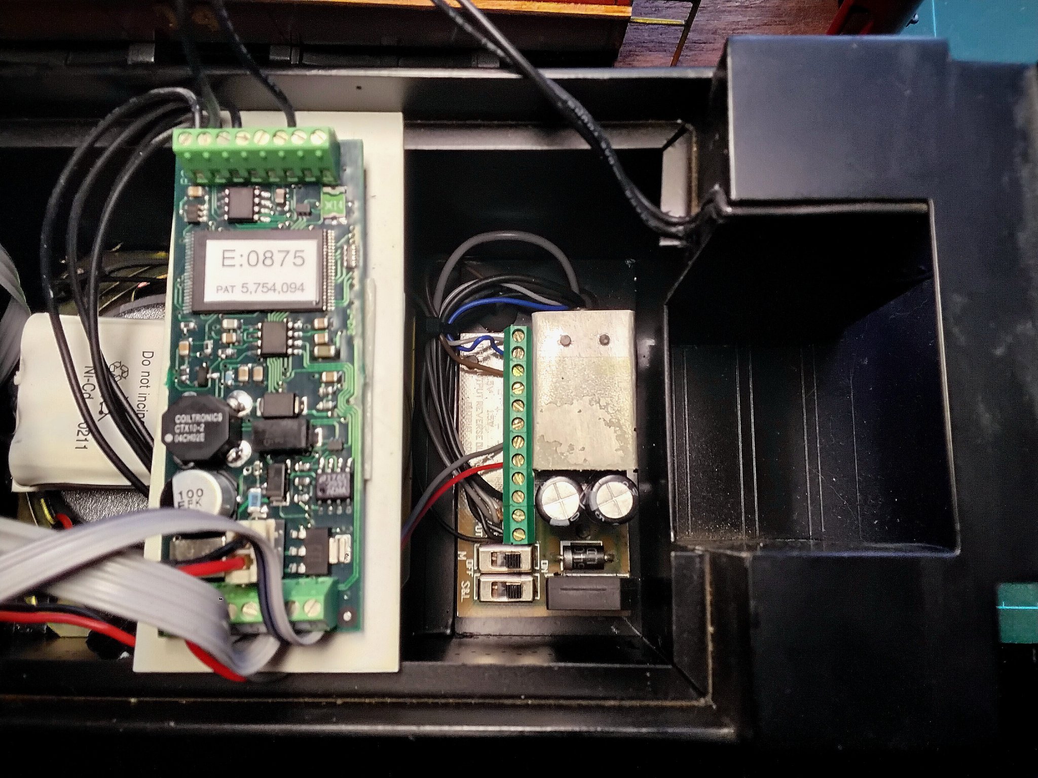

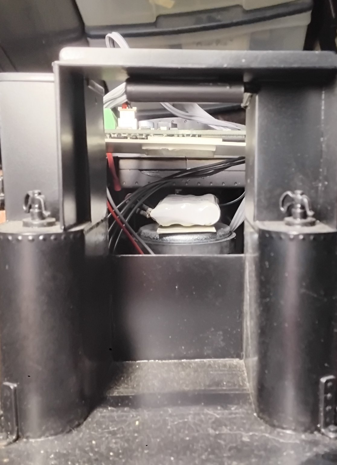

Into the tender. There is the 2K2 card, to the left, for which I have manual to refer to for setting up. Can't be much harder than a Sierra, can it ? To its left is the soon to be redundant white "stay alive" battery pack. On the right is the loco's power distribution board, which I am not familliar with. I cannot find a manual on-line and have had no responce yet to a shout out on the US based LSC. I'm sure I can work it out. Out of shot is the volume switch, in the water hatch, to be retained. Battery packs, 2 x 8 AA cells will sit either side of the tender's water tank. The speaker can just be seen in-situ below. More pick ups to disconnect on tender's trucks.

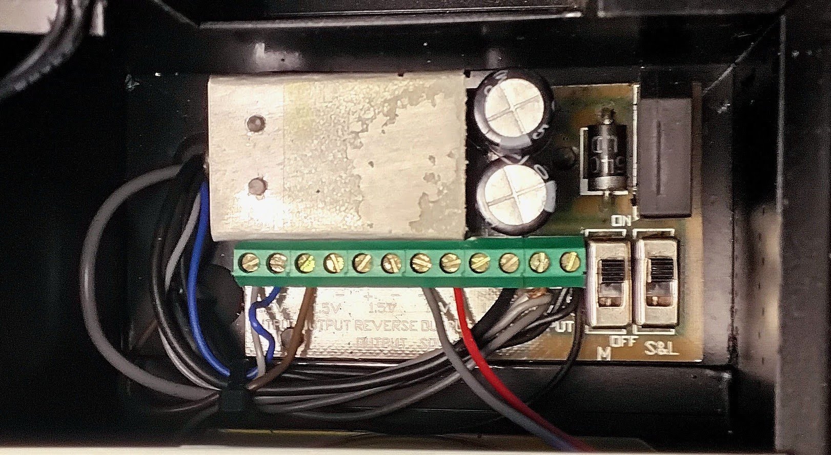

Enlargement of that Accucraft power distribution unit. Anybody familiar with it or have an Accucraft factory manual/schematic that describes is functions and operation ? I just don't want to make any silly magic white smoke creating mistakes. Your advise would be most welcome.

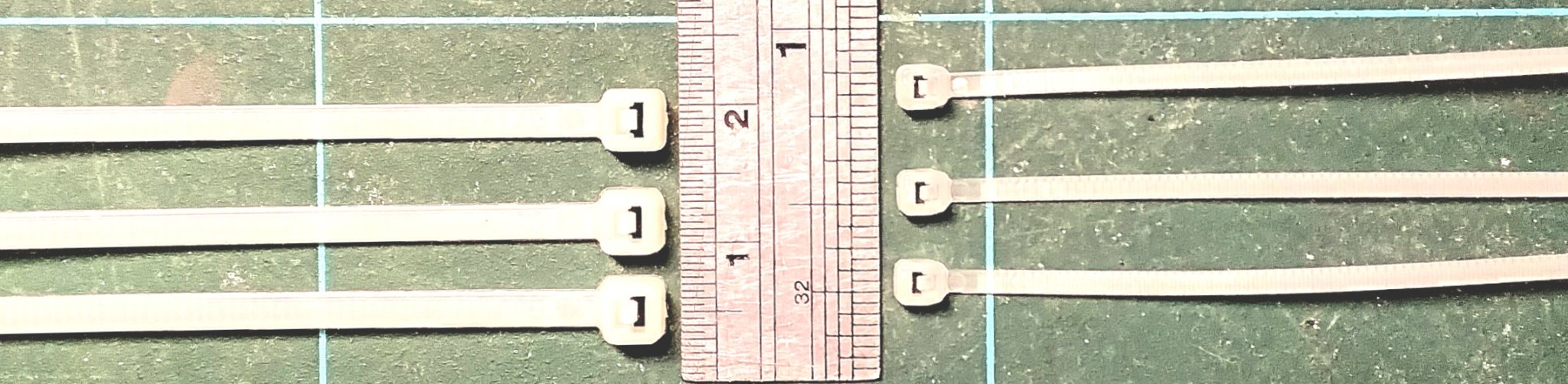

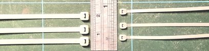

Just for the hell of it. Sub miniatue ties. Regular 2.4mm on left, sub miniature 1.8mm on right. It makes all the difference to me. My cat is eyeing them up, I pity any mice in the house if she gets her paws on them. The horror ! The horror !

Your loco is an early version. - Even if I can get you any wiring information, there are one of two things I can tell already:
The lighting into the loco is common negative. - The brown positive connection, with nothing connected to the corresponding negative gives it away.
Accucraft have a sneaky way of using the chassis as a return. - This is REALLY important to know, if converting to DCC, so thought it worth mentioning incase this gets picked up by someone looking to install a decoder.
That little dinky meter, you have somewhere in a drawer, is going to be really useful to double check what goes where..
The receiver/controller you will get is good to 20V and 3A all day, but I am adding a little insurance, in the form of a small heatsink, on the ESC chip. :nerd:
Yes, old school thinking that died out with plastic models .................... as in model railway locos :tmi:
