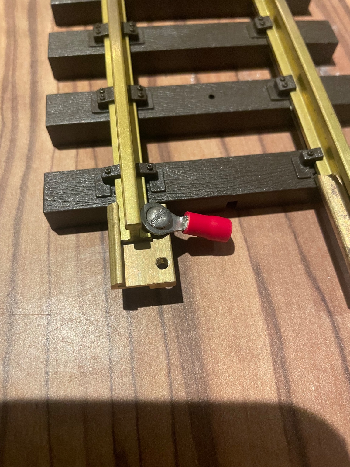

On to brass track connection… is the bolt an M3 as I wish to bring in my bus tails from under the track … x
Ah sorry. This is the clamp. Just been to a chum and it is a M3 bolt… so got longer ones and washers so it can be braced under the track… will solder the rails to this car lollipop thing.
Do you think it’s ok from below … I’m so not electric minded… but just thought well if it’s tight … it’s right
I’m only doing x5 connections in a loop about 100 ft….

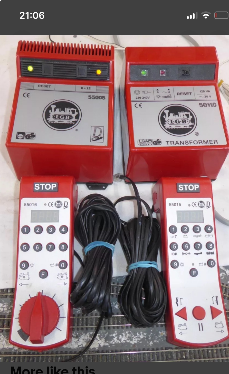

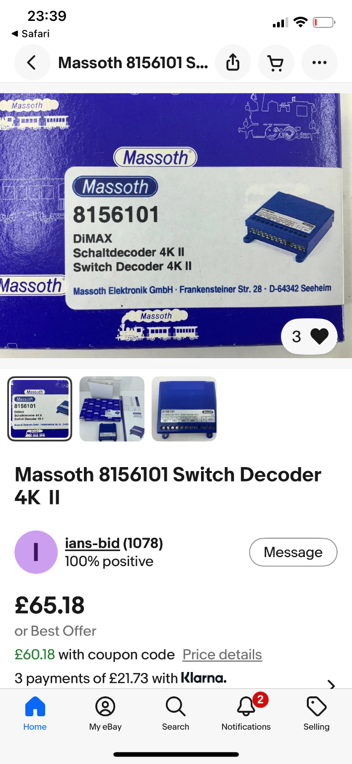

If I may ask i have as below a MTS as below …( trying to be cheap at doing this and see how it works)
I am thinking of getting the attached massoth switch decoder….. I have x4 points.
With LGB power turnout motors.
Can this work?
Sorry I’m new to power in this and everything I buy is second hand but trying to see if it can work dcc for me then go further.

Hi Gizz
Thanks some interesting points I didn’t know …
Can this work?
Oh my decoder in my loco is new obv and I’m getting there on steam effects.
Happy weekend chum
Yes, it'll work. I used the MTS 2 system with LGB point decoders before I upgraded to a Massoth 1200Z....
