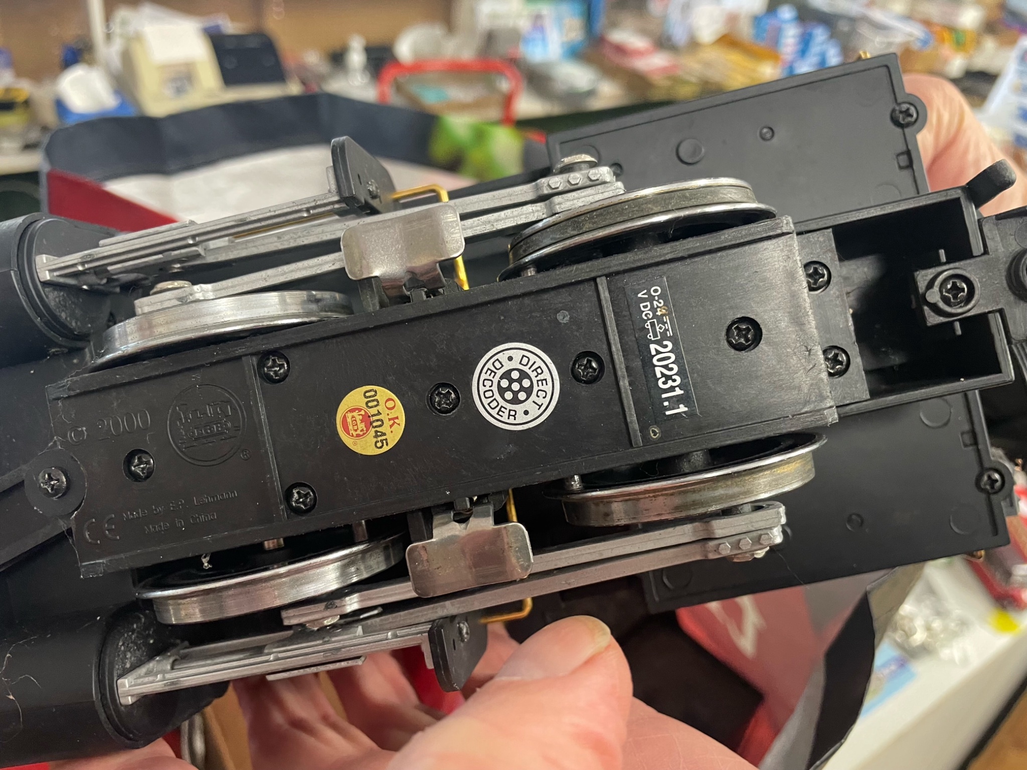

My only loco at the moment is 20231.1 .... I think see the photo?
Or is the yellow sticker 001045 the model number..?

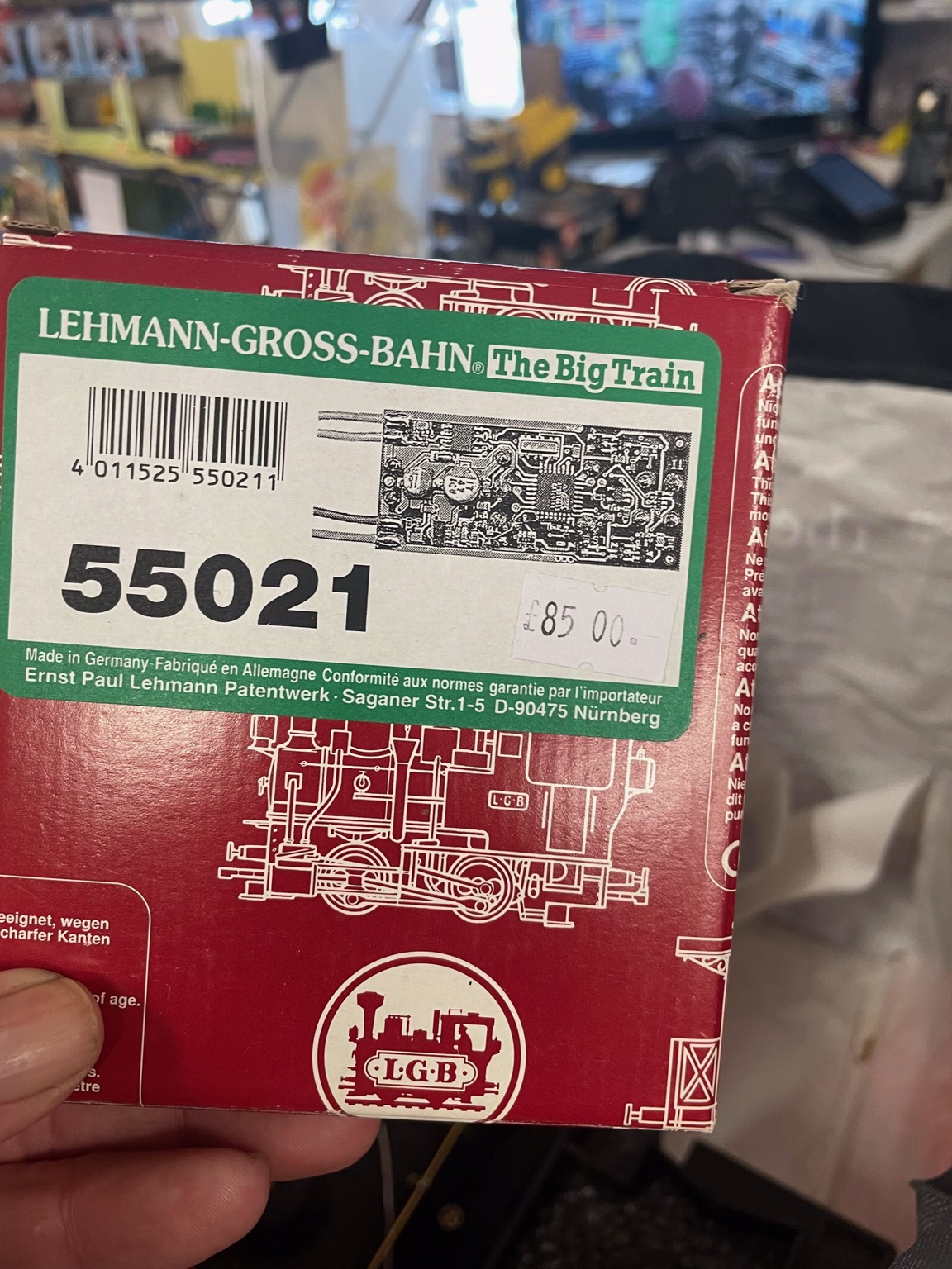

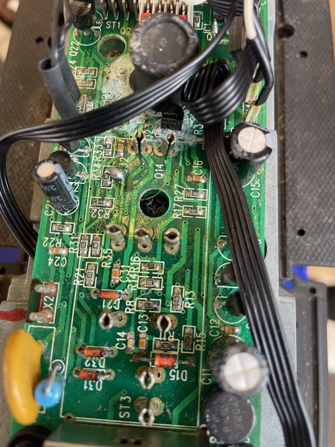

So my problem is which decoder fits this as the decoder ready sticker says six pin and when we opened it there are potentially 9x pins .... see the photo number 2.

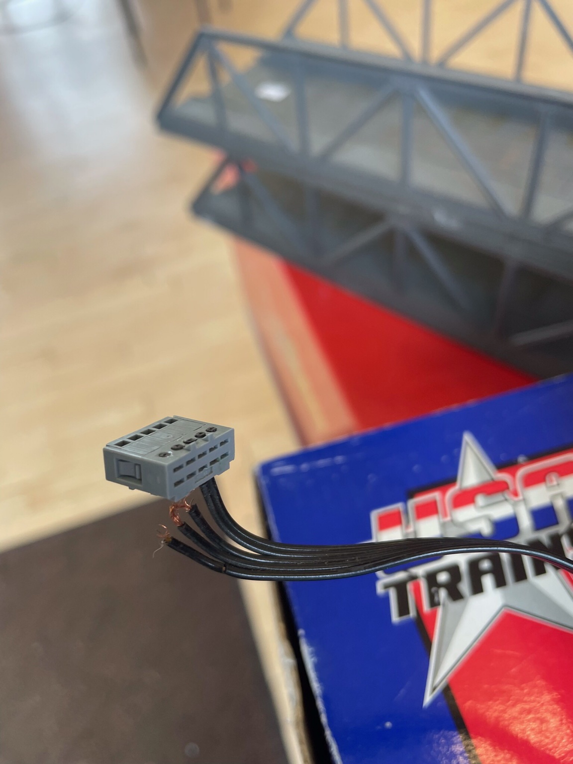

I also wonder if this plug to my tender can be fixed or do I need a new one?

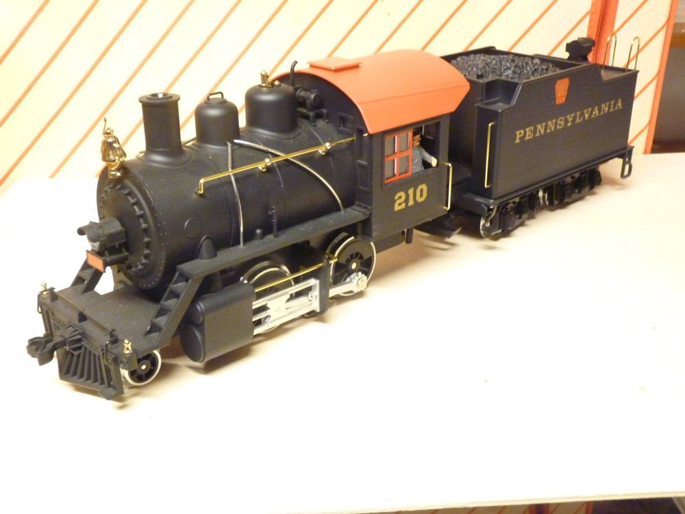

Hi I assume this is the loco and that you live in the UK.
Hello and welcome - on the 2 points:

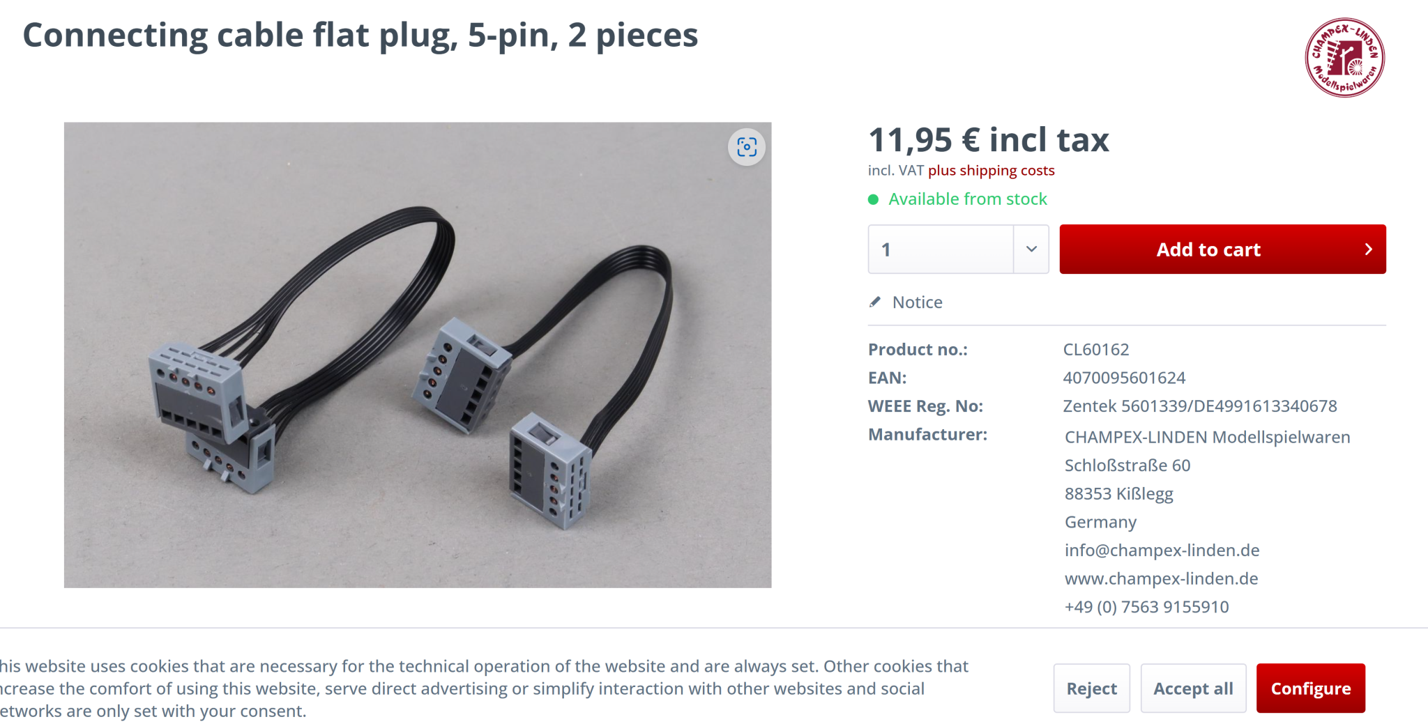

1 cable - you may be able to repair this if you pop the connector apart, cut the wire straight and recrimp
otherwise you can get a replacement here:
2 The direct decoder interface logo doesn't mean 6 pin because there are 6 dots it's not an NEM 651- you just plug in the decoder board into the sockets - it only fits one way, then you can either tie up the wires if there is room or cut them off.
The guide below is for the stainz, but shows the 55021 decoder being plugged in on top of the board and suggestions for the dips if you have them in your loco, though your manual may provide better guidance on those.

. So you recommend trying to put the wires back in or just easier to get a new cable?
This is as you say from the loco to the tender and lights the rear lights.
Is there a part number or just do a general search?

Yes I’m in Cheshire uk and that’s my loco. I know it’s crap in LGB world but it’s a great start base to make my mistakes.

Great info on the 55021 plug in but Walton may dels have sadly closed down so no link.
Also I read that this decoder doesn’t support sound which I may like to add later.?
I replaced mine, the clips on the side of the connector broke when I took it apart, it was easier to just cut the wires back a bit and fit a new one.
Sorry, I missed that bit. The plugs are not specific to garden model railways so a general search should find them. Wait until @PhilP wanders along, he might be able to point you towards a source in the UK.
