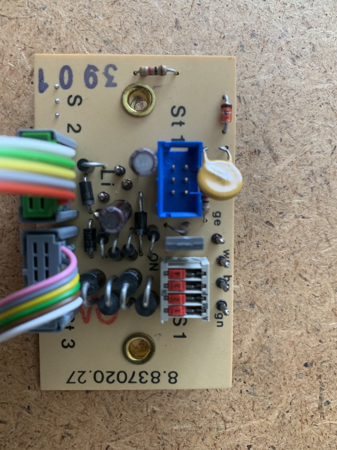

On the existing board inside this engine, there are 4 pins, labelled in abbreviated German as the same colours for the motor and wheel pickup. These are just in front of the DIP switches. The loco is supposed to be DCC ready and a straight forward DCC plug in. Yeah right, there is nothing straight forward about anything LGB/DCC! A decoder is supposed to simply plug into this engine and every thing works! Yeah right!
So, I might be a bit simple here, I’ve converted Spreewald to DCC by ripping everything out and installing a ‘proper’ decoder and not a LGB dinosaur, the question is, what are these 4 pins for? Can I just plug 4 corresponding wires to a decoder and it all works? Or do I go back to my tried and tested method or ripping it all out and wiring it up myself.
