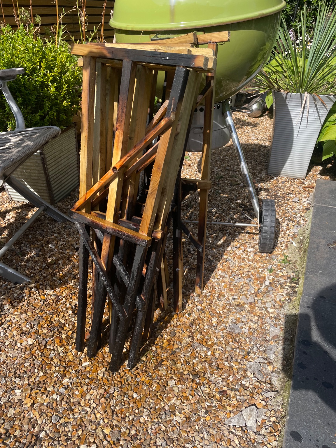

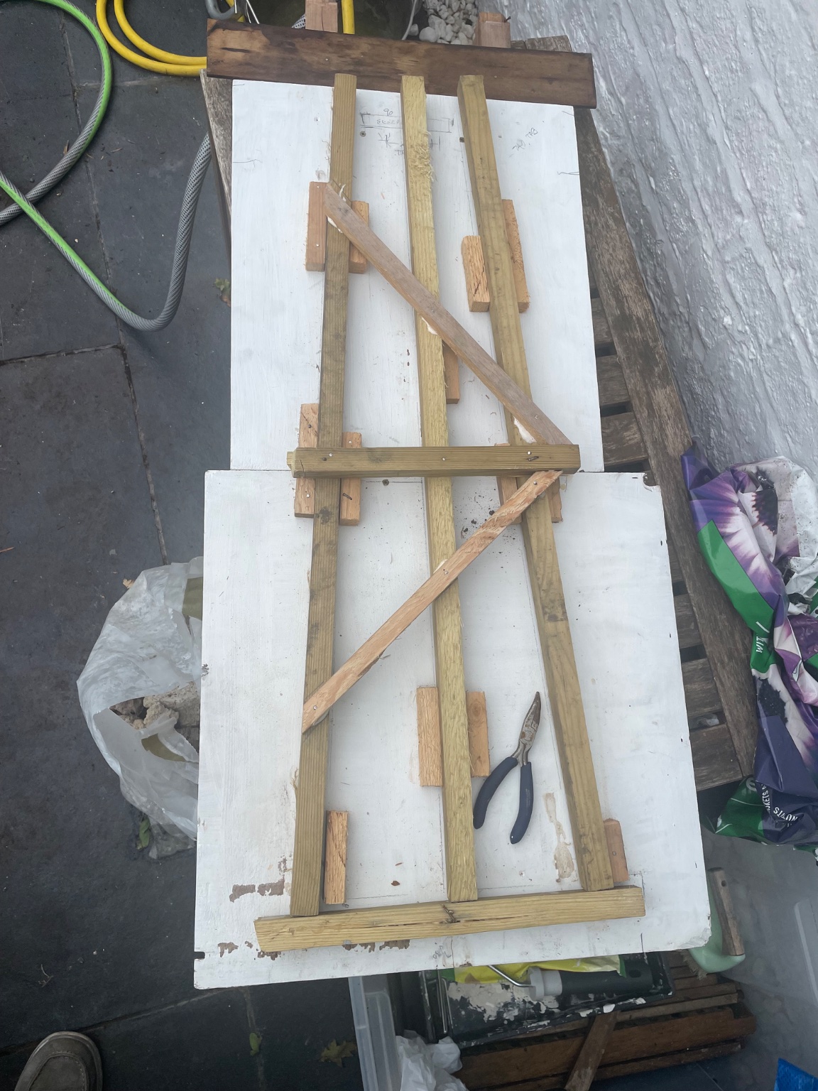

I’ve been making “bents” to make trestles and giving them a light bar b q to age
Phil helped me to get going last night but it seems happy enough clicking around today.
So I’m back to the wood cut for parts to start the up to table height.

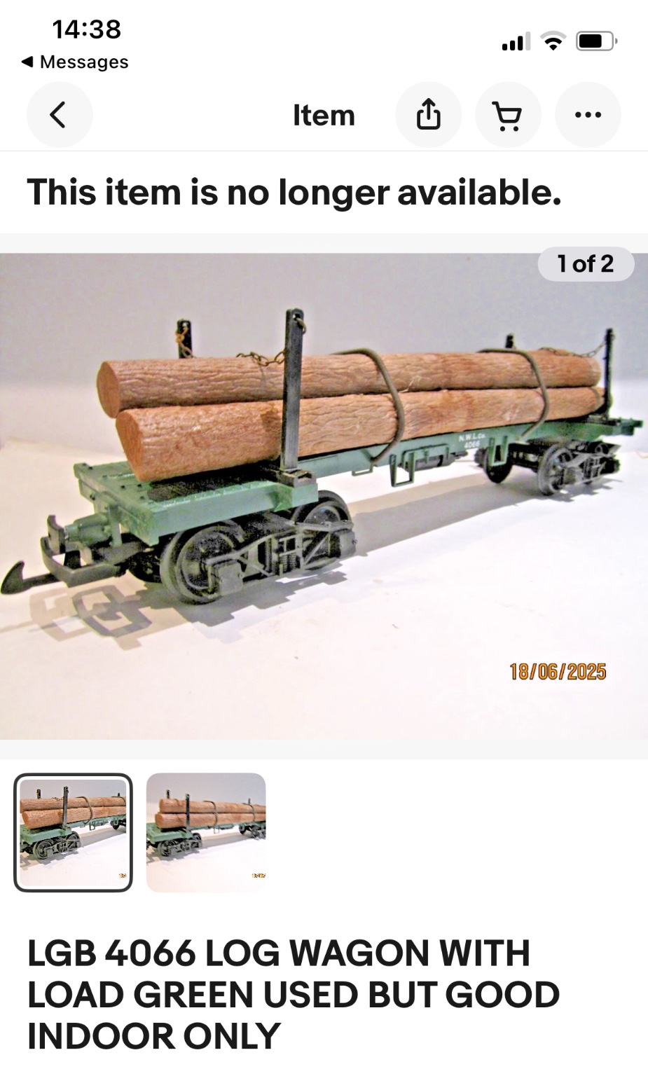

Also just got 4066 log wagon for £38 so very pleased as I believe they didn’t make many at LGB and it’s a lovely addition to North America railways as I imagine they were mixed trains …. Two carriages for people and bits and f random frieight.

Nice bents.

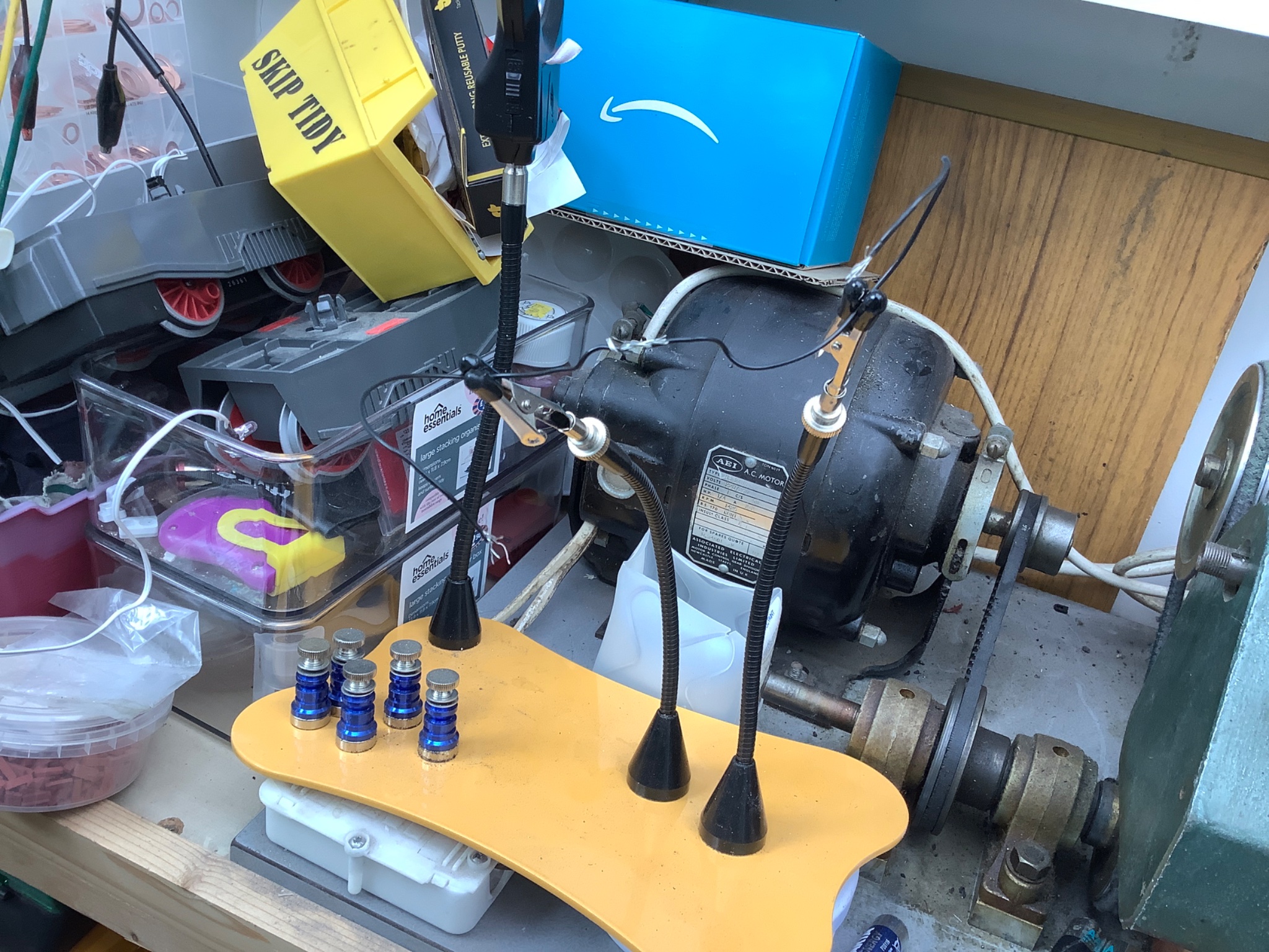

Well Dave changed the wires over and its up and running in the right diretions. .
So on to changing the bulb in one carriage. Turns out im not great at soldering..... but practice will help.

Practice soldering by joining some old wire, first effort will be rubbish but you should get better. Secret is cleanliness, wire wool very good at cleaning anything for soldering but do not let bits get onto circuit boards. Here use new clean emery cloth or wet and dry (dry) sandpaper. If you have some helping hands use these to put 2 parts together otherwise soldering is a 3 handed job. Touch the wires with soldering iron and thenintroduce the solder, fluxed solder will flow almost instantly. This should give you some confidence.image.jpg
Hi chaps…. Well solder lesson went well.
Turned out the bulb in the carriage was the wrong voltage… dave had mixed them up at various shows. Tried a labeled 18v red no prob but the white went in about ten seconds.
So that’s a lesson learnt.

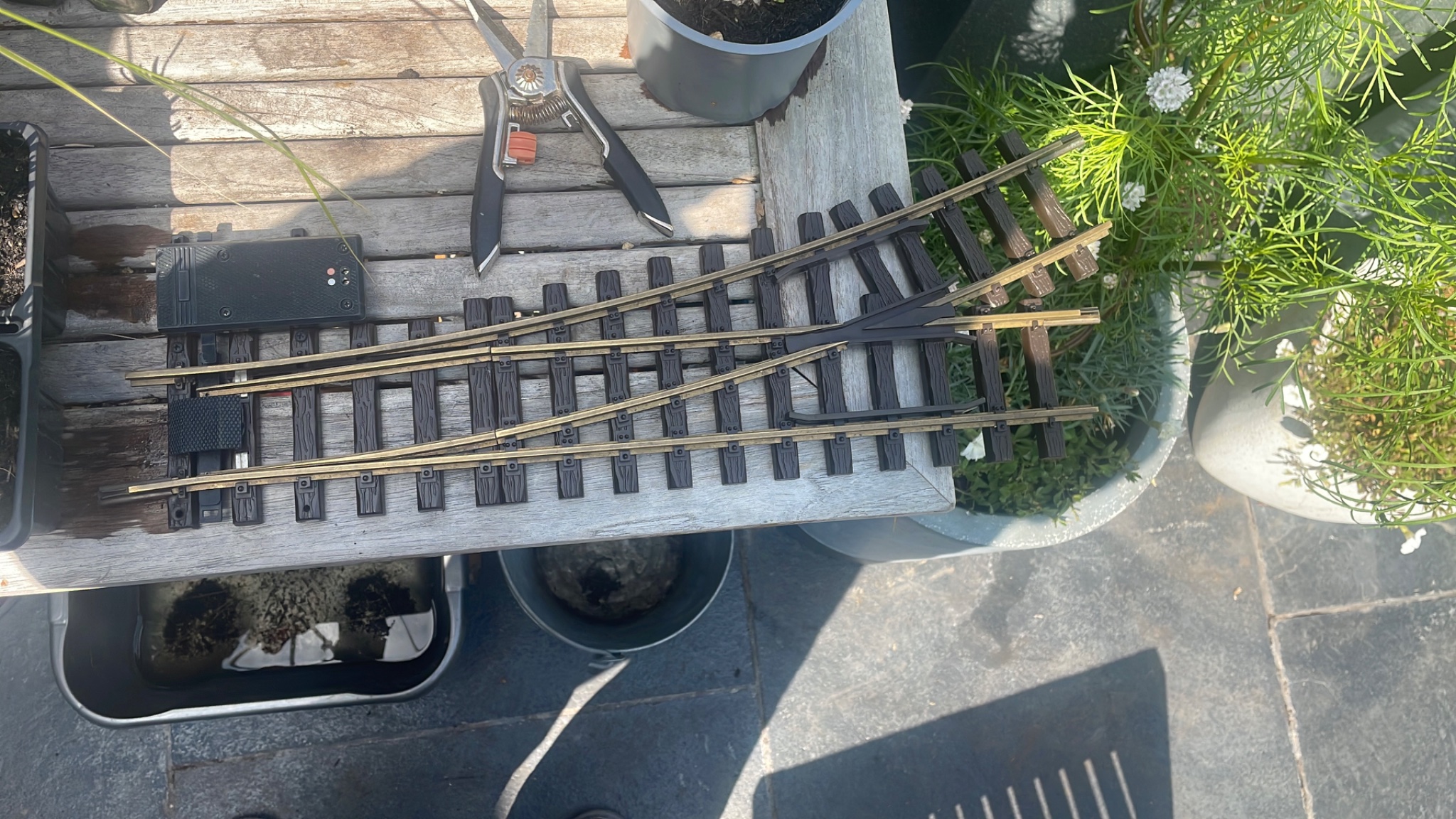

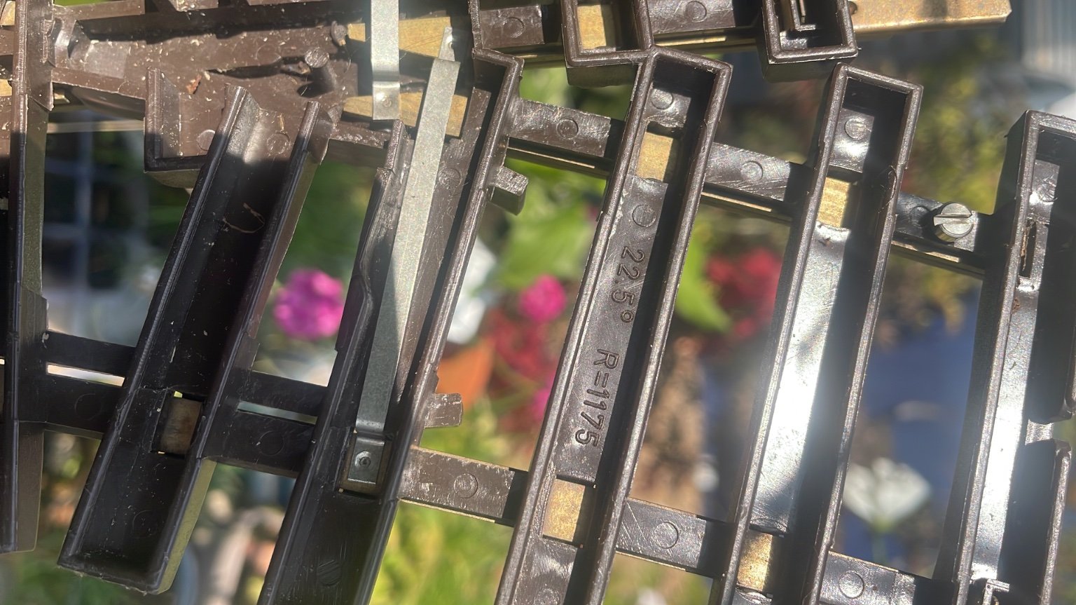

Next (no doubt silly question)
I have one turnout /point at the moment.
Does this refer to a left as that’s set from the straight bit?
I need another so I need another as in maybe right….. but I don’t know which is which?
Also I assume R1175 is the radius of this curve ?… would I need a small straight to enter a R600 bend or should I find more of R1175.

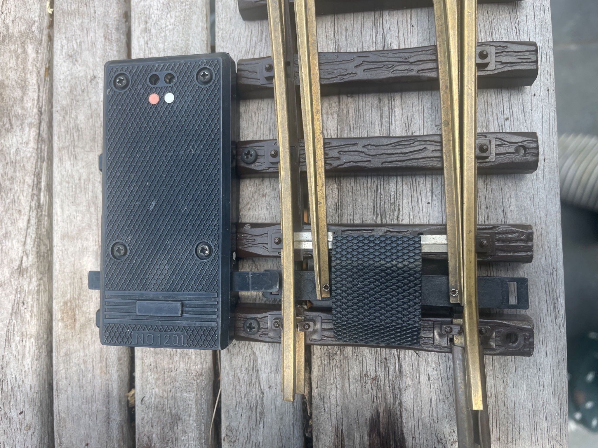

Also do these two dots orange and white mean I can connect this to a decoder to open it remotely?
The two coloured dots are the power feeds to the motor. You can use an ordinary switch to operate the motor as well however the point motor is not digital as standard. I used the LGB EPL system, all magnets and miracles - more miracles in my case - but it served its purpose.
No such thing as a silly question just silly mistakes because the question wasn't asked.
Your set of points is a LGB R3 left hand point. The 22.5° marked underneath is the radius of the curved rail. The new part numbers for R3 points are 16050 for the RH and 16150 for the LH, these are both with motors. The handing of the points is basically which way the curve off direction is. For the geometry of the rest of the track you may need there is plenty of info on the WWW, for instance:
No doubt I am completely wrong yet again but someone who really knows will be along soon enough.
Happy Sunday
Yes you can connect it to a decoder....

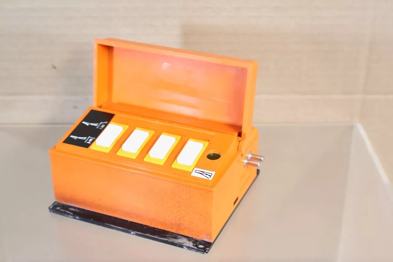

It's Orange and white based on LGB's wiring colour coding, The wire for points was Orange and White and the point switches were Orange. This was to help ensure people didn't cross connect things they shouldn't.

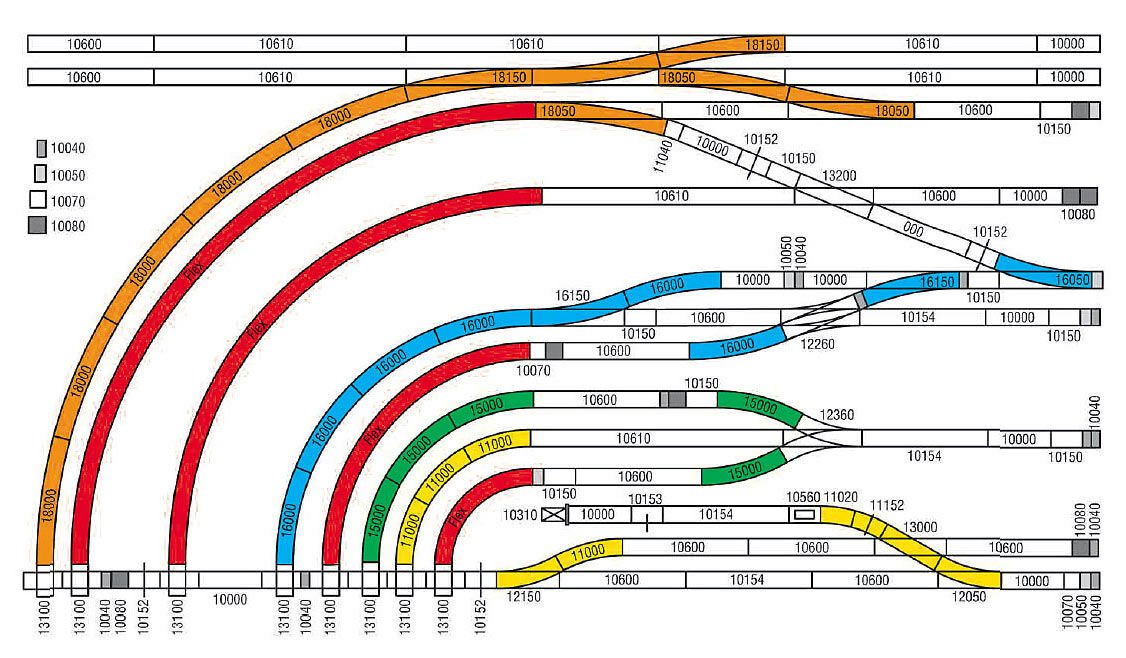

The Geometry diagram is really useful in track planning. The 22.5° figure helps you determine how much of a circle your track covers - that is with 22.5° then you need 4 pieces to get to a quarter circle or 16 pieces for a whole circle.
