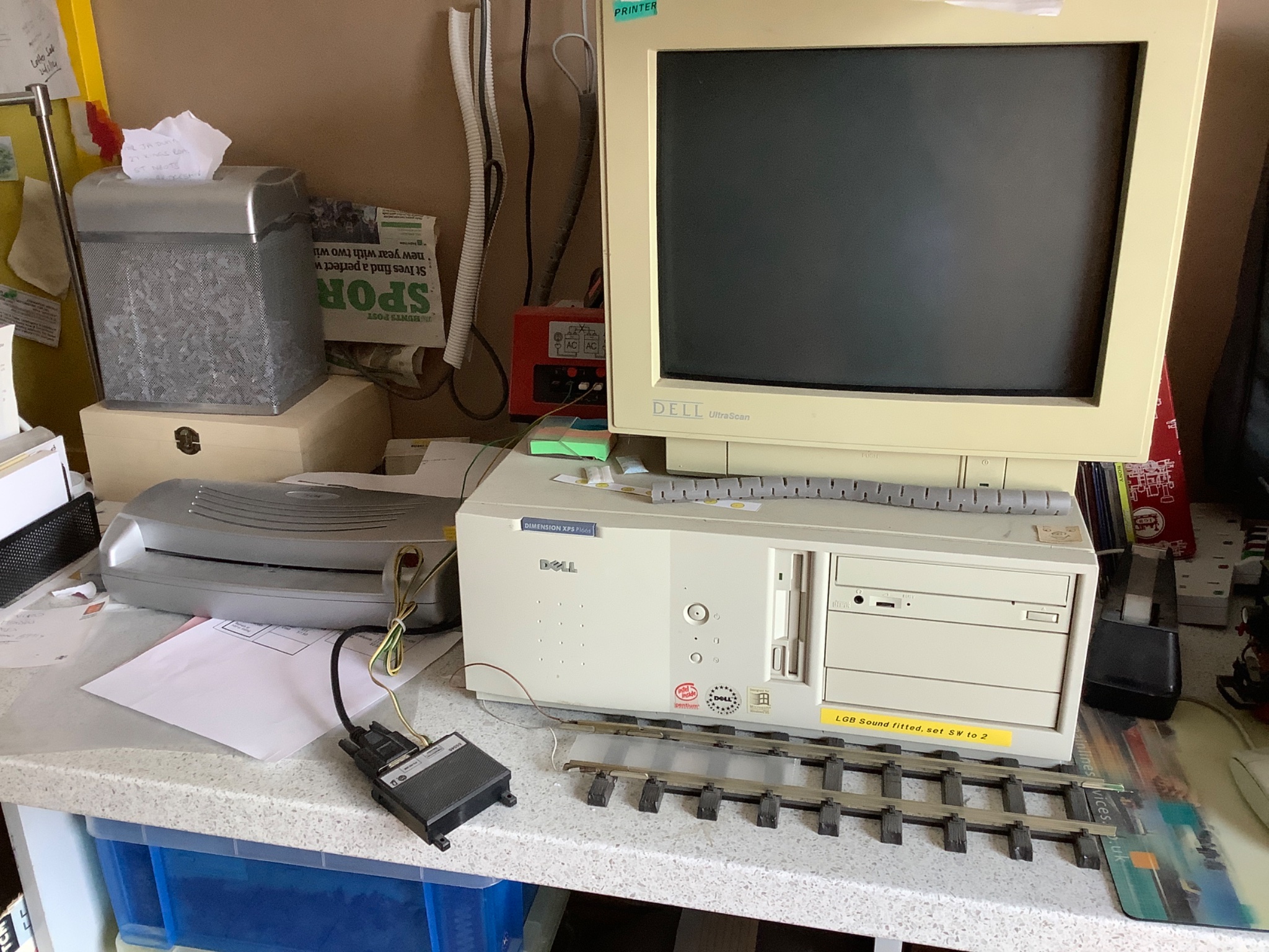

So I have 55015 …. Are we saying I can connect to my Mac ?
My Mac ️ is only two years old …. Be amazed if this handset even got on with it.
So thoughts when ya about.
  • Programming Interface:
    The LGB 55015 programmer is a common choice for connecting the MTS system to a computer.
  • Mac Connection:
    The 55015 typically connects to the Mac via a serial port. If your Mac doesn't have a serial port, you'll need a USB to serial adapter.
The 55045 was a programming interface that connected to the computer, see my post on this other thread.
There was a different LGB version that had a USB plug rather than a serial one. However as this is ancient technology I am not sure the software would run or hardware link to a current Mac or even Windows now. Certainly when I got the USB one back in the early 2000’s I intended to use it on my Windows 98 portable.
