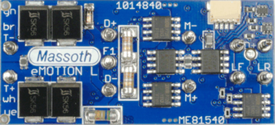

Photos of the installed decoder would be useful.
Either way, it will look like this. You need to switch the wires connected to LF and LR
But then forwards will be to the left on the controller..(or the wires connected to the motor (m+/m-)
Ok give me a min just fixing a girder bridge x this is greatPhotos of the installed decoder would be useful.

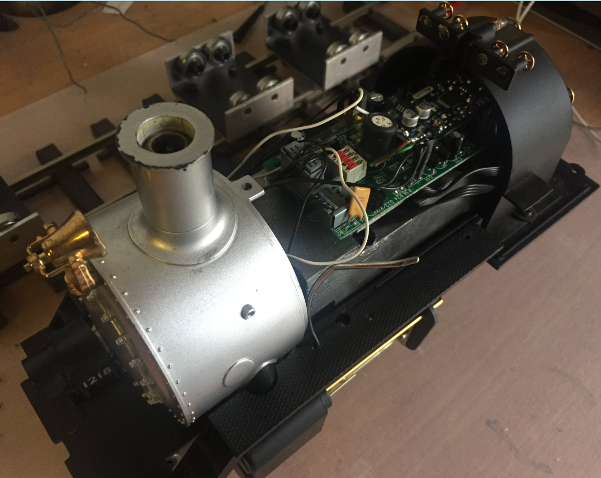

It’s like defusing a bombSo I remove these six screws ?

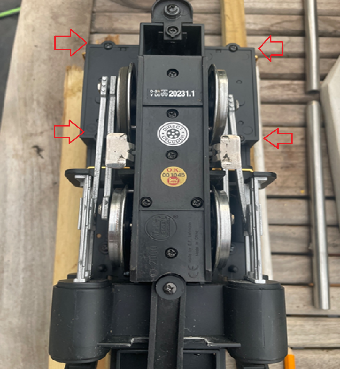

Here is the exploded diagram (pun intended)
basically you want to remove the cab and the boiler so it looks like this - you don't need to dismantle the motor block
Ah I thought the body screws were underneath will look on the topHere is the exploded diagram (pun intended)

Yes did that it opens a space of gears not the board
