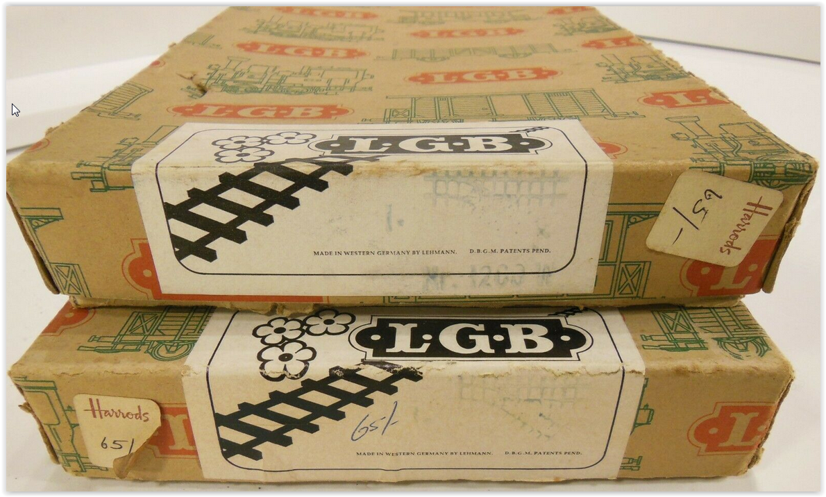

The same seller appears to have shifted a couple of RH points late last year, this time pictured with original boxes (and pre-decimal price labels!) . . .
All the best
25,480
1,294
Tamworth, Staffs.
Well that seems pretty conclusive. - Excellent piece of detective work, David.
65 shillings.. £3.20 as a 'direct to today' conversion. :eek:
