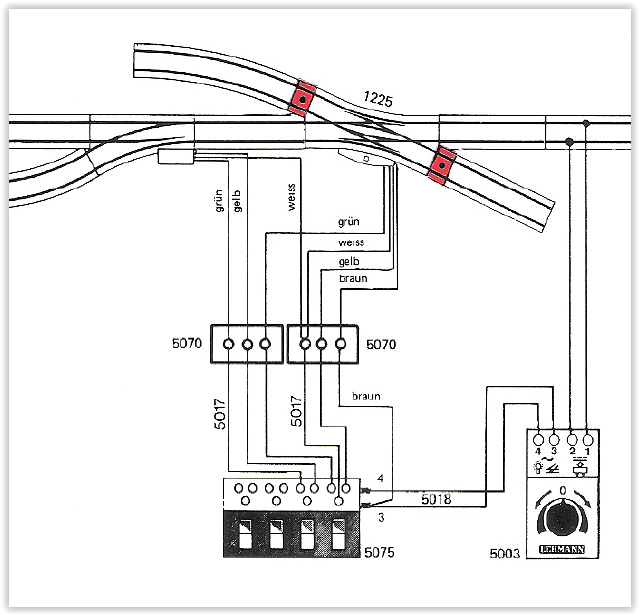

Yes, maybe not prototypical, but a good simplification in operation. I suspect the newer type should have the motors wired in parallel, that is what I would do.
