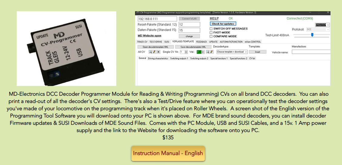

By the way, here is another much cheaper option shown on my Website for Reading and Writing CVs on your LGB locomotives with the MSD3 mfx/dcc/analog sound decoders installed instead of buying either the Marklin CS3+ or the ESU ECOS command stations to do so. You can use the below MD-Electronics PC Programming Module and be able to Read and Write all the DCC CVs in your locomotives.Hi - Glad to hear back from you and thanks for the additional information. You indicated that you have the same problem with both locomotives in trying to program CV1, the addresses. But can you Read and Write (Program) the other CVs, or do you get the same error message as when trying to Write CV1? If so, then definitely there's an issue with your CabControl unit. I've sold 15 of the ESU CabControl Digital Systems to customers during the last year and no one has told me about any Read or Write issues. But I'm going to reach out to some of them that have LGB locomotives with the MSD3 mfx/dcc/analog sound decoders installed to confirm that.

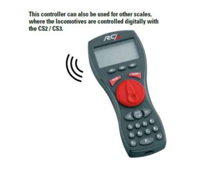

This is correct, the CS3/CS3+ do not have a dedicated wireless throttle available. Märklin gave up on it when they went with built-in web browser based server. Connecting the CS3 to a wireless network router allows for all the wireless web browser based controllers you could ever want be they smartphones, tablets, or even laptops. The only drawback to the browser based controller is not having a throttle knob or hard function switches. I personally have not found this to be a significant issue.The CS3 does not have a wireless throttle.

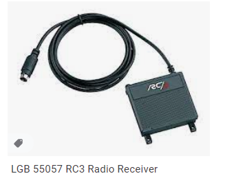

Background History: Marklin partnered with Massoth to develop a wireless throttle and receiver for the CS2/3/3+ and the products were announced in 2019, the LGB 55017 and 55057 but the products were never distributed to dealers. And in 2020 Marklin announced that it had ended that effort with Massoth (no explanation provided) and a wireless throttle and receiver would not be available until the end of 2022.This is correct, the CS3/CS3+ do not have a dedicated wireless throttle available. Märklin gave up on it when they went with built-in web browser based server. Connecting the CS3 to a wireless network router allows for all the wireless web browser based controllers you could ever want be they smartphones, tablets, or even laptops. The only drawback to the browser based controller is not having a throttle knob or hard function switches. I personally have not found this to be a significant issue.
