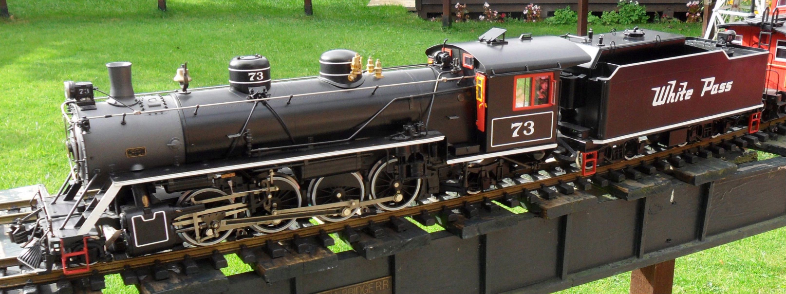

The wheel centres remain the same, because they are going to go on the same axles, right? So there would be no need to futz around with the position of the cylinders. You seem intent in spending a great deal of money here - the wheels alone, if machined, are likely around £250 or more. Who is going to do all this work?
Hi
Unfortunately when you fit smaller wheels the ride height of the boiler/cab reduces, so you would need to compensate for that by basically fitting shims above the axles in the frame.
Otherwise the cab roof hits the top of the tender, for example.
I have been told that the cylinders should be lowered by a corresponding amount to ensure that they remain inline with the wheel centre as before
I was talking to a highly recommended artisan, on Monday, who incidentally agrees broadly with your cost estimates
Hi
The lowering amounts to 0.125" - or 1/8th inch in old money. As for 'hitting the top of the tender..................................take a look here -
Anyhow, there's not much more I can offer you by way of advice. An old acquaintance back in Canada opines that it would all be a big spend for zero return, and to leave it as it is. THE White Pass maven, Borries Burkhardt over on the other side of the Great Water, might be you next call, or rather, your artisan's next call.
I would ask him to do the work on the frame,coupling rods etc.
The smaller wheels would in addition to reducing the ride height, also be too far apart if I used the original frame.
No 3 driver would be in the same position from the horizontal perspective as the original so as to use the existing rods as much as possible. Only the main coupling rod would need replacing
The loco has no frame of any kind, just a pair of articulated motor units.
Hi

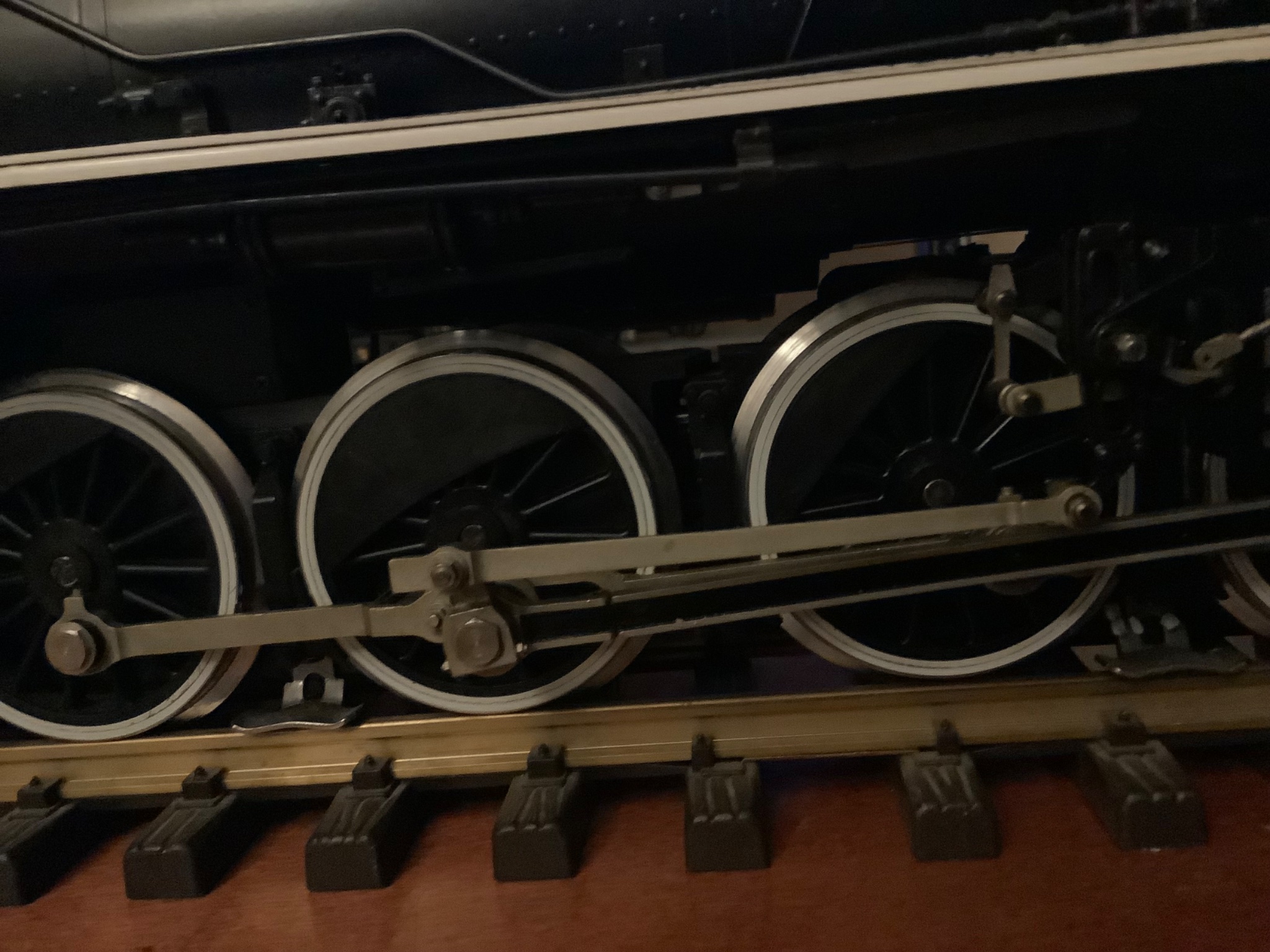

I know the frame is basically 2 articulated units, but if you have two 44” new drivers installed next to each other, you are increasing the gap between them by at least 1/4 inch at the very least, probably nearer half an inch. The original drivers already look wide apart at 1/2 inch already.
Well many thanks for your help, Surely someone must have done this already, I would like to see the results

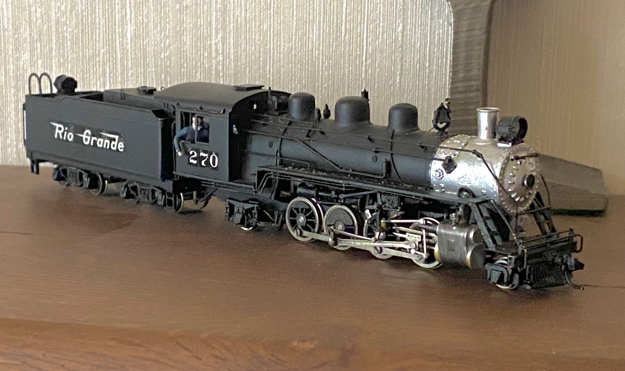

Hi, and thanks for your continued interest.
I guess I’m coming at this from a different perspective than some other people here.
Although I have built and enjoyed a garden railway a few years ago, my main interest is scale modelling, having been in the hobby since the early 1960s, following US prototypes, and recently narrow gauge in particular.
I’ve done some work for Kalmbach in the 1980s including advertising and calendar subjects, attached are a couple of examples.
I can only say that if LGB had built the exact same White Pass engine back then , but in HOn3, it would not have sold well at all due to the obvious issue with driver diameter.
I also include a photo of a White pass 70 series locomotive produced back in 68 by United, a Japanese firm, and imported by PFM which came up on eBay a week ago. The dimensions are highly accurate, and that includes the correct scale drivers.Just compare with the LGB engine and it shows that way back then, the Japanese builders, left to their own devices, could produce a fine product that compares well with and in some respects beats current models.
Over the years I’ve seen perfectly good models trashed by what the manufacturer always presumed was the likely customer base because the model had some minor discrepancy or other. These things can get out of hand.
Scale modelling is a different market I guess, and fidelity to prototype is the main thing, whereas G scale has to appeal to a broader audience, and run well outside.
