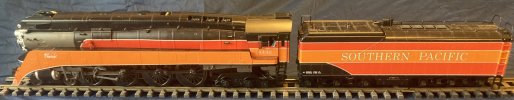

Hello Fellow G Enthusiasts!
This is my Aristo-Craft 4-8-4 Southern Pacific GS-4. It has a stretched motor block, frame and rear truck. It is based on the metal side rod later generation Aristo-Craft 4-6-2 Pacific. It has a matching tender. Enjoy your trains daily! AJ the Teacher01B5EC05-74B8-4A15-A6F2-939563C78F51.jpeg80575BF3-E8E0-4AD2-8AA3-33366B8EA85E.jpeg

Does it go round R1 curves I wonder :D

I think you will find it will do 8 foot diameter also, mine does.
Yes, but is yours an 8 coupled Greg ? Looking closely at the picture the leading set of drivers might be flangeless, the other 3 appear to be flanged. Whatever it's a really nice bit of "kitbashing" ( the term being a bit inadequate here). Stunning. Now all you need is string of USAT steamliners for it to haul, in a matching livery (would you seek to articulate some of the cars ?) At least it gets around the issues of the MTH and Accucraft models' 1 32 scaling, precluding the USAT car's pairing. Max

What are you referring to? My site? They are all flanged, and having the leading driver without a flange would be really weird, and not track well. (mine is a Northern)
In any case mine was made by the famous Rex Ammerman, who extended the motor block housing and took advantage of the modular designed gearboxes. (Using the pacific drivers)
I also have a 2-10-2 (using mikado drivers) bashed the same way.
I have 2 strings of USAT passenger cars, both the new heavyweights, and the 80 scale foot streamliners.
I guess you have never been to my web site? On my home page? Home page picture below, 10 car streamliner, pulled by three E8 diesels.
Could be a "trick of the light", they all look flanged to me :)

Hello Greg. You are correct. My GS-3, made out of a 1st generation plastic side rod 4-6-2 Pacific does go around 8 foot curves. My GS-3 has the old electric motor design that is tucked up into the frame. Because of this motor location my rear trailing truck swings from side to side well.
My newer GS-4 would go around 8 foot curves well too, except for my new trailing truck design. I tried hard to come up with a rear trailing truck that would fit close to the drivers, under the electric motor. It needs larger curves because (at this time) it is much more limited in how far it can swing from left to right. Rex's trailing rear truck design, which is spaced farther away (it puts the axles and wheels past the electric motor) swings much better.
But I will endeavor to redesign my rear trailing truck at a later date. Thanks AJ the Teacher

Thanks maxi-model for your kind assessment of how my locomotive turned out. (All of my drivers are flanged.) At this time, I have 6 smoothside passenger cars and I have an auxiliary tender almost ready for paint. I am searching for other smoothside cars to modify into an articulated diner set. (Maybe this winter.) If I can't find cars to modify I will attempt to scratchbuild additional cars. Thanks. AJ the Teacher

using this method would it be possible to make a 4-8-2 that can squeeze around R3 curves?

I think that it would be close. My metal side-rod Aristo-Craft 4-8-4 now goes around 8 foot curves. (I redesigned my rear trailing truck to give the rear trailing truck front pivot the ability to slide sideways some and track side-to-side, so that now it works well on 8 foot curves) My understanding is that R3 is very close in size. Thanks AJ the Teacher
