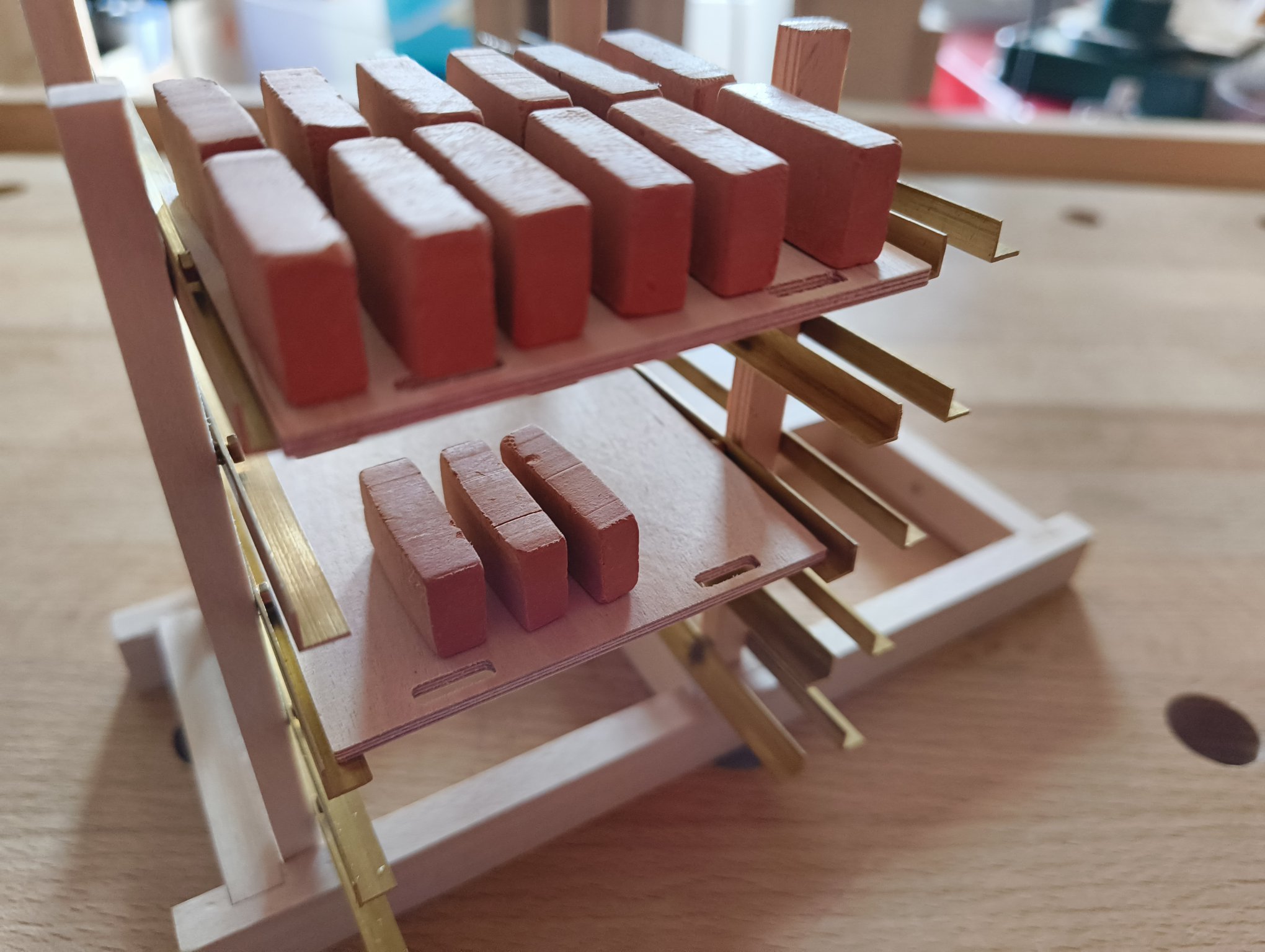

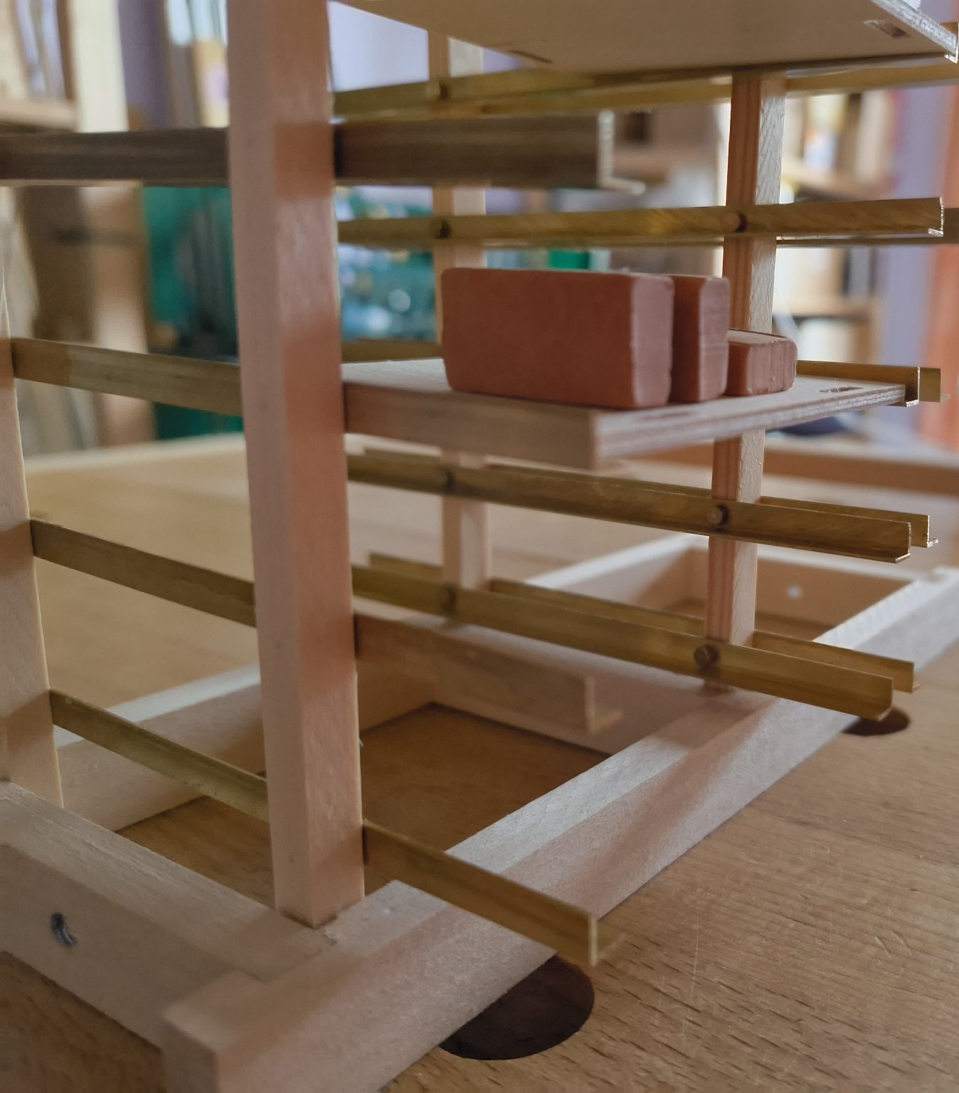

I bought my bricks on bloxxs.de for €37,50 including shipping.
Each bag of bricks weighs about 400 grams. I bought 3 bags. I think the lorry will be able to roll happily along.

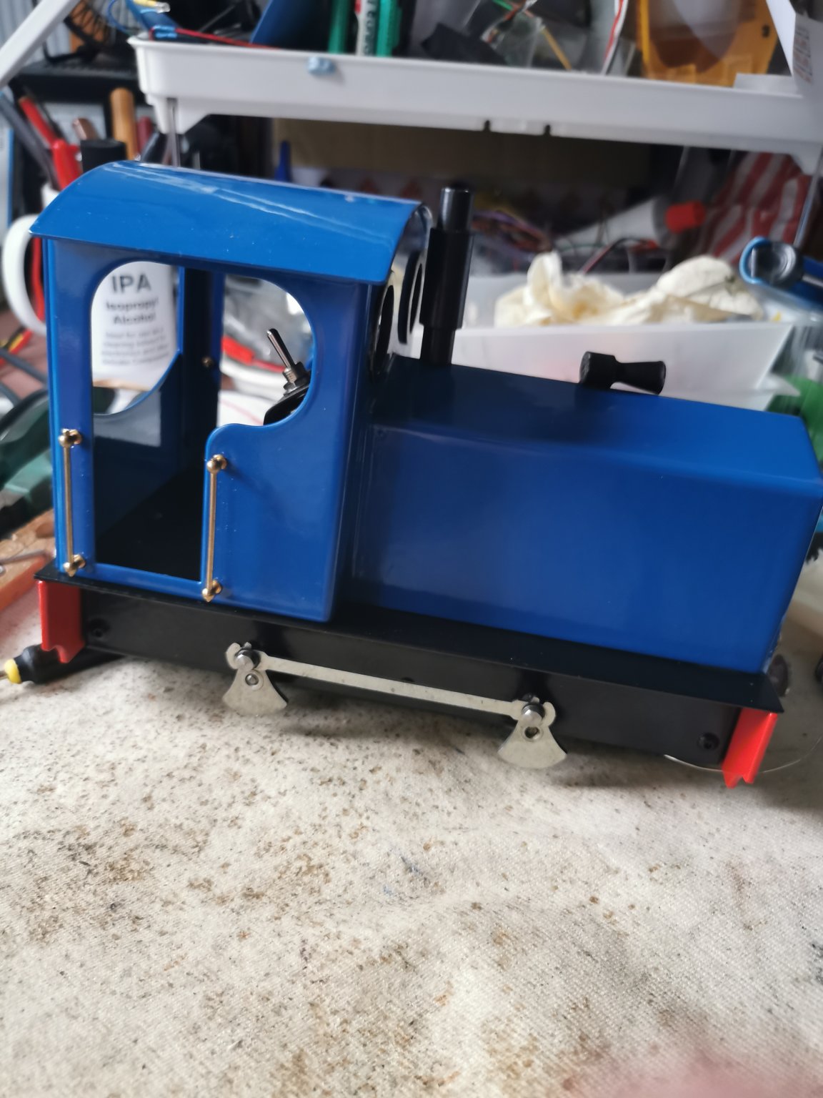

As promised in the daily thread:
I have two of these to sort out..
Unscrew the exhaust, and the body lifts off.
Both have motor-gearbox problems. - Motor has a red plastic covered gearbox. Plastics final drive to axle is bevel-gears. One is split. Both appear to have lost their grub-screws. One gearbox is locked solid.

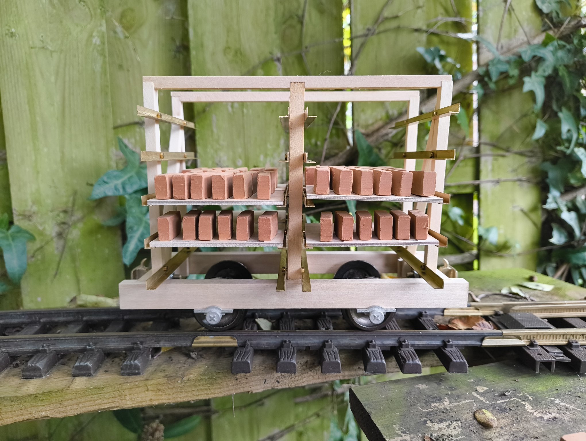

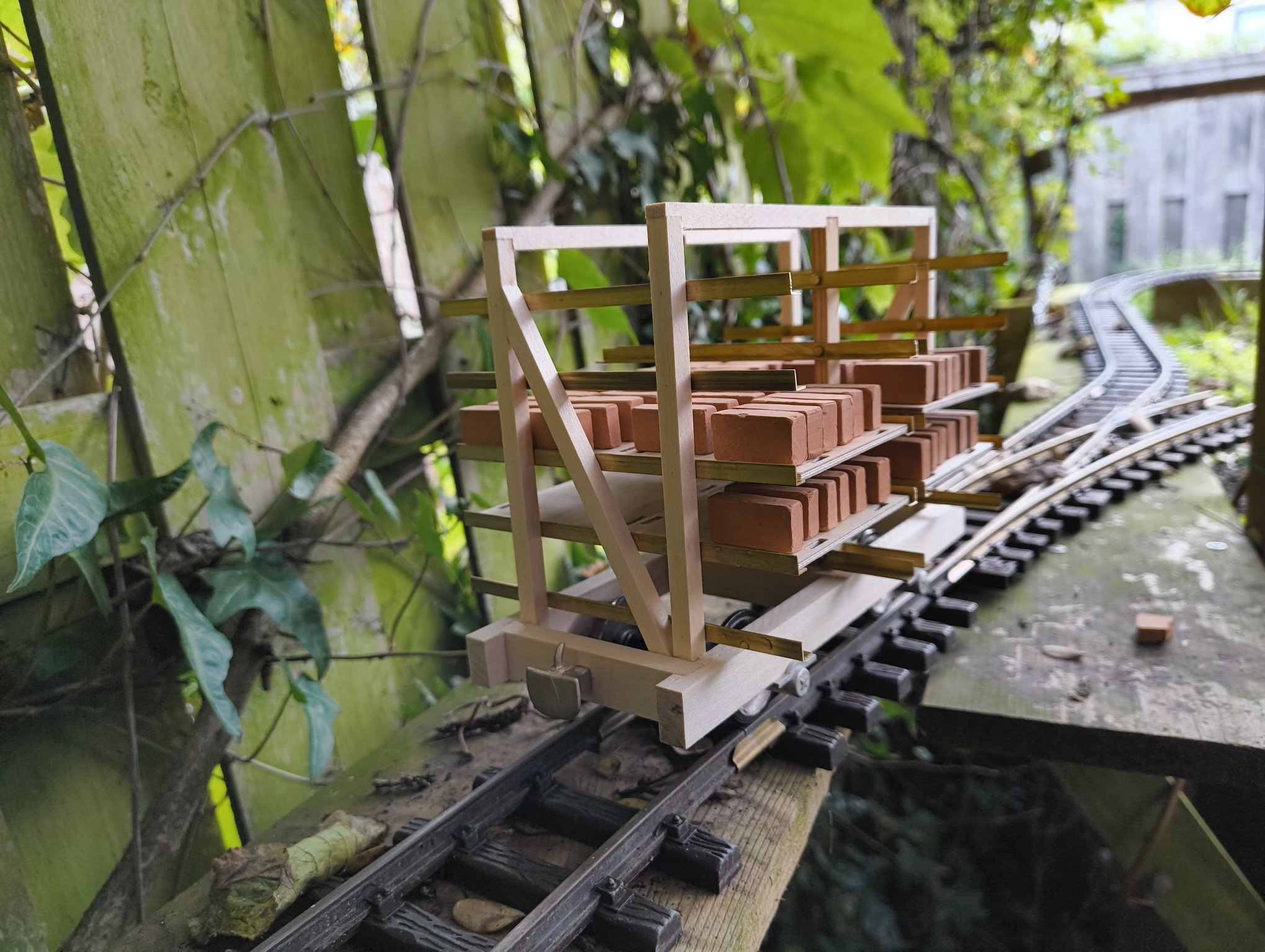

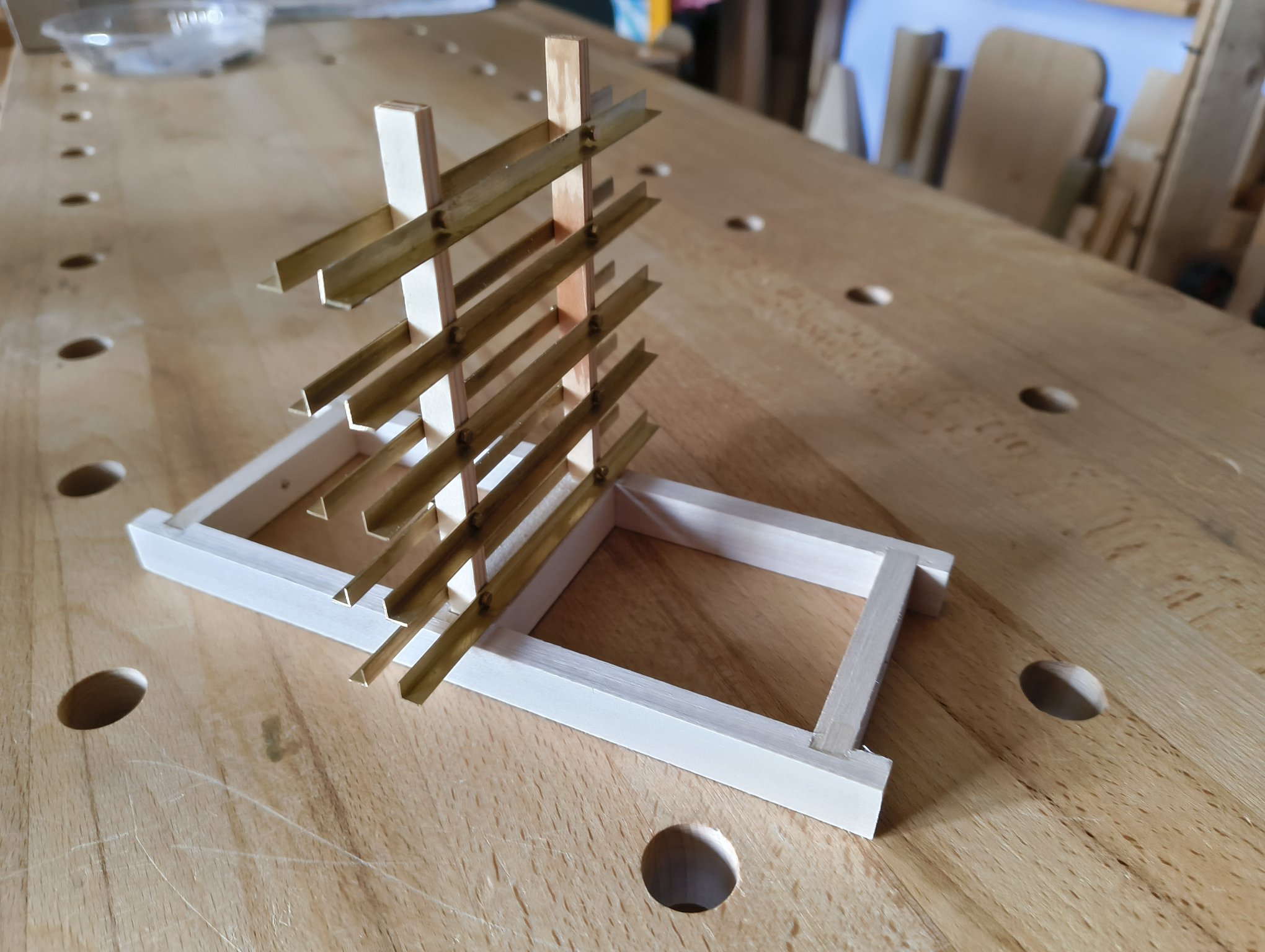

The brick lorry still needs some fine tuning, but it's basically operational.
Some painting/weathering is in order.
And I'll probably glue the bricks to the plates. Setting individual bricks on the plates for the photo, was quite a chore.

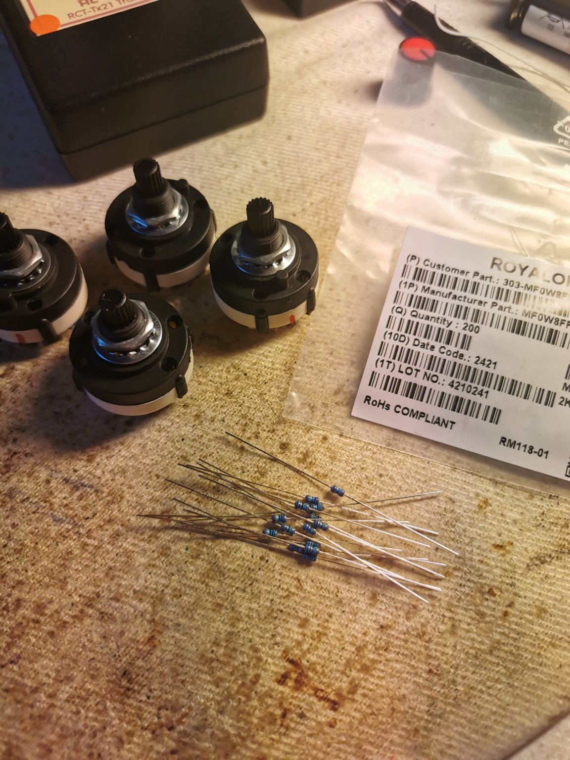

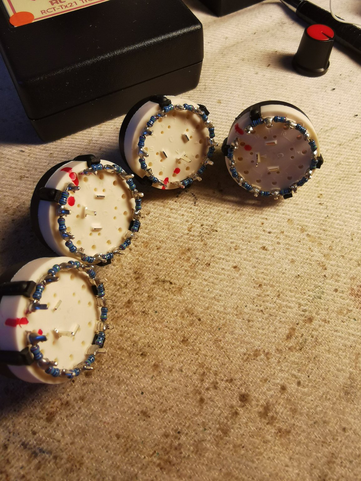

No, receiver selection on the 12-receiver Transmitters..
Just a voltage divider on Ch. 2, the value of which is sent along with the 24-bit GUID to the receiver when it is bound to the transmitter.
Software is written to look at both, before responding to commands.
12 transmitters or one bound to 12 receivers?
If one can more than one loco be controlled at the same time?
One transmitter with 12 different selected channels, Phil can explain better than I can.
