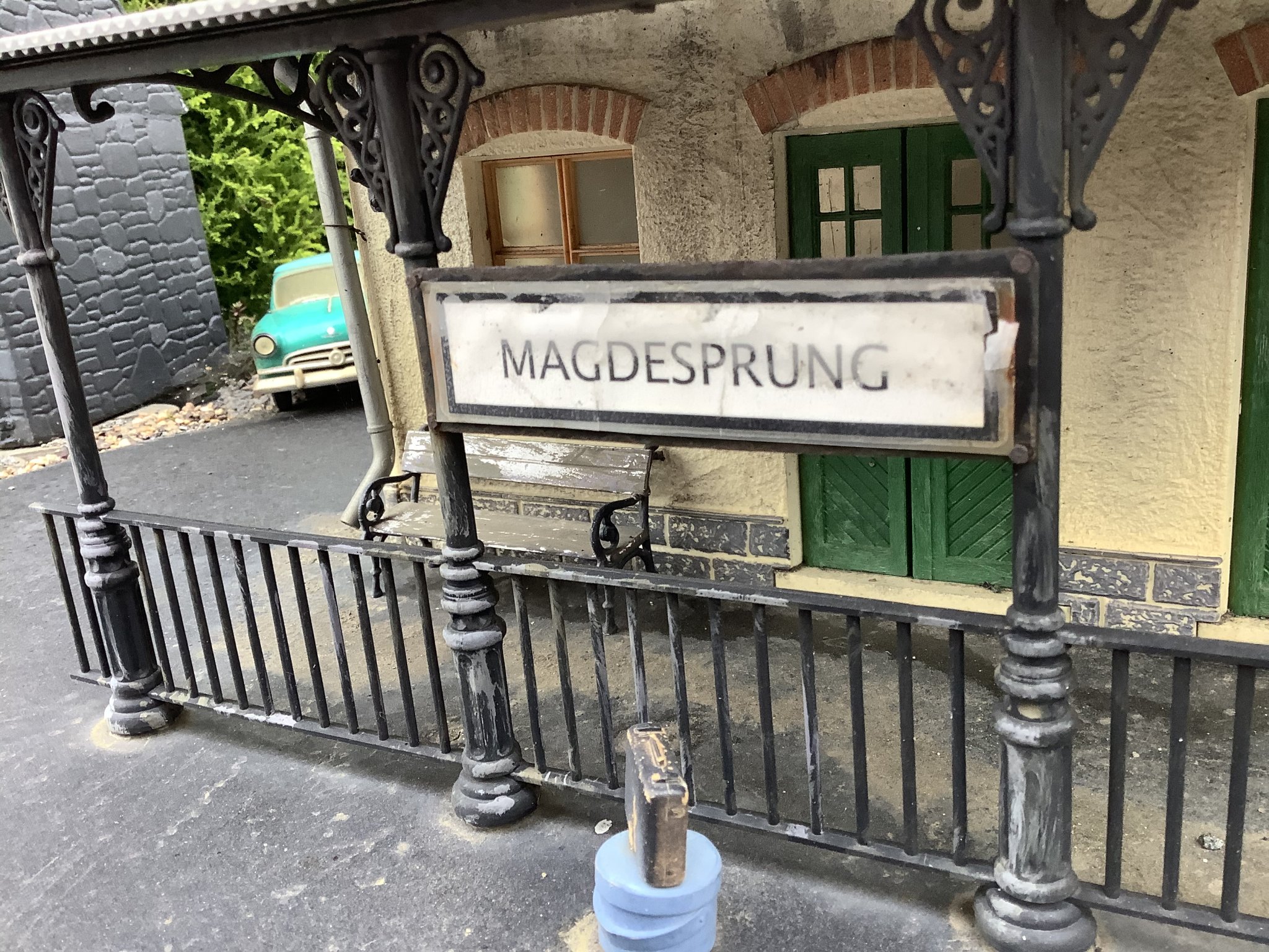

Mine are printed on normal paper with a black border then I laminate them. Cut as close as you can to the edge but ensure a sealed edge. Hotel Silberhutte does not get much sun so the laminate has held up nicely, but Magdesprung is in the sun all day so the laminate has broken down some over the 7 years it has been in place.
54134407-7F9E-4F3B-A9F4-469650BB9528.jpegEAF7476B-3B51-48E2-ACB5-5315969BB2F2.jpeg9F6B65D6-4AFB-437C-8913-E333ABD4AD7F.jpegC25610BD-9C9B-45FD-A2D0-3C20BEDB9668.jpeg
From normal distance view the excess of laminate is barely noticeable. I place my signs on Tinplate and the signs themselves have adhesive magnetic tape to that they can be easily replaces without having to rely on glue.
