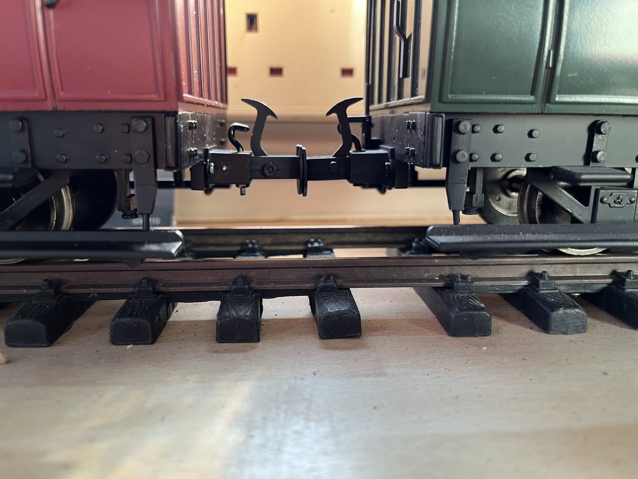

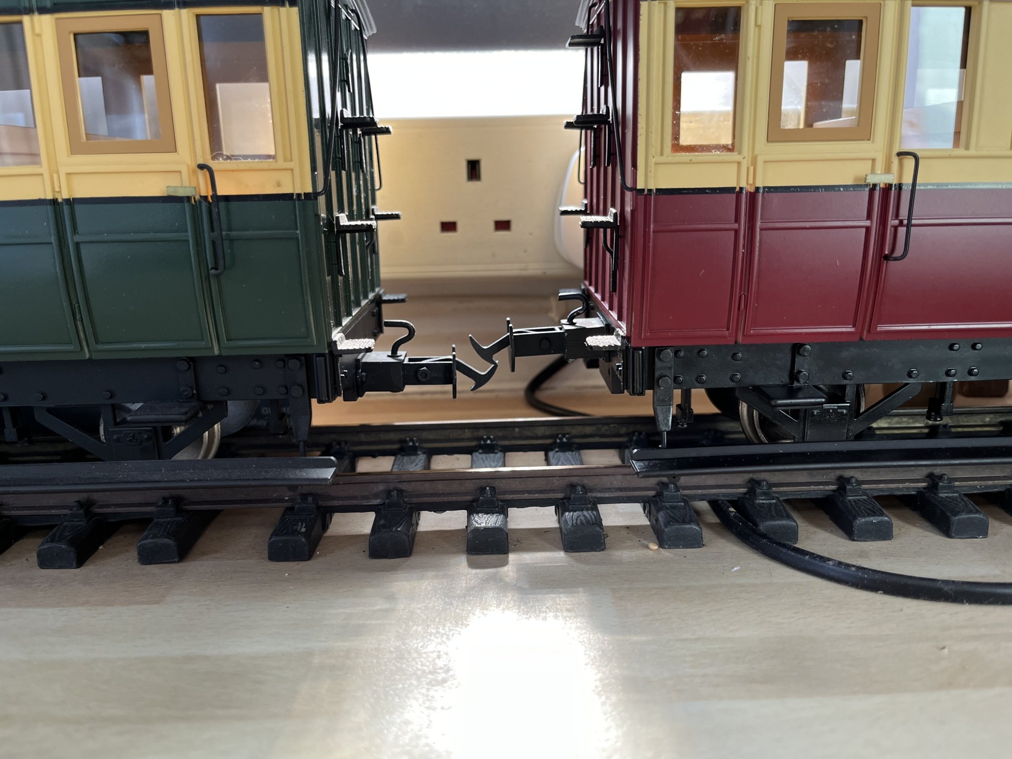

Yes the coupling were different heights, so that was brought in line, however still out:Just a thought - I used to have a set of these coaches, they have 2 different coupler height mount holes drilled in the ends. Have you got the right wheels but the couplers in the wrong hoes for thr rest of your stock ? Max
The wheels fitted to the green coach were only 30mmLet us be done with this confusion!

A pack of 32.5mm diameter wheels were ordered, Saturday, and arrived today. About 0.4mm smaller in diameter, so acceptable, however the was an extra spacer fitted under the axle boxes, so once both coaches were set up the same, success. So many thanks to the forum for their input, and back to the driftMaybe these are what you are looking for. Bachmann 88071 (92421) 1:20.3 FINESCALE 32.5MM WHEEL SETS (4/CARD) 2 PAIRS NEW 22899880716 | eBay I bought one set of these a few years ago. They are slightly too large to fit LGB coaches. They drag on the brake shoes molded on most LGB trucks. By the way, these seem much better made than the typical Bachmann G scale metal wheelsets. The ones I got have no wobble at all.
