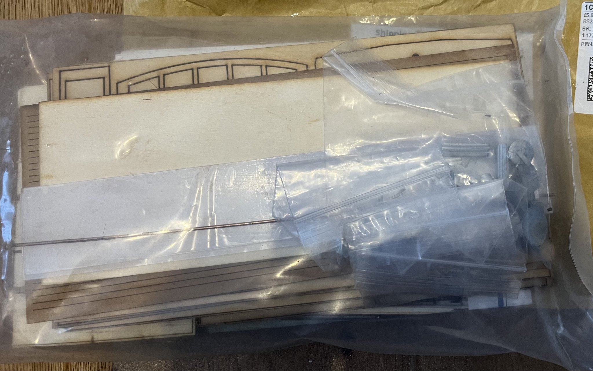

IP Eng L&B 3 Compartment Coach Kit
Work continues, the seats have now been covered in fabric, which I think looks better than painting, and temporally fitted. Though a nice fit, the top of the backrest is level with the windows, and will need a tweak to get the glazing in.
The chassis has a row of holes laser cut along its side, no mention of these in the build instructions, but now assembled I assume it is to fit rivets into - which is what I have done. A job that would have been easier before assembly.
