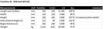

Previously this locomotive was available from Dietz and it is also currently available from Trainmen.fun - however both these locomotives are around twice the price of the Trainline versions. A comparison can be seen on FGB Berlins webpage: FGB Berlin comparison
