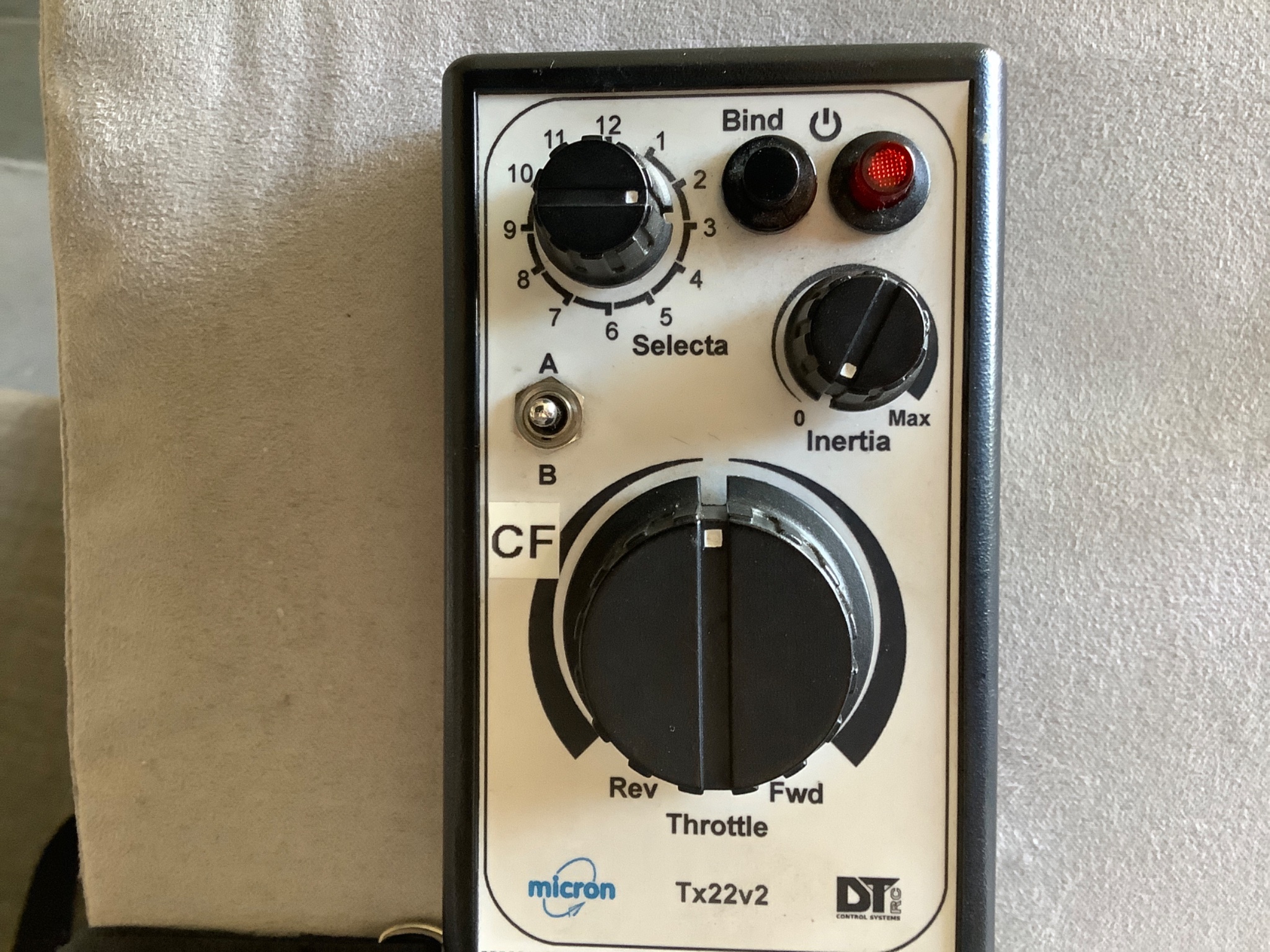

Have you got into Micron/Deltang programming yet? For help on this look at Ge_rik ‘s blog where he explains it very well. I would have been completely lost when I needed to update mine.

I found the instructions a bit confusing where they refer to the same things in different ways and different things the same way! I downloaded and printed the prog notes from the Deltang webb site though Micron may have their own by now, been a while since I was delving and I think Deltang as such out of the frame?

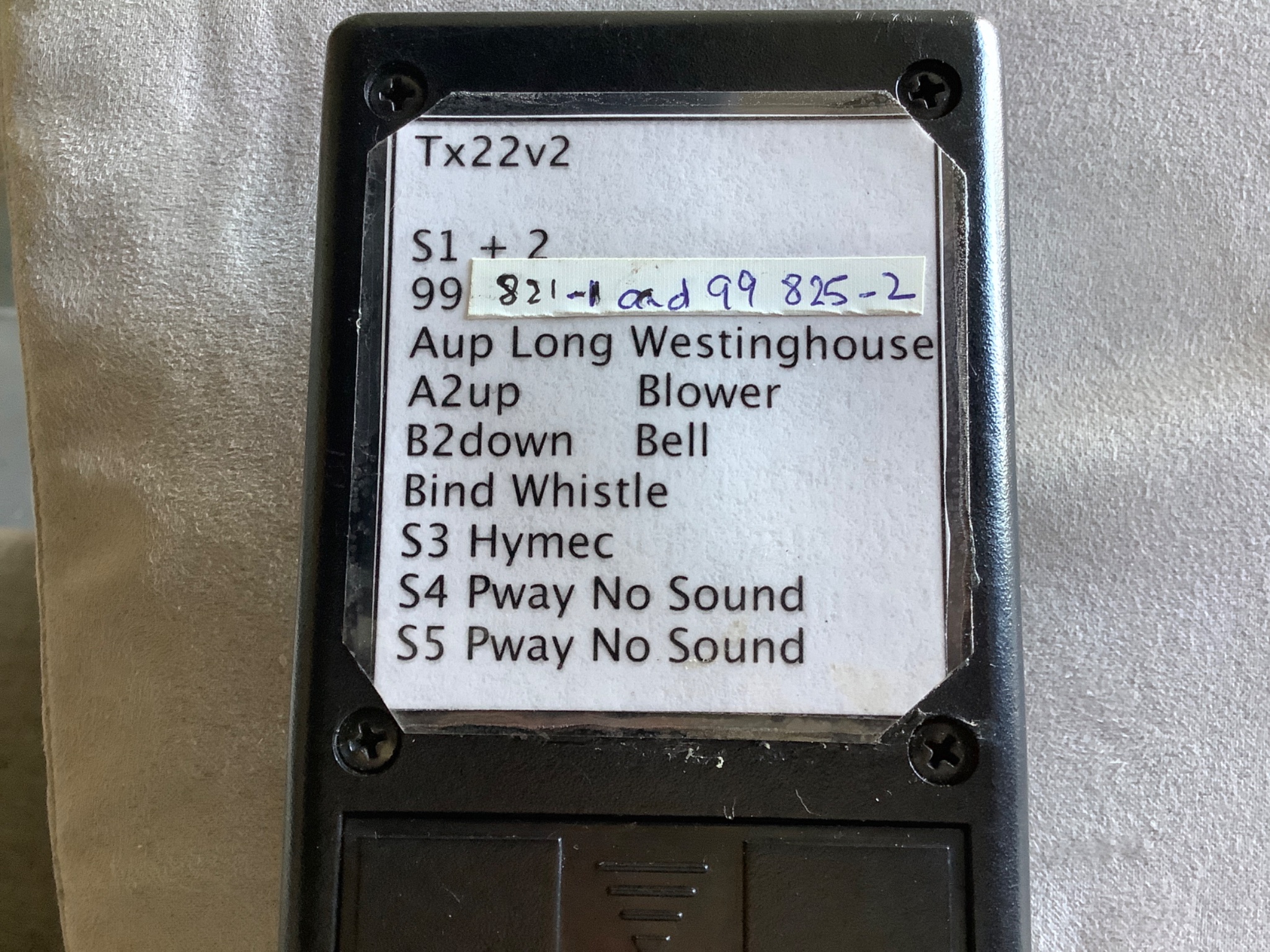

Well worth it in the long run, I found that going in without a clear plan was not a good idea. You can see a sort of profanity on the first table where I screwed it all up with the wrong programming! Have 5 items controlled from my handset, 3 with sound. What was complex were the 2 steam trams where I wanted 4 sounds available, nice man at Micron worked out what to do but I had to do it so that was a pretty harsh learning curve. But got it in the end.
What is good about the deltang/micron is the ability to program the buttons/switches as you wish with the same button being able to do 2 functions. See my crib sheet below on the back if my handset where Switch A does Westinghouse with long held up and blower with just flick up.
