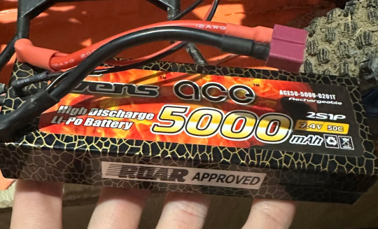

--I've already got a good LiPo battery that I use for my R/C rock crawler car, so I'd hope to use that for this as well preferably.
--It's a 7.4V 5Amp LiPo battery, and have a fancy charger for it already. Would this be a big/small enough power to work with everything? I think I'd seen that the motors normally run on 24V, so if need be a can get another to meet any power requirements

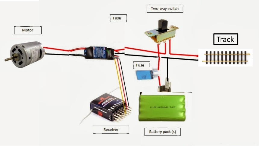

--I've seen on diagrams from a guide on conversion, Dummies Guide To Convert A Track Powered G Scale Locomotive To Rc Battery Powered and Getting started with battery power and radio control, that I'd need a switch and fuse, and wondered if their still needed if I can unplug the battery instead. I'd altered the diagram for what I think works for if I went for interchangeable power between track and battery. From a little bit of research, I think that's how that kind of switch works?
--I have no idea how a receiver would work, if at all, when connected to basic analog track power. I'd still want at least basic electric motor sounds when powered by the track if that's how it works.

I use Li-Ion's in my battery locos, and these are 6S (22.2v) but you don't need to do that. I would suggest that 2 x 7.4v packs in series would be a better bet - 7.4v might be a bit slow, and is possibly a bit low for the decoder.
I would highly recommend NOT charging the battery from the track unless you know what you are doing. Lithium batteries need to be charged correctly, with a proper charger.
Deffo fit a fuse between the batteries and the DCC radio - those batteries can supply 100A+ quite happily.
In regards to track power, I would use a DPDT switch, with the feed from the DCC radio one side, a feed from the track the other side, and the output to the decoder in the middle. This prevents you shorting between DCC radio / track, and gives you and off position (switch in the middle).
The LokSound decoders will work in analogue track power mode - with the above mentioned switch for changing between DCC radio and track.

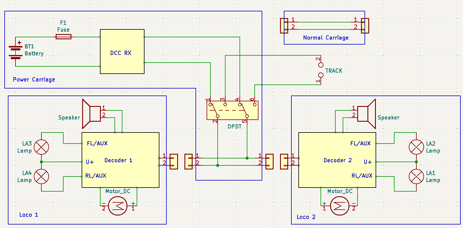

In regards to wiring, this is what I was thinking:

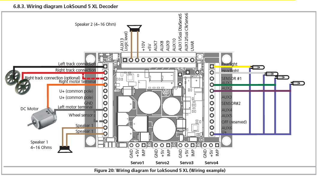

U+ is DCC input power minus around 2V - so if you have 14V of battery, U+ will supply around 12V.
All of the function inputs are switched via ground - the decoder switches that pin to ground to complete the circuit when you press a function button.
Good news on the battery :)
That is an amazing diagram, thank you. It looks like it will help immensely in getting me to understand more of what I'll eventually be trying to do.

As for batteries, best to not go down the travk charging route as you have already said. Removal for charging and storage if modern types a good plan but NiMh could live inside all the time as they do with my battery conversions with a socket for charge which swops between power to train or charge when charger pluged in. Fosworks do convenient wiring looms for this.
