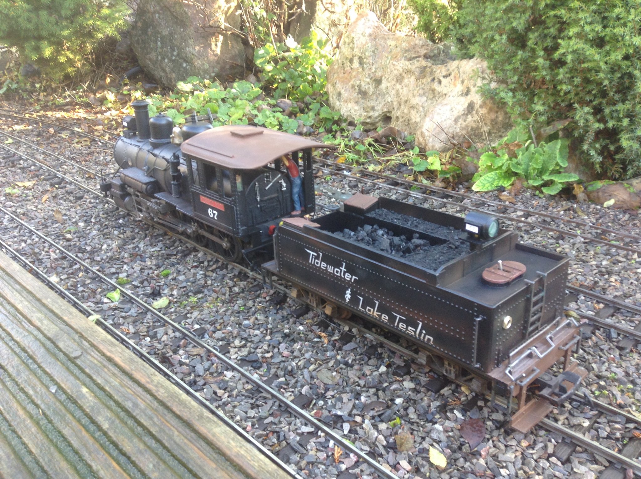

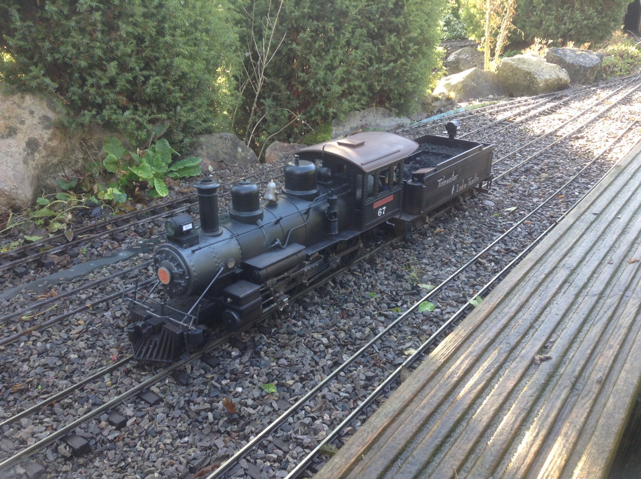

Just thought I'd pop on a couple of pictures of my latest loco build. Nothing fancy, it's an old Bachmann battery RC 4-6-0, fitted with a later 'Annie' chassis, with the lot converted to on-board battery RC. A few mods to the tender to better represent the coal carrying capacity! Thanks to Phil at RC Trains, who ironed out a few issues with the first pass of RC kit, it's now running well and providing all year round power for the 'Tidewater and Lake Teslin RR', image _3_.jpeg image.jpeg in my little piece of Alaska in North Wiltshire!

Looks good, and whereabouts are you on north wiltshire?
Only asking as I’m located in South Wiltshire

Near Royal Wootton Bassett

That was a great kit bashing engine, so versatile and with the addition of their new chassis and easy repair and fix, had mine since they first came out and at that time there were no replacement chassis so I put a LGB mogul chassis under mine and added a trailing truck and came up with a prairie 2-6-2, shortened the smoke box back to the first set of rivets and cut the boiler at the last band before the cab. After shortening the tender about an 1 1/2" wound up with a engine and tender that is only about 3/8" longer than my mogul. Really like the color on you smoke box, Bill.

Smokebox is painted with Tamiya Gunmetal
