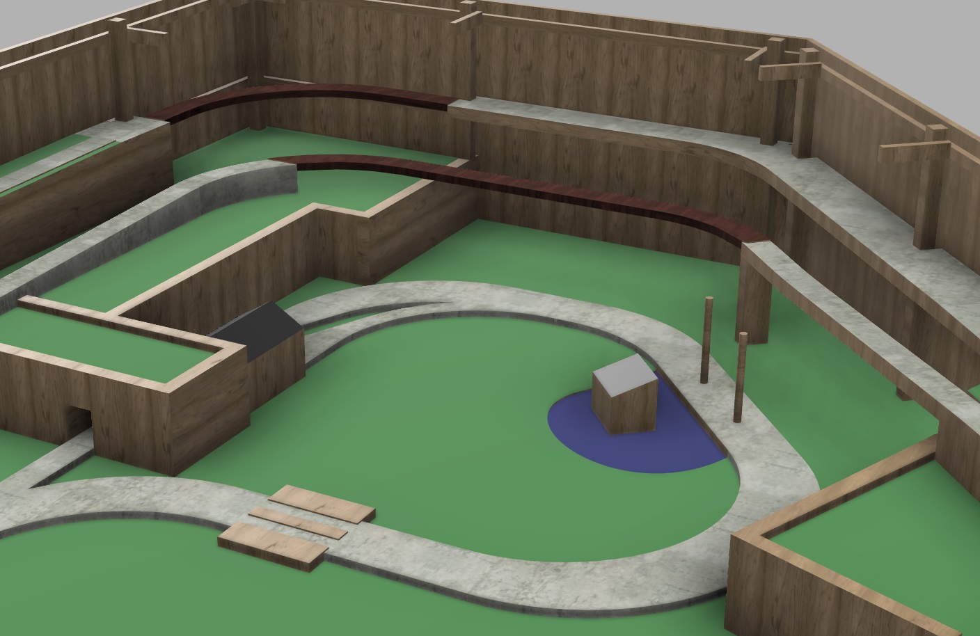

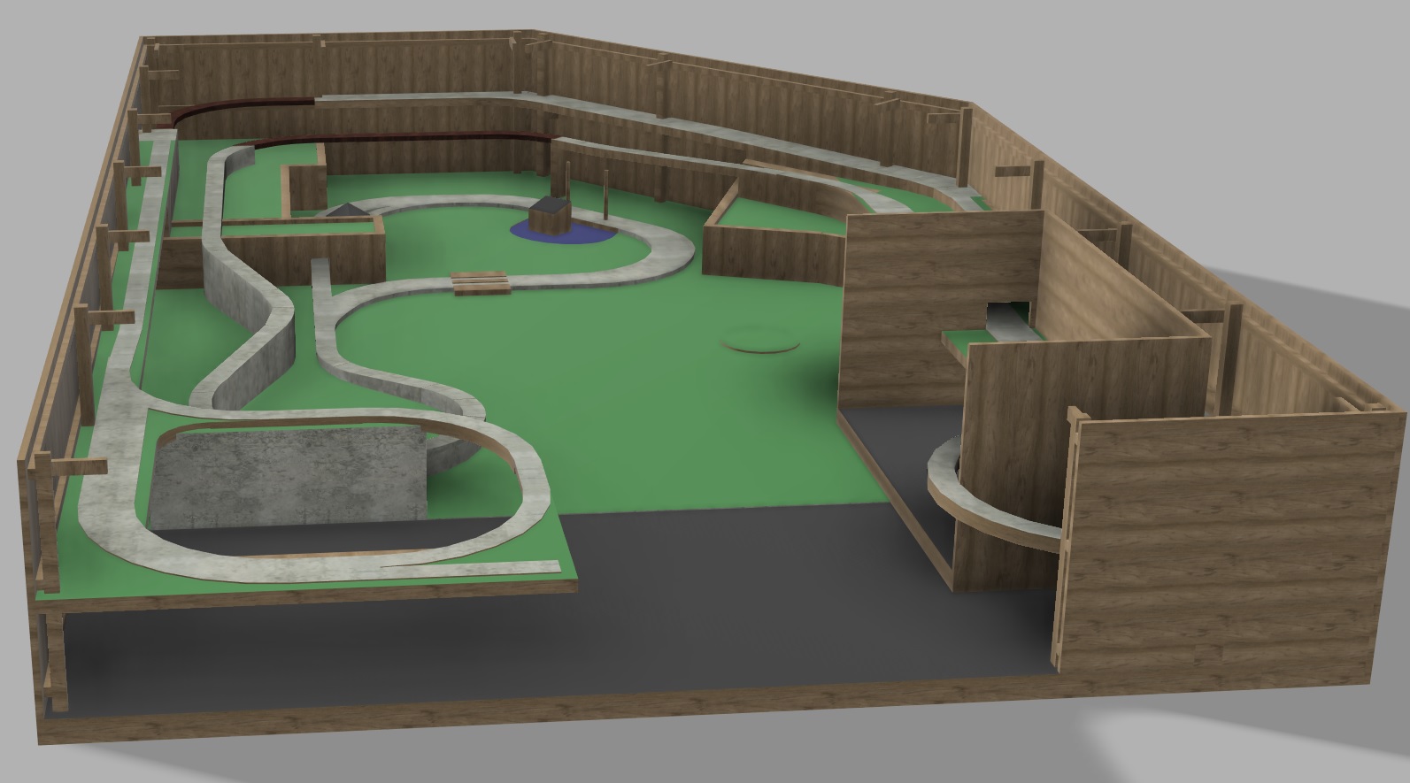

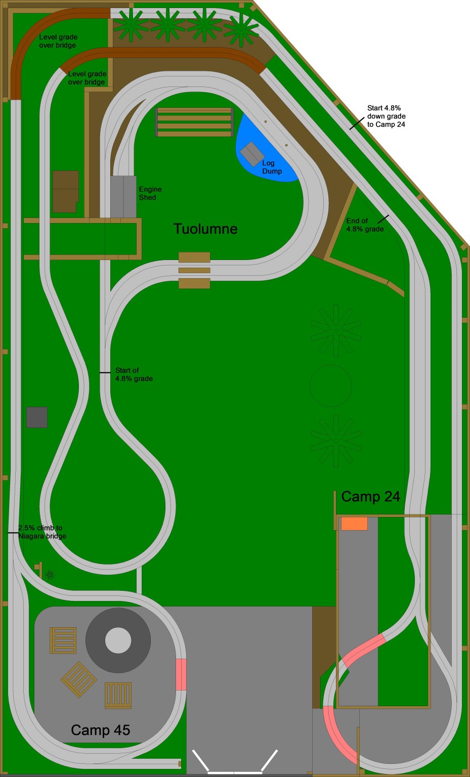

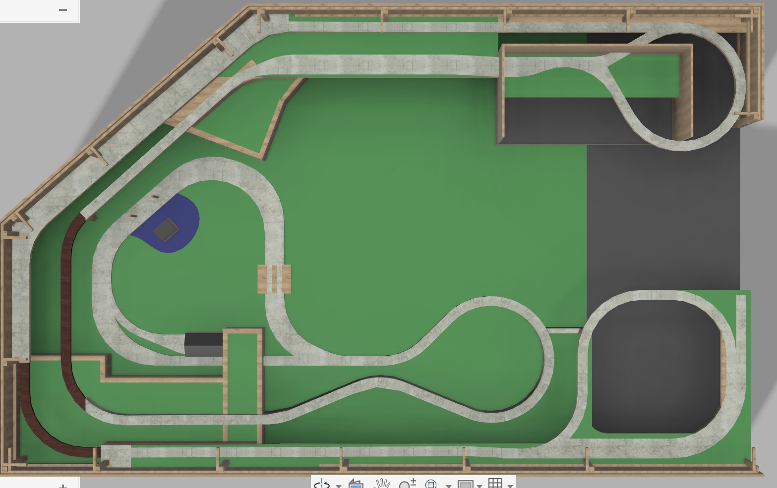

Please see below for a better idea of the plans, obviously there will be rockery areas, scenery & planting... and not a floating shelf along the fence but my Fusion skills don't stretch that far!
The two dark brown areas by the back fence will be shortened versions of the River and Niagara Trestles
Nothing set in stone for the mill pond more a place holder at the moment until I see how much space there is once the trackbed is down.
Fortunately all the gradients work out... Phew

Hi Korm, fortunately the Bachmann Shays are fairly big brutes and on the old layout I accidentally had a section of 1 in 15... Guess who messed up the maths for climbing up to the shed haha! The Shays managed the grade with 7 empty Skellies so I'm not too worried, my Stainz however will probably struggle.
