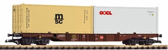

Recent G scale 2 Container wagen MSC/OCL has two containers with flat sides yet they are coded 42G1 and 45G1 respectively which means they should both have corrugated sides and be 40' containers.
My MSC container is the same yet it has corrugated sides and correctly coded G1.
It would take little effort for the people at PIKO to get these details right, you would think?
I agree with you about getting printing right, a little bit of research and perhaps using a picture would hellp. Though I worked for Freightliner Containers are not really my thing, but is is possible amongst the many thousands of boxes around that what is essentially the same box could not be both ribbed and straight sided?
