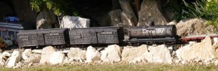

It has been a long time but I forgot to post up a photo of the modified rooves
Stock cars now with modified side roof walks...the Bachmann plastic ones are gone and replaced with metal grab-irons

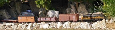

To round up the thread a few photos from the summer to show the stock cars in action doing what they are meant to do.
All three are now chipped with ESU decoders so that they can run on DCC or DC.
The parameters have been set to mimic the acceleration/deceleration characteristics of the Arsto block in RS3 and also the bachmann Anniversary 4-6-0.
In the photos two converted stock cars are being used to `help` an RS3 with a decent rake of cars, up the incline and to help to hold her back on the down slope.
The train was being run with DC and another train, with a GP9 heading, was on the same line. They were balanced with load so that it took along time for one to catch the other.

Wide view showing whole train with the converted, motorised stock cars at the rear
