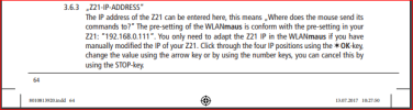

After starting the control centre, switch on the WLANMAUS. Then under Settings ➔ Reset ➔ System settings, the mouse is reset once, then restarted and guided through the guide.
Select the network mXion MZSpro and type in the password, the display always shows capital letters, but ONLY if there is an arrow in the display (shift key).
Password is MDELEC1207 (switch off Shift again for numbers, arrow goes away. The arrow can be seen at the bottom right next to ABC!).
**Then the WLANMAUS connects to the control centre, the pause symbol and the double arrows flash after the connection.**
Then you have to change the IP to 192.168.111.111 under Settings ➔ WLAN ➔ Z21-IP address. Then everything works as expected. If the control centre has been switched off, the mouse also has to be switched off, the mouse does not like it when the WLAN breaks down and then comes back.
Therefore, it is better to restart the mouse when restarting the control centre.

I have followed that process - could it be that the MD mXion central station has a different IP address to a Roco/Fleischmann Z21 central station though ?

Thank you for your efforts.I have followed that process - could it be that the MD mXion central station has a different IP address to a Roco/Fleischmann Z21 central station though ?
The MD central station is set to 192.168.0.111, this is it's network address, it appears that the Z21 is looking for a connection to a central station on 192.168.111.111, which it wont find.
To confirm this, by using a computer or a mobile phone with the Z21 app on it, to connect to the mXion MZSpro, (SSID) and the correct password, if they both connect, then the Z21 needs to be changed to look for the correct address of the MD unit which is on 192.168.0.111.
The Z21 app, default standard Z21 IP address from the app is 192.168.0.111, which matches the IP address for the MD CS.
The documentation is somewhat confusing, as it refers to both the earlier older original version of the documentation on the Z21 and the new version of the documentation of the MD and Z21 app , the result of a couple of phone calls, with the view to re writing the documentation for clearer instructions, that matches the relevant documentation.
Now have read and re read NINE different sets of documentation for this setup, and in their own way they are all correct, the confusion lies with being supplied with correct equipment in the first instance for the correct implementation.
Part of the issue appears to be the bundling of TWO different and independently supplied pieces of Wi-Fi equipment, with the correct instructions for an equally different piece of equipment, which is not at all helpful when trying to configure all the pieces to work together.

Did have problems getting mine set up, which stemmed from inputting the password correctly.
The minimaus screen always displays as caps never lowercase. The password however HAS to be in caps so make sure you input the password correctly.
As for the IP address I just did the renumbering as per the instructions and it's worked fine since.

Sounds like the problem I had. Make sure you input the password as caps. Then go through the IP address thingy.
