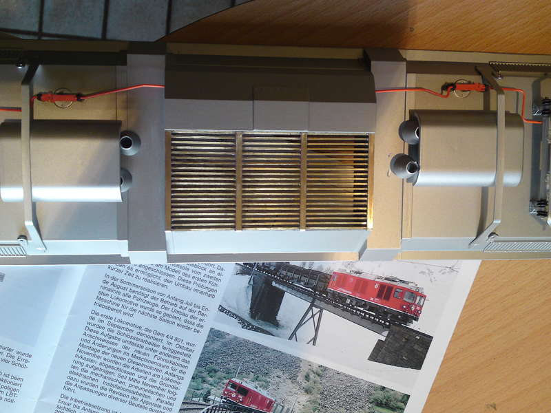

It was necessary to cut whole in roof of housing for the cooling system of the engine

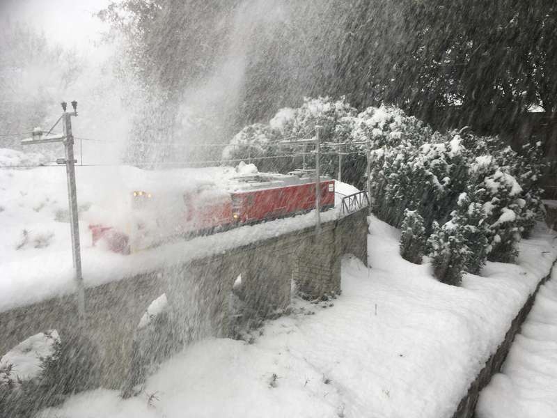

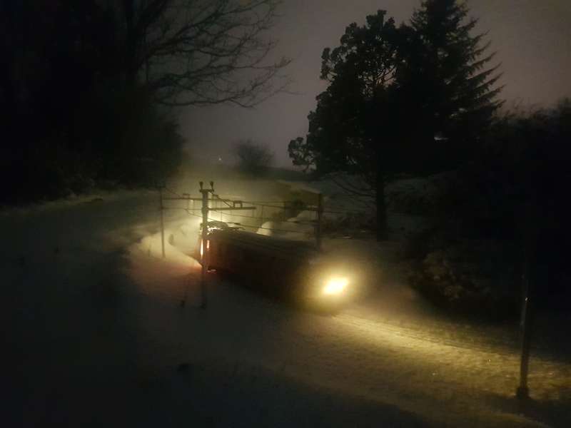

A typical scene of work in the darkness of winter
