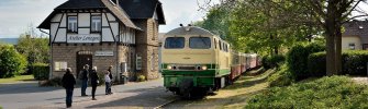

Yes - Piko BR 218 is definitively standard gauge, scale ca. 1:27.
Some german modelers covert it into a 1.000mm NG Brohltal D5 (built by HENSCHEL, Type DHG 1200 BB - re-imported from Spain / FEVE), and it fits!
The original (just data):
Brohltalbahn = Vulkan-Expreß - Diesellokomotive D5

The original in action:
