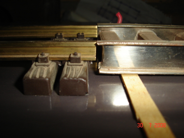

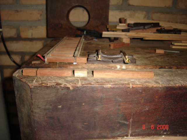

Please tell, what is a curtain rail ? Looking at the second photo, my mind cannot get how the ties and rail work together. The ties look like three separate pieces.

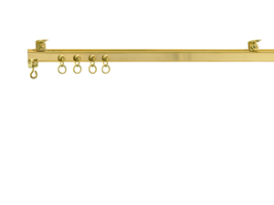

Old curtain rail is like 'H' section girder with rollers. - Think miniature overgead hoist:

Back in the day Curtain Rail used to be I beams with little rollers that sat either side with loops to hang curtains on, all the bits tended to be brass.. Probably disappeared in UK back in the 70 when Plastic replacements became the norm. Much prised is the I beam for may jobs such as Crane Beams and as here track.

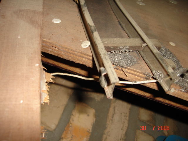

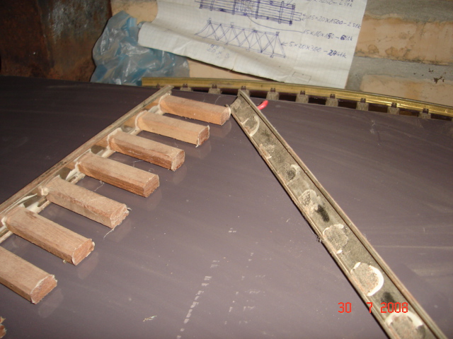

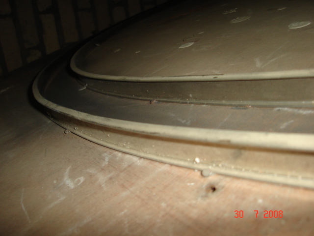

here in paraguay i could buy cheap tin rails, that were either bronze- or tinplated. - and cheap! (about $0.20 per yard of rail)
a friend with carpentry tools made me the ties from offcuts. (cheap too)
main difference between out- and indoors was the glue used. outdoors i used the german UHU, or the "3M" goop used for motor sealing, indoors just white wood-glue.
(hindsight: for outdoors, now i would drive a thin nail through the tin-rail into the middle part of the tie every tenth tie, or so)
btw: if there are no more metallic curtain rails... for battery driven locos the plastc rails might be even better. no rust, paintable. just using a tacker, to connect rail and "middle ties".

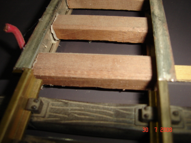

just that. the middle piece of the "tie" for the correct spacing. the outer pieces were just for optics.

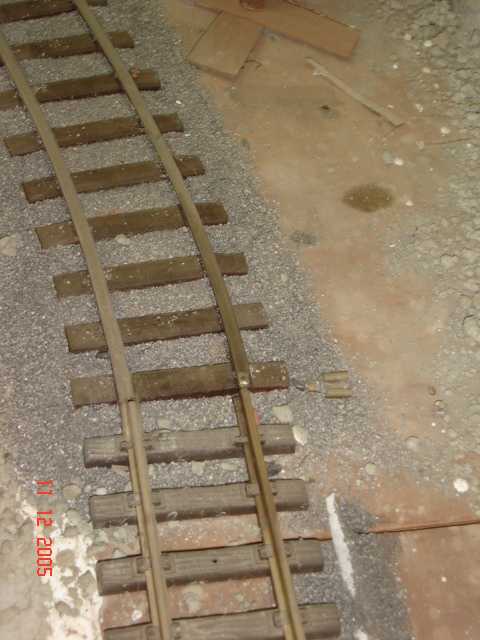

cause in the old days the next shop to develop negatives, was 300miles/500km away, i got only some pics from the later indoor layout:

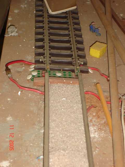

for hidden track, like in tunnels or shadow storage it is easier to just nail the rails to a baseboard.
but where visible, it is better, to pre-bend the rails, then glue the middle parts of the ties, throw the track on the dirt, anchor with some 2 or 3 inch nails, and connect the track with screws or pop-rivets.
