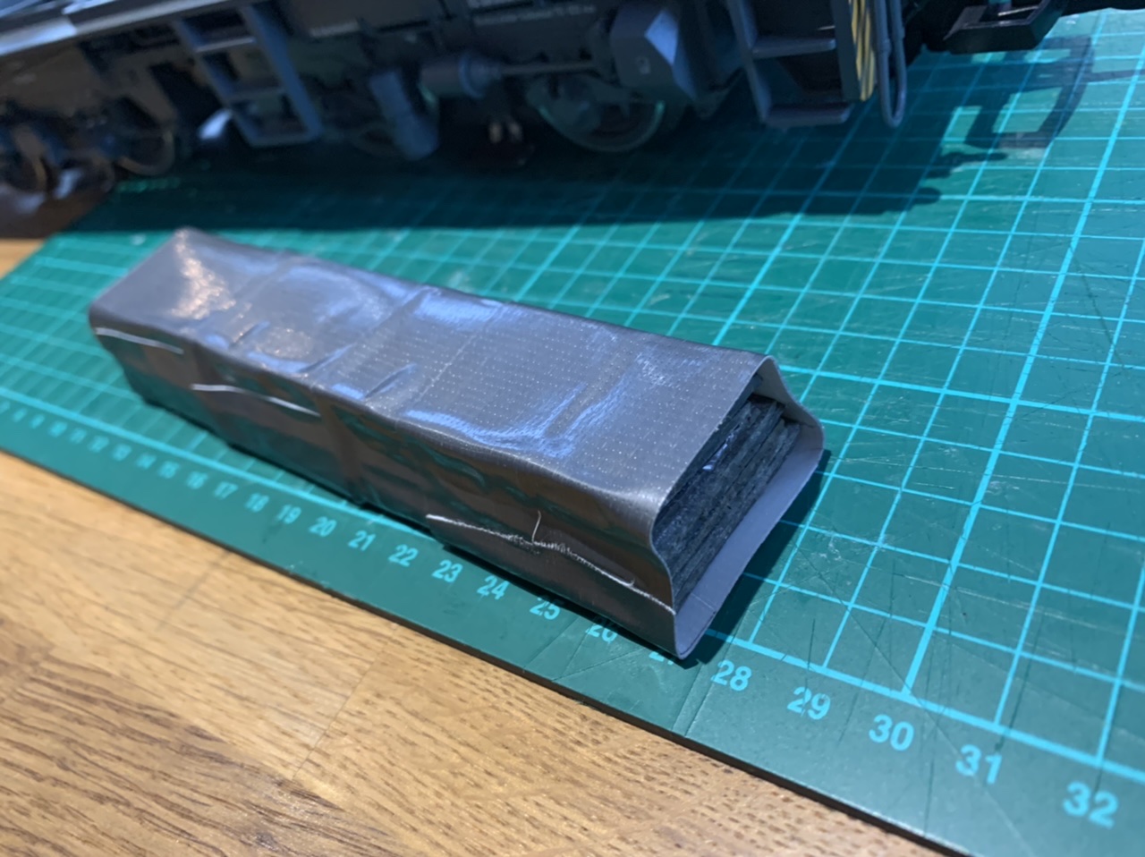

So, using gloves to handle the roofers lead roll and cutting it with HD scissors I cut a kilos worth of lead to put the overall weight on a par with the red VL21 (formerly a V52 but redesignated to the number the StLB gave it when it ran in Austria).
I wrapped the lead in duct tape prior to install in the loco. 0814CB0E-1641-4BE7-B2B5-1E0519B75173.jpeg 0160AFA3-8E1F-4C58-A9E3-C8E41837D942.jpeg
