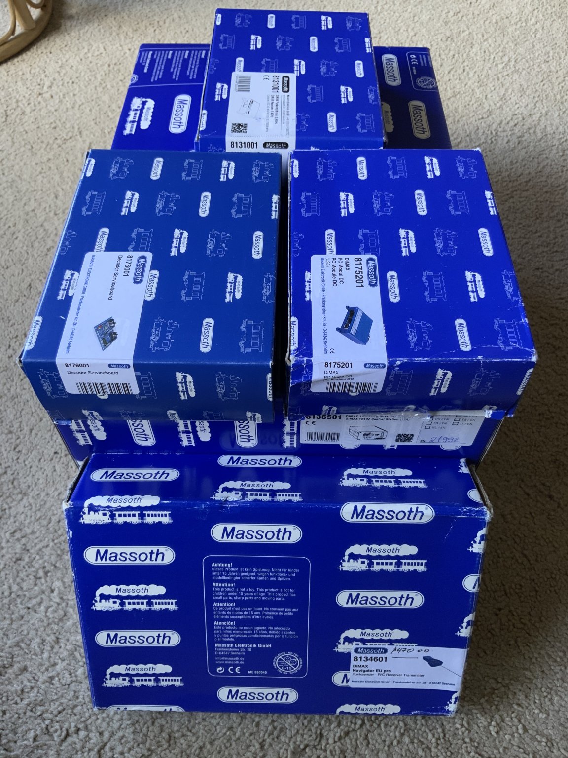

A local retailer recently had a relocation sale and offered a fairly substantial discount across the board on their web site listed items. I've been wanting to get into DCC for a while so I had a look at what they had and saw some good prices on Massoth kit.
I've ended up with....
8136501Massoth DiMAX 1210Z Central Station
8131001Massoth DiMAX Receiver 2.4GHz
8175201Massoth DiMAX PC USB
8176001Massoth Decoder Serviceboard
From another retailer I acquired...
8134601Massoth DiMAX Navigator (inc Transmitter + EU)
And lastly I found this for a good price on eBay France...
8135501Massoth 1200T Power supply
As as I understand so far, this kit should set me up on control side of a DCC installation.
Right now, all I really want to do is be able to use it with the MTS equipped LGB locos/railcars I have on hand (probably about a dozen). Later I will need to replace the Dynatrol analog CC system that I have in another dozen of so older (pre-MTS) LGB locos, but right now that is not a priority... those locos have all the pre-work done for Command Control, so it will be just a matter of fitting DCC decoders in place of the Dynatrol receivers.
My initial questions are these.....
1. Am I likely to need any other DCC kit to get started?
2. Since I will only be playing to start with and don't intend to run more than two locos at once, is it OK to use an LGB 50110 transformer 20V AC outlet and a bridge rectifier to supply DC to the Massoth 1210Z Central Station? (The Massoth 1200T power supply has shipped from France but it may take a while to reach Australia.)

From what I can see with the exception of a transformer you are set to go. My recommendation would be to wait for the correct transformer. Someone may pipe in and say your suggestion is ok but I would wait.
There may be another solution to source a suitable transformer as many have been using various kinds since Massoth and others were curtailed from incorporating transformers in their products some time back now.
I wonder if there is a local forum that may give ideas for you?

I agree with Dunnyrail, wait. There are all sorts of good reasons that say your suggestion will work but better safe than sorry. Your old LGB unit is probably a transformer (using coils of wire to reduce the voltage). The Massoth unit is a switched mode power unit - this chops on and off the full voltage extremely rapidly so that the base unit only appears to get a reduced a voltage.
Anyway - your ready to go. There are several members here who use and love their Massoth kit - it really is up there amongst the best. When buying new decoders, if you go for sound (I would) - get your dealer to load the correct sound files for the intended loco. Massoth is one of the few system to use actual digital recordings from the original locomotive.

Congratulations.
Firstly, the EU+ Navigator (8134601) will not communicate with the 2.4GHz receiver as they use different frequencies. You will either need to change the transmitter in the Navigator to a 2.4Ghz version (8131901) or use an older Receiver (either 8133101 or 8133001).
If you change the Transmitter you may need to upgrade the firmware in the Navigator to support 2.4GHz operation.
DONT use the LGB transformer - The latest incarnation of the 1210Z ONLY likes DC input - the LGB transformer supplies AC and you wont get the 1210Z fixed under warranty!
The 1210Z and the PC Module should have been supplied with a USB stick containing the Massoth Service Tool. If not, then send an email to hotline@massoth.de giving the serial number of the 1210Z or PC module and they should provide a link to download it.

Congratulations.
Ah, thanks for that.
DONT use the LGB transformer - The latest incarnation of the 1210Z ONLY likes DC input - the LGB transformer supplies AC.
A bridge-rectifier turns AC into DC! There is one inside the LGB 5A controllers.
Nowadays-bridge rectifiers come in compact packages, and cost a couple of quid.
For sure use one at your own risk,...don't come crying back when you kill your nice 1210Z and complain about the circa 100 eur repair bill plus shipping to and from Germany.
