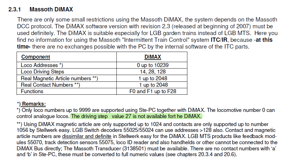

I use Stellwerks software to control everything. I do not have a Navigator. Stellwerks has the option to select the DIMAX as the central station.
Generally, everything works fine.
My trouble is trying to get to 28 Speed steps.
I have a locos using LGB 55021, LGB 55022, and the Massoth XL eMotion. decoder. I used the Massoth Service Tool to set the CV29 for 28/128 speed steps.
I define the Loco in Stellwerks as having 28 Speed Steps.
When I try to operated the software it does not recognize the 28 speed steps.
My question: Do I need to first set the speed steps or each Loco number in the 1210Z using a Navigator?
