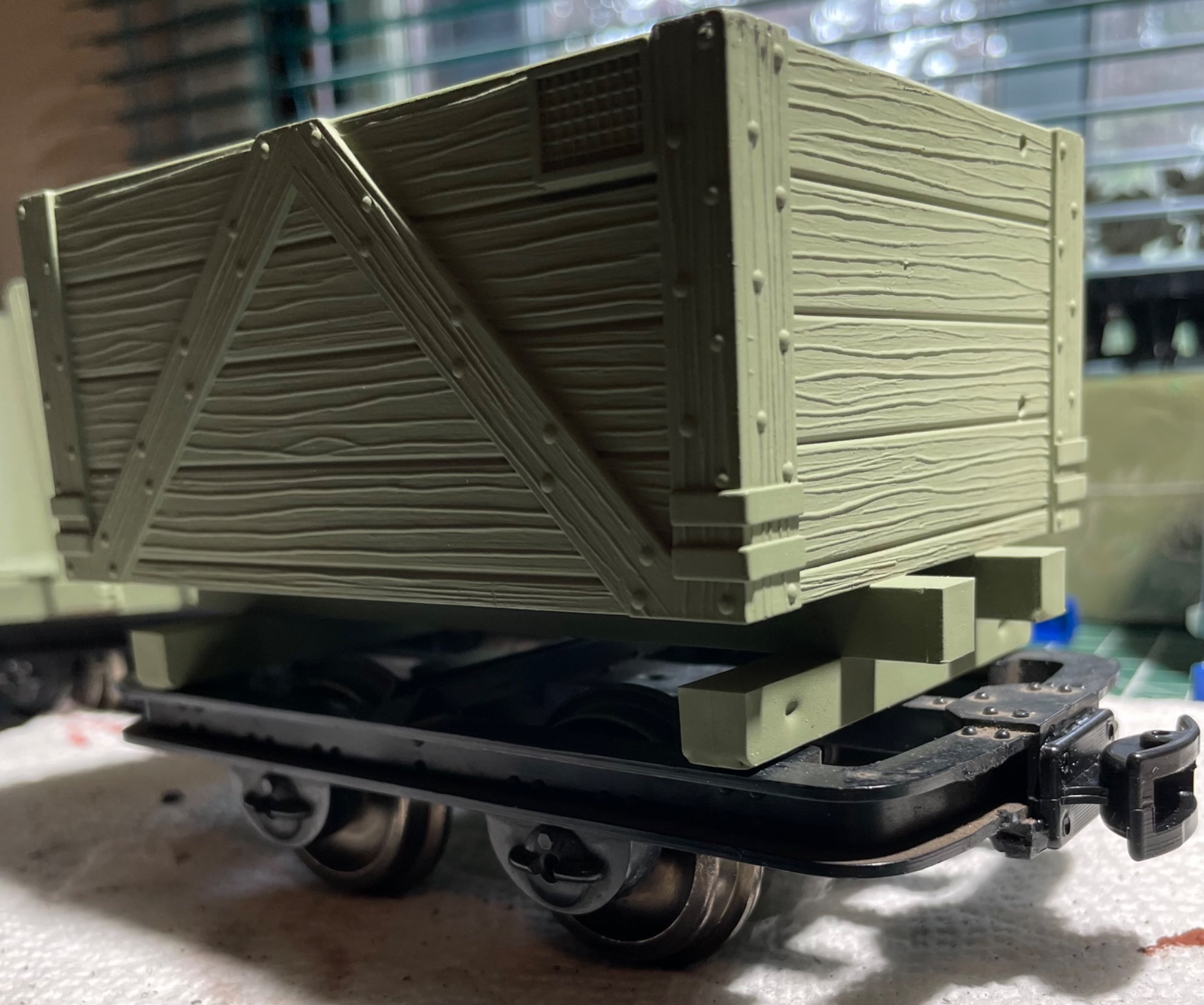

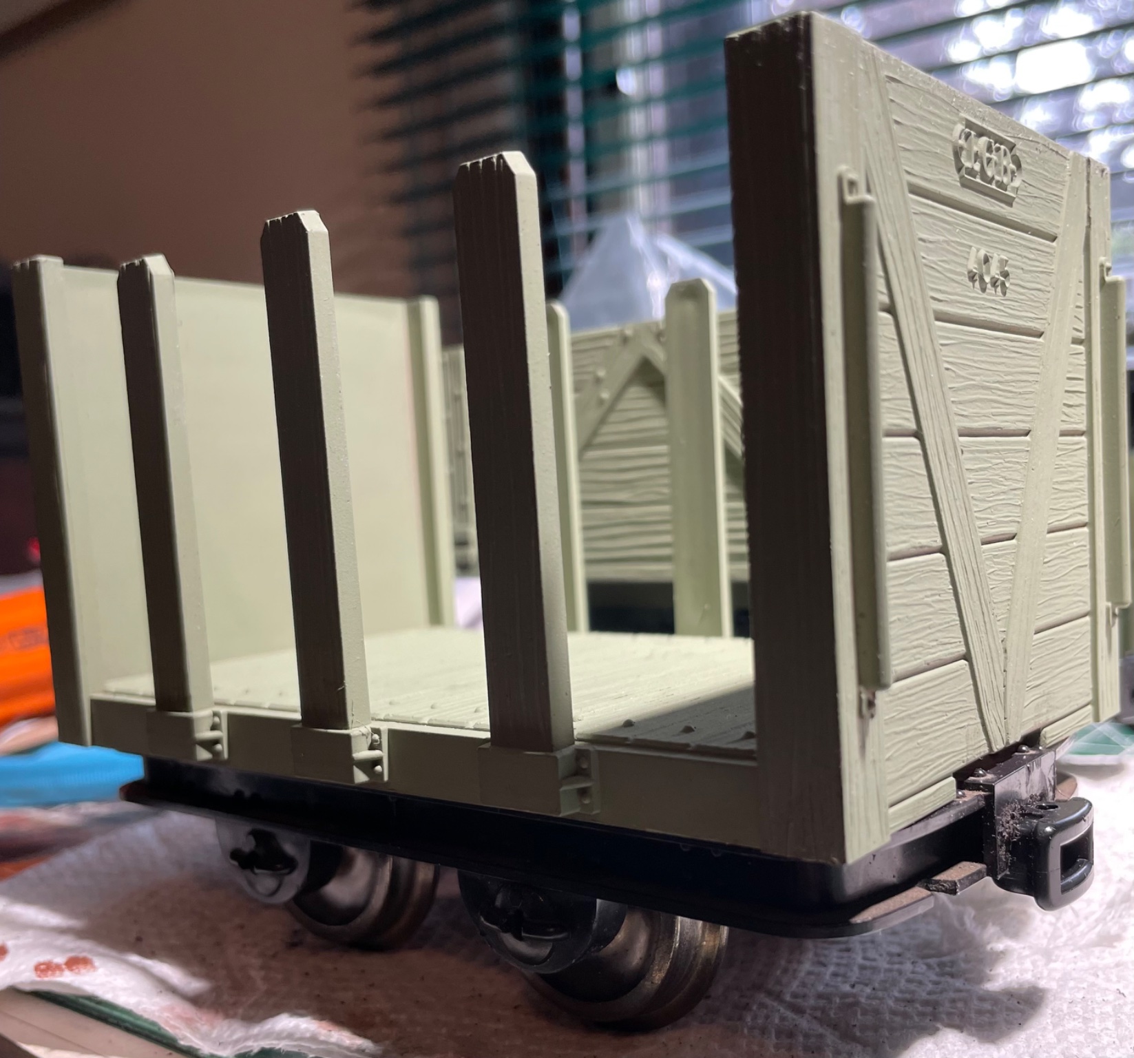

I was given a pair of ancient LGB Feldbahn wagons and decided to bash them.
IMG_0399[1].JPG Bachmann metal wheels on both, and LGB link and pin couplers on one wagon that had removable hook and loops.

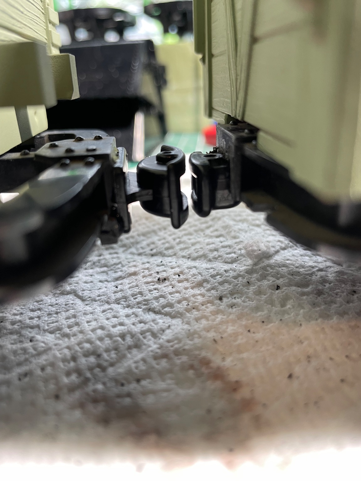

IMG_0401[1].JPG The other wagon had loops built into the frame, so I sawed them off and applied Pasidump link and pins. Debating whether to rely on adhesive alone or use short screws to secure the coupling "cups".
I would use screws for a good mechanical connection.
Technically, I don't think those are LGB Feldbahn, which have tiny wheels and square chassis. But I have used those rounded steel frames for a variety of projects. One involved gluing Faller eTrain hopper tops on the LGB chassis.

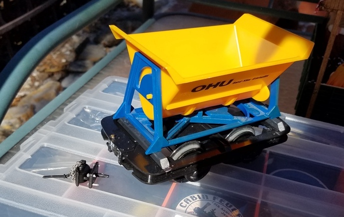

I used Pasidump link-and-pins, and I used a screw into the frame from the 'cup'. I think this pic is one that didn't get a screw - maybe that's what persuaded me to use them! Note the short chain to the pin - otherwise they just fall on the ground and disappear.

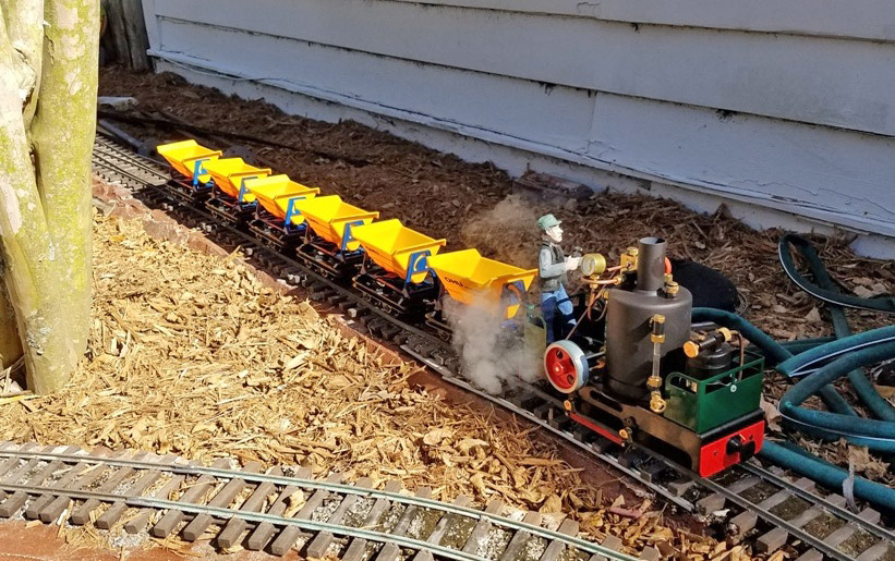

Here's Bruno with the 6 tippers that fit in my box.
