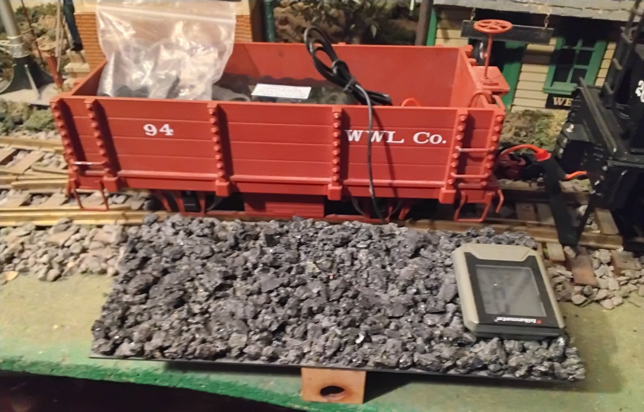

That and, yes, I have an "idler car". My "idler car" is very multi functional ! Its base is a modified Aristocraft 20ft gondola. It firstly acts as a battery wagon for my Climaxes and the Shay 2 truck, full 16 cell AA NiMH pack. It is equipped with kuckle couplers at both available heights used in lager scale. Also - link and pin, hook and loop and UK 16mm scale dumb centre buffer and chopper types. It has all those so guests on my line can couple just about anything to anything as they are all individually mounted either end. If that is not enough it has an adapted cycle speedo fitted, set to translate at 1:20.3 scale speed. 2 pi R was involved in that calibration. I like to keep a steady 25 mph with my rodded locos :) Before I went all battery it acted as regular "in session" track cleaner using LGB's 50050 bolt in attachment, it still can. It's a short wagon so can be used to ease the passage of some larger stock when interposed to add a little bit more articulation. Max

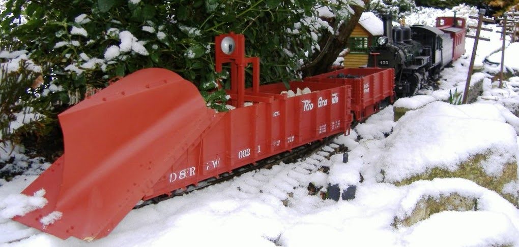

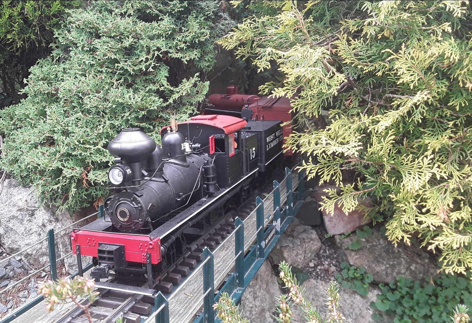

3 truck Shay with modded Kadee coupler to operate at NMRA Fn3 coupler height standard. Hauling NAMRA coup.er height standard stock
The very useful "idler car" with my 2 truck Shay. Fn3 height coupling. Bag of couplers always showed and ready.
