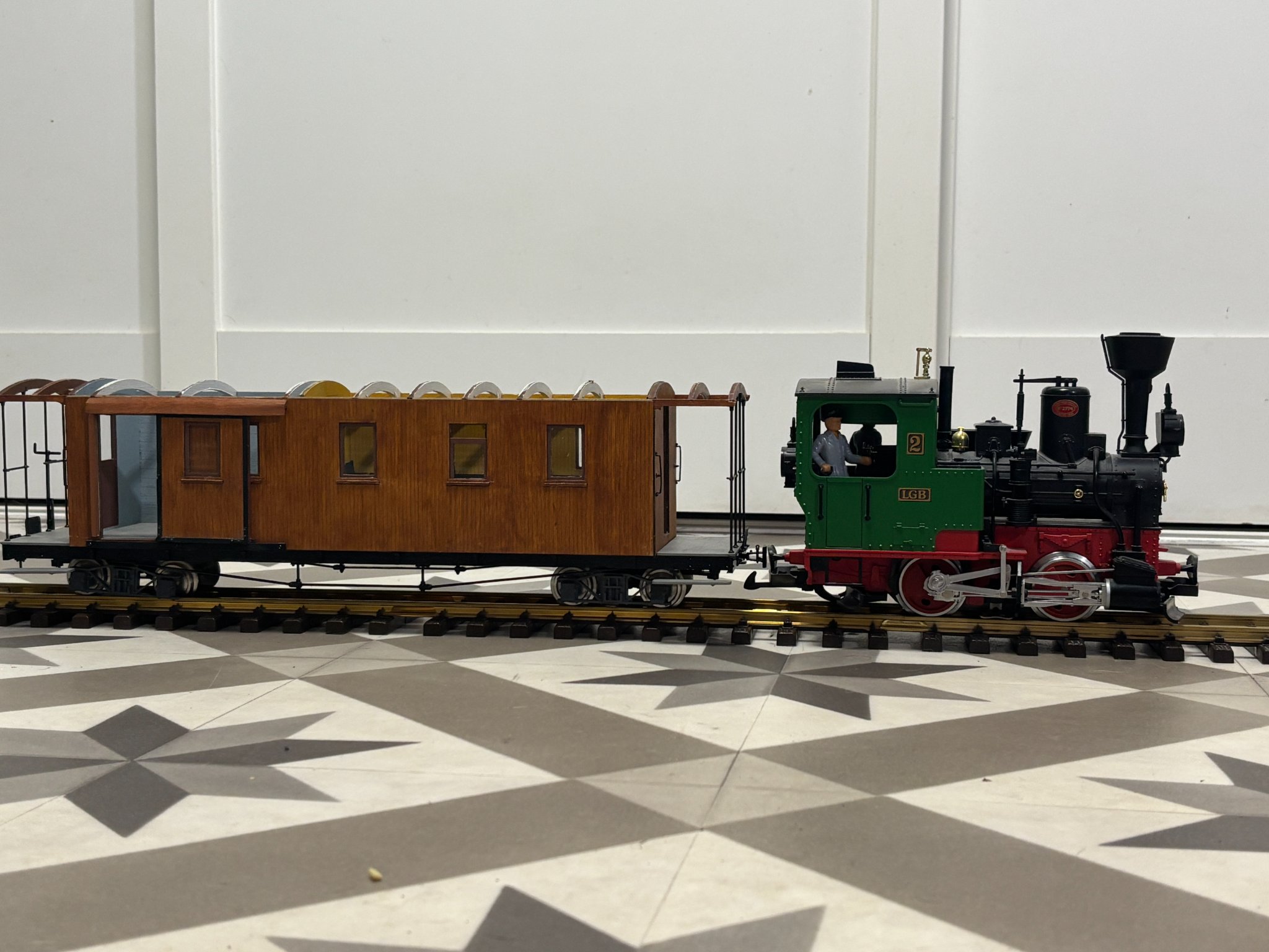

Thank you very much for the information! It certainly is very useful. And thanks for the link to the other post, which I hadn't spotted when looking for information on the matter. I didn't know that LGB had made that many variants of the U Class locos. However, looking at various copies on the Internet, I can tell whether they have got the high roof or the low roof. It seems like the hight (for the high roof version) and width is quite similar to Stainz (?).
It is just an impression that I have got, that anyone who is running LGB locos, has got at least one Stainz on the track... Besides of that, I have got one myself, and as I think that the Stainz doesn't look too large in front of my carriages, it is interesting to compare other locos with it. It seems that the U2 with the high roof will fit well.
My prototype railway line had small Mallet locos like the ones that Decauville used at the exhibition in Paris in 1889. It sure would be nice to run Mallets on my own ittle line, but the smallest Mallets I have found in G scale, are the HSB ones. As far as I can gather (without knowing the exact measurements), they are too big for my use. That is why I am looking for other locos that can look fine together with my carriages. I am happy with good ol' Stainz, but want to have a larger loco too (larger without being taller or wider....). So, this is where the U2 might seem to be a good choice. According to the information you gave me, the width of the U2 loco is even closer to the carriages (96 mm) than Stainz.
