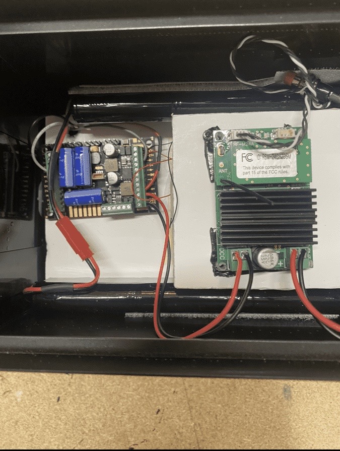

The loco has been converted to battery DCC radio control with sound, using a Zimmo decoder and Train Engineer Revolution transmitter and receiver.
I was told TE Revolution will not work with ZIMO, no SUSI which ZIMO needs.
How do you do it, and which TE Revolution exactly are you using?

Hi Rrentren,
I use the Train Engineer 59000 DCC 5A
And for the K27 & K28 the Zimo MX699KS.
The receiver is wired directly into the decoder.

Thanks! Now I understand.
My TE Revo 57002, OnBoard RX w/sound couldn't work.

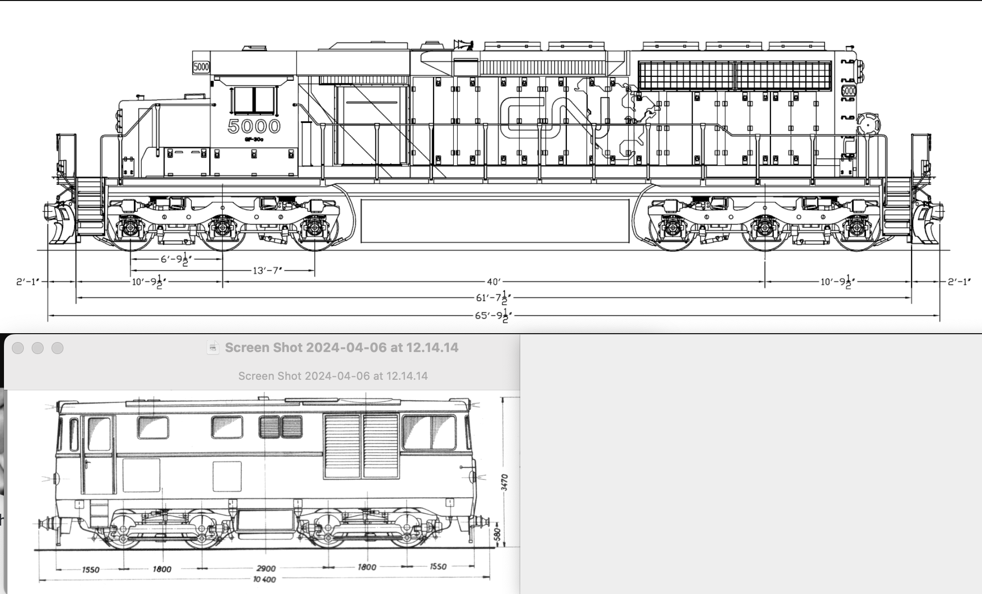

Problem with my TE Revo electronics is the sound, heavy N.Am diesel, while mine ought to be emitted by a 2 1/2ft Austrian narrow gauge model LGB 2095 (see illustration: roughly 65ft or about 20m).
