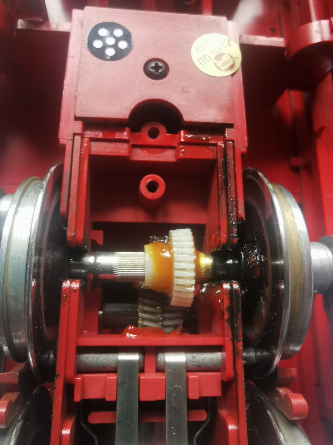

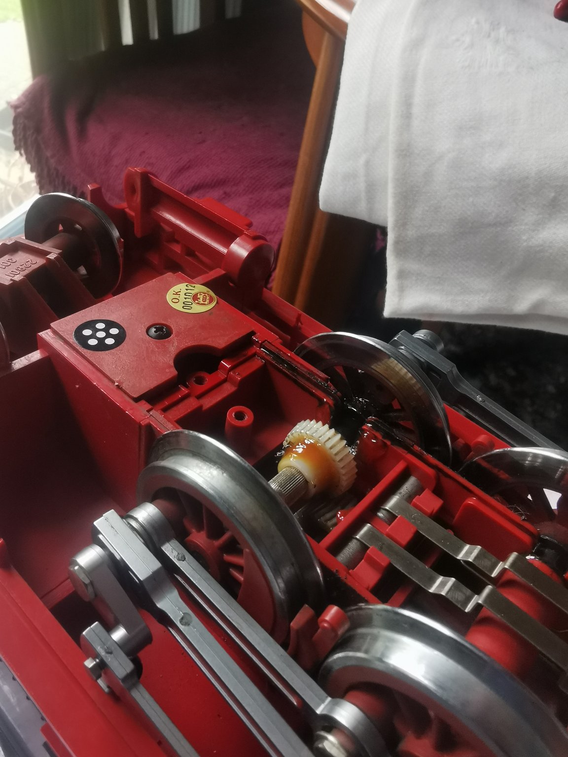

I will count / photo when back home this evening..Most of the locos have the same diameter wheels but the number of spokes varies and the length of the con rod pin shaft. I have a box a spares somewhere but not sure which variations I still have left.
It is the rear wheelset, so the longer pin shaft.Most of the locos have the same diameter wheels but the number of spokes varies and the length of the con rod pin shaft. I have a box a spares somewhere but not sure which variations I still have left.
As the pins are removable the gear wheel with wheels front and rear are the same. Older models had removable wheels so you only needed the axle and gear. Do you have to force the wheel off with current versions? If so that will make quartering tricky.It is the rear wheelset, so the longer pin shaft.
The wear to the teeth, is shown to better effect, in this shot:
The teeth should be square..
