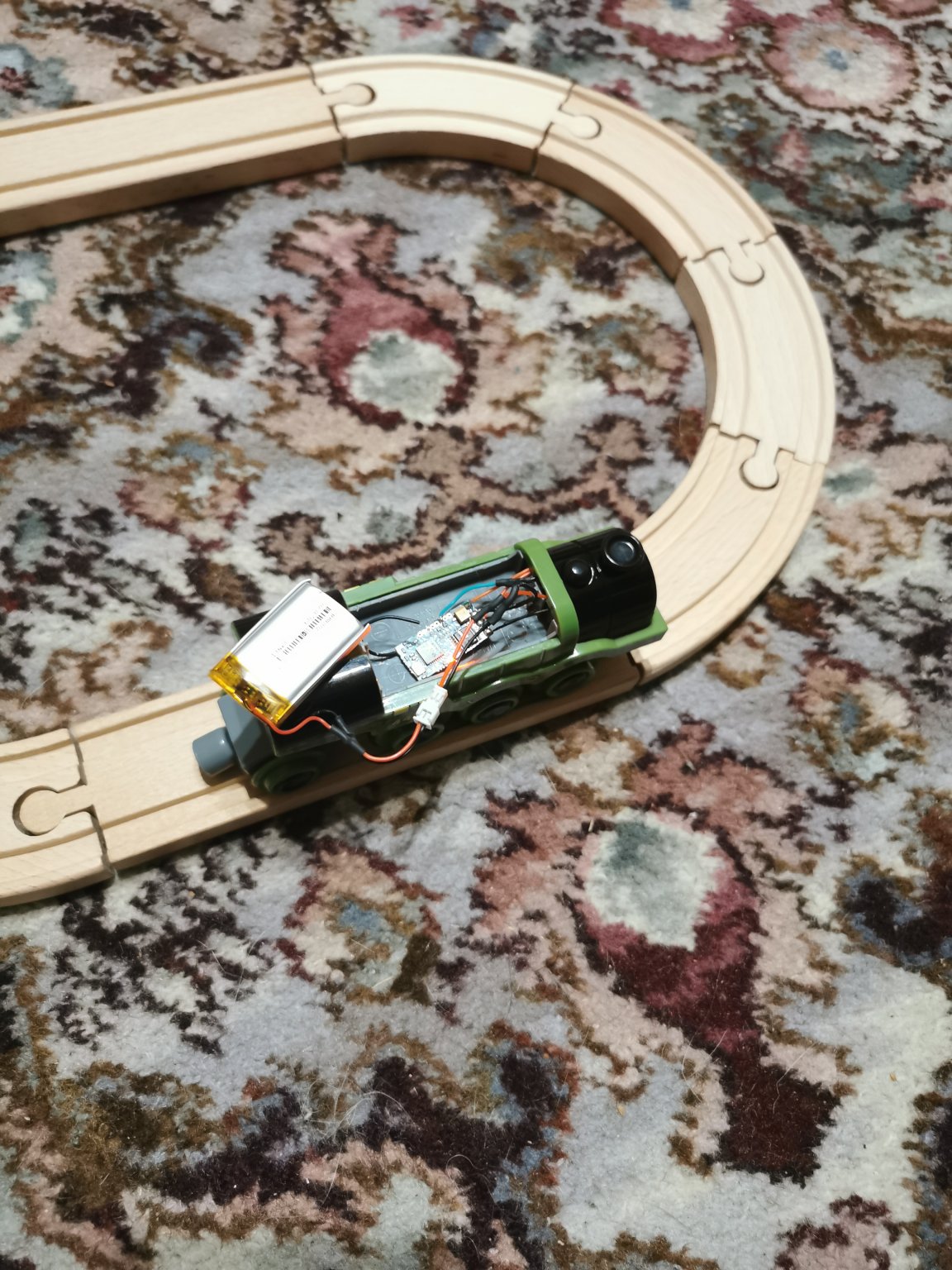

A battery box on top of a set of crude wheels, with sundry bits fore and aft.
I grew up with Lone Star:Brilliant, one of the good things about having kids , os that you can play with Brio ( or it's cheap alternatives)
I recognised the wheels in the first photo but couldn't remember the name of the brand.Brilliant, one of the good things about having kids , os that you can play with Brio ( or it's cheap alternatives)
Yep, we all know that the original is a 4-6-2Correct:
Some people will find this really offensive!
Especially if I turn the (horrible!) sound on....![]()

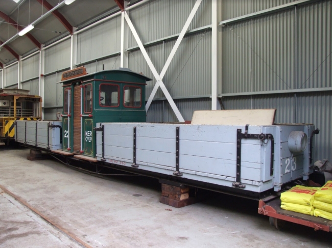

East coast, under the wires, rare/odd, still around. Spends a lot of its time sitting on oil drums...The burning question is, what are they going under![]()
Although looking at photos, they wouldn't look out of place under the Cabbage...East coast, under the wires, rare/odd, still around. Spends a lot of its time sitting on oil drums...
A Deltic?East coast, under the wires, rare/odd, still around. Spends a lot of its time sitting on oil drums...
After Bonner Corner...A Deltic?![]()
Sounds good, in which form before or after the Bonner corner incident?
I have an itch to model a Paddle box and saw the bogies on this website that would suit 32/3, but need to clear a few projects first!!
Rude not to, just requires a trolley pole.Follow my thinking...?
You beat me to itWatch it Patrick.. I might want to commission some of these!

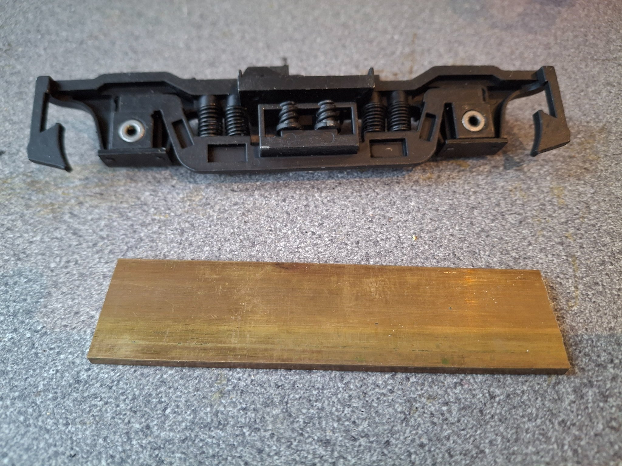

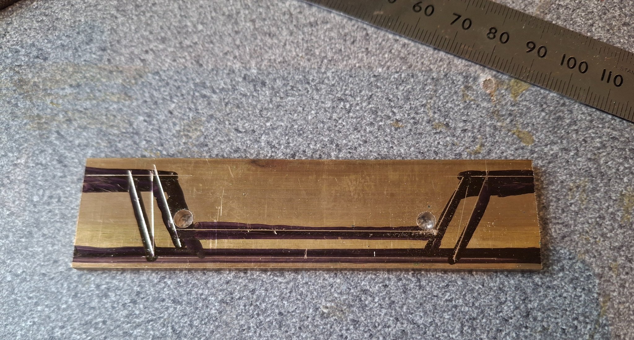

Looks pretty good to me! How I miss the cutting, turning and milling of my apprenticeship! Although not so much the filingA few weeks ago I called in at GRS, and amongst the bits and bobs that I bought was a bag of bits that looked like a pair of hefty power bogie frames: no motors, no wheels. Being thrifty (oh, all right then, tight), and having a project in mind, a price was arrived at; it turned out the bogies were made by USA Trains.
Closer inspection at home showed that there were parts for one complete bogie, and almost enough for a second one, but that, vitally, a side frame and springs were missing. So at least I knew why it was cheap...
With today being unrelentingly wet, I had a measure up and went to Chronos, my local model engineering supplies erm, supplier, and bought various sections of brass.
First job was to centre a piece of 7/32nds square bar in the four-jaw chuck, drill it Ø2.5mm, and part off two pieces.View attachment 348405

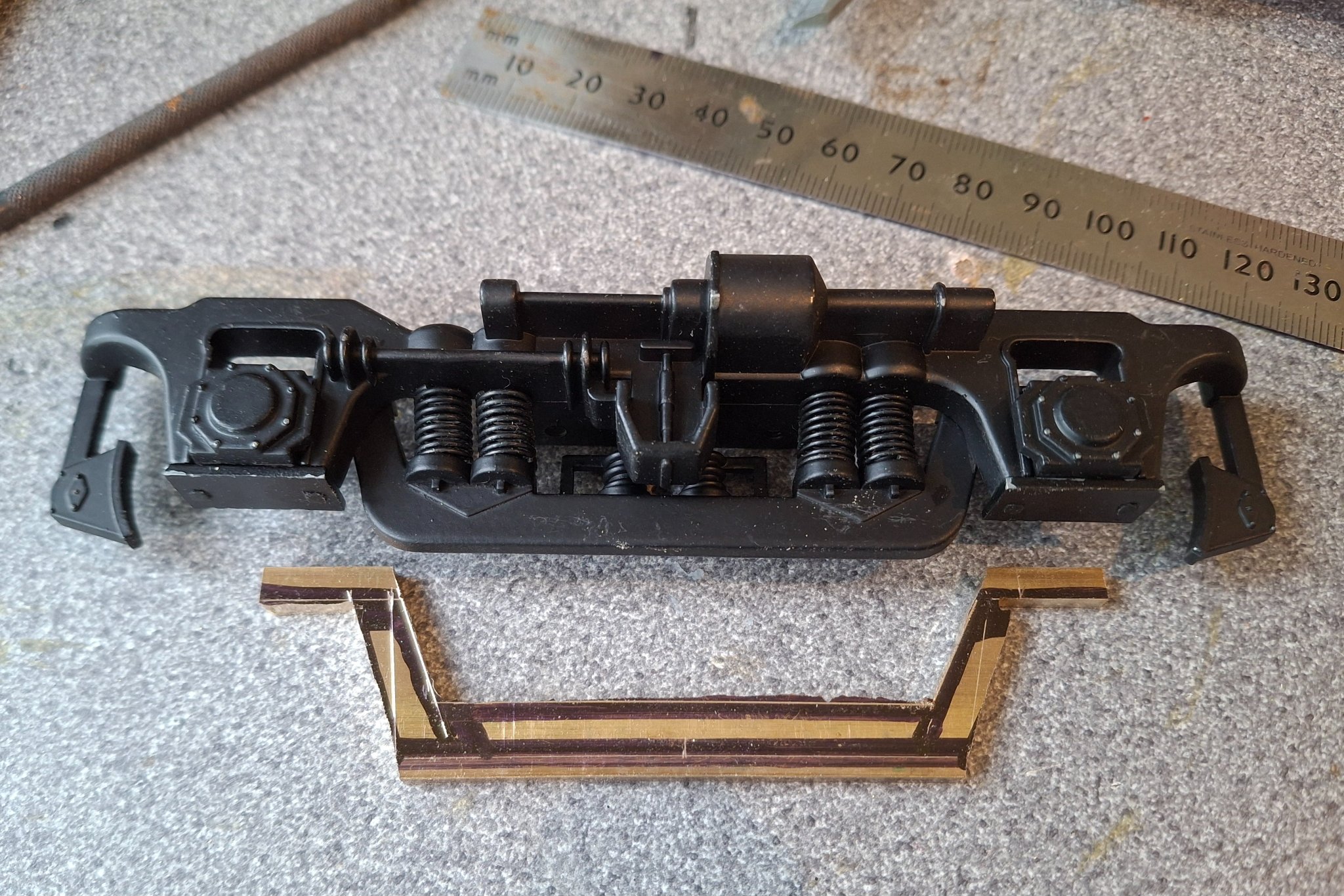

Next, a piece of ⅛ x 1" brass was cut to length,
marked out, and drilled:

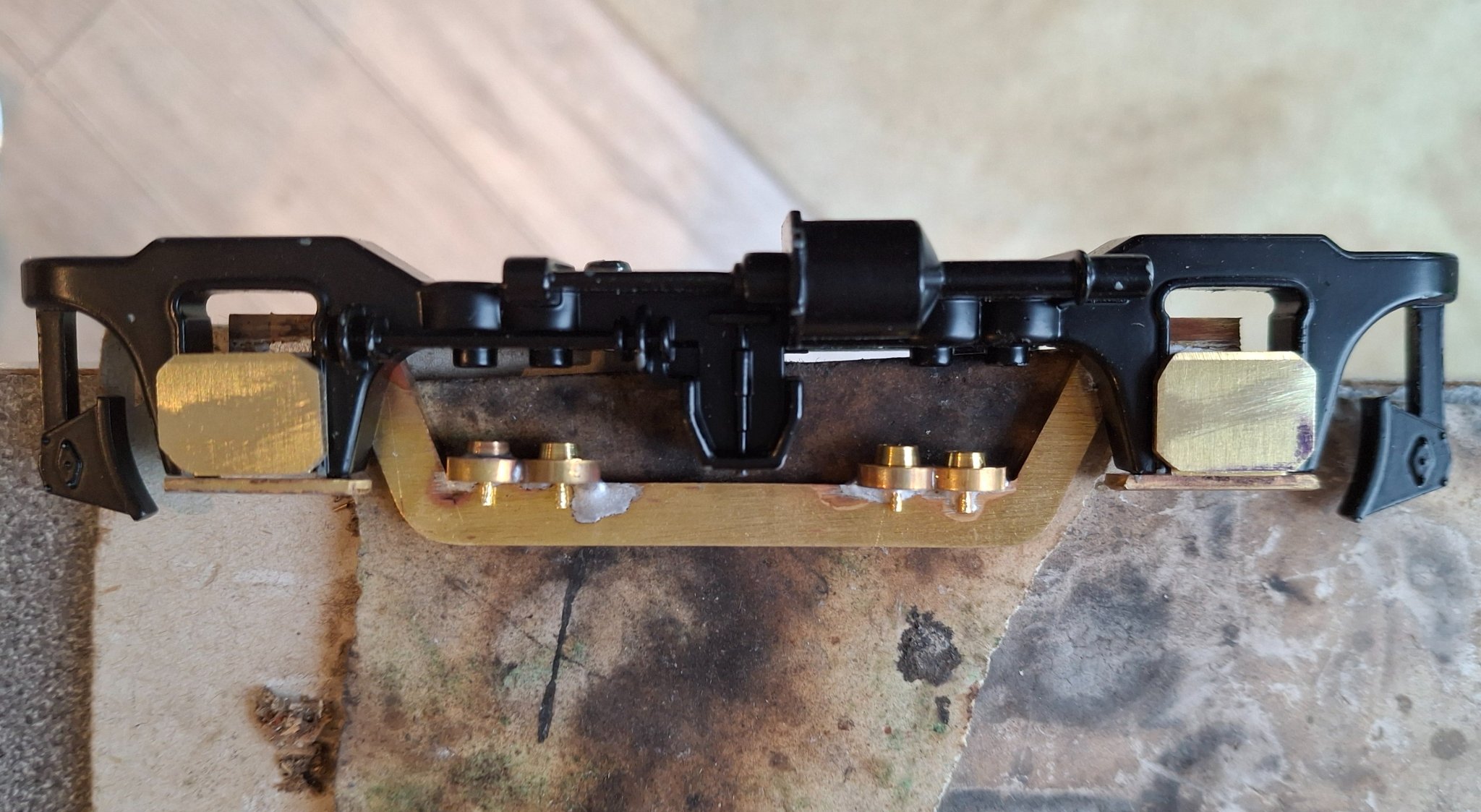

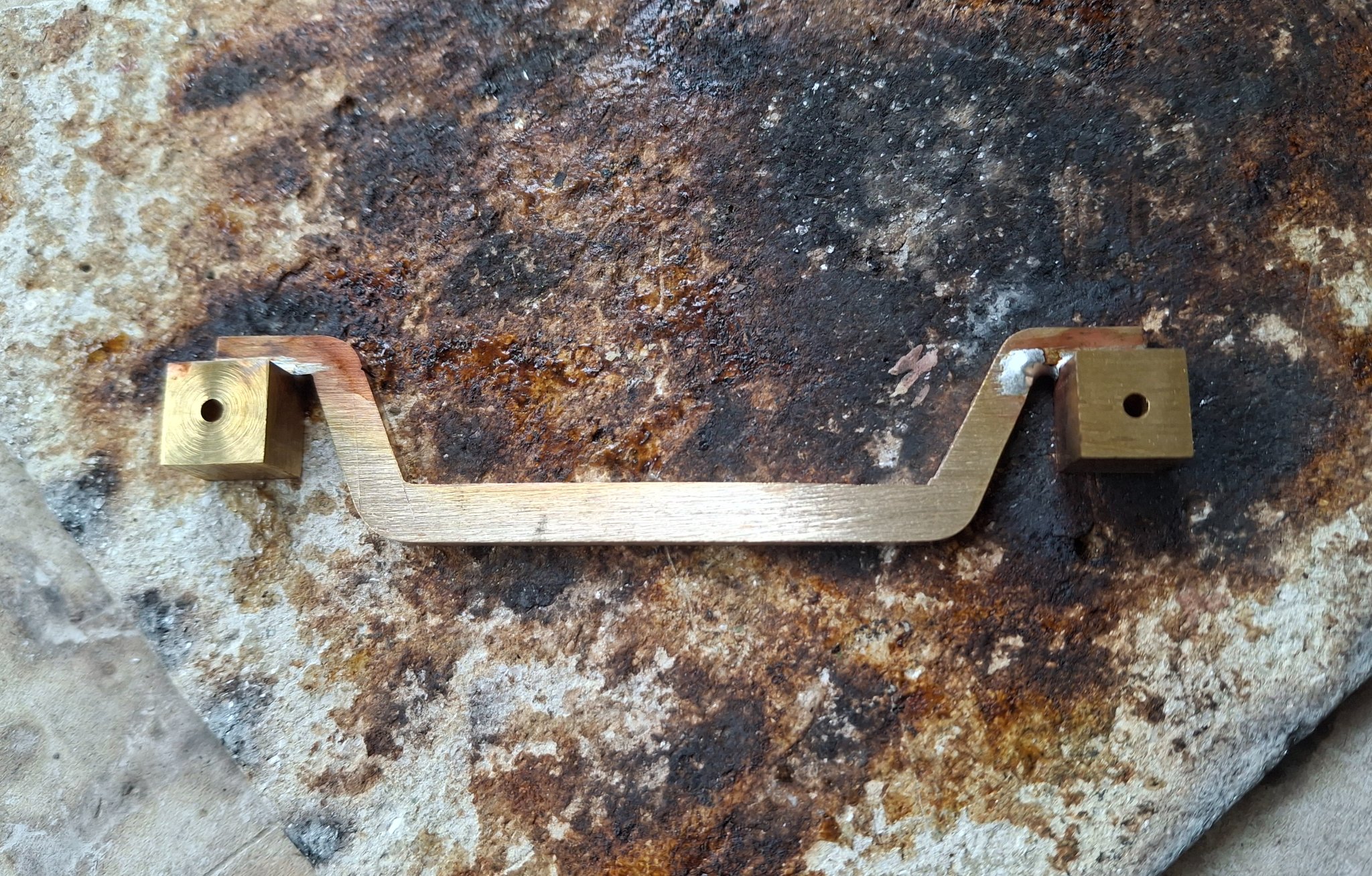

By a happy coincidence, a new bandsaw blade had arrived; the description said that it was suitable for non-ferrous metals. Now, I've cut aluminium on a bandsaw, but not brass; but, I reasoned, brass is non-ferrous...View attachment 348408

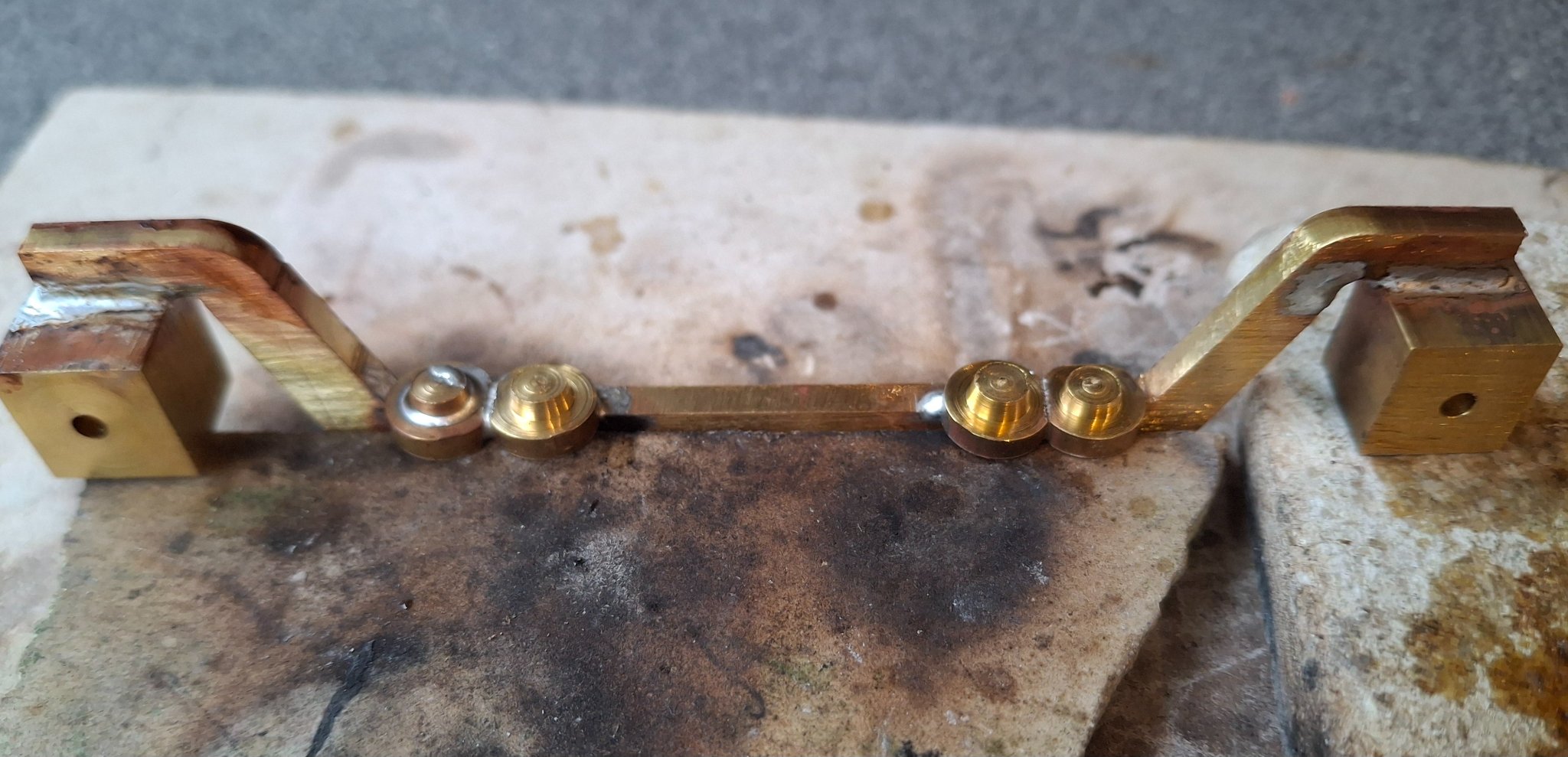

...and it cut beautifully! The axleboxes were soldered on
after which, I turned up some spring cups, and soldered them in place.

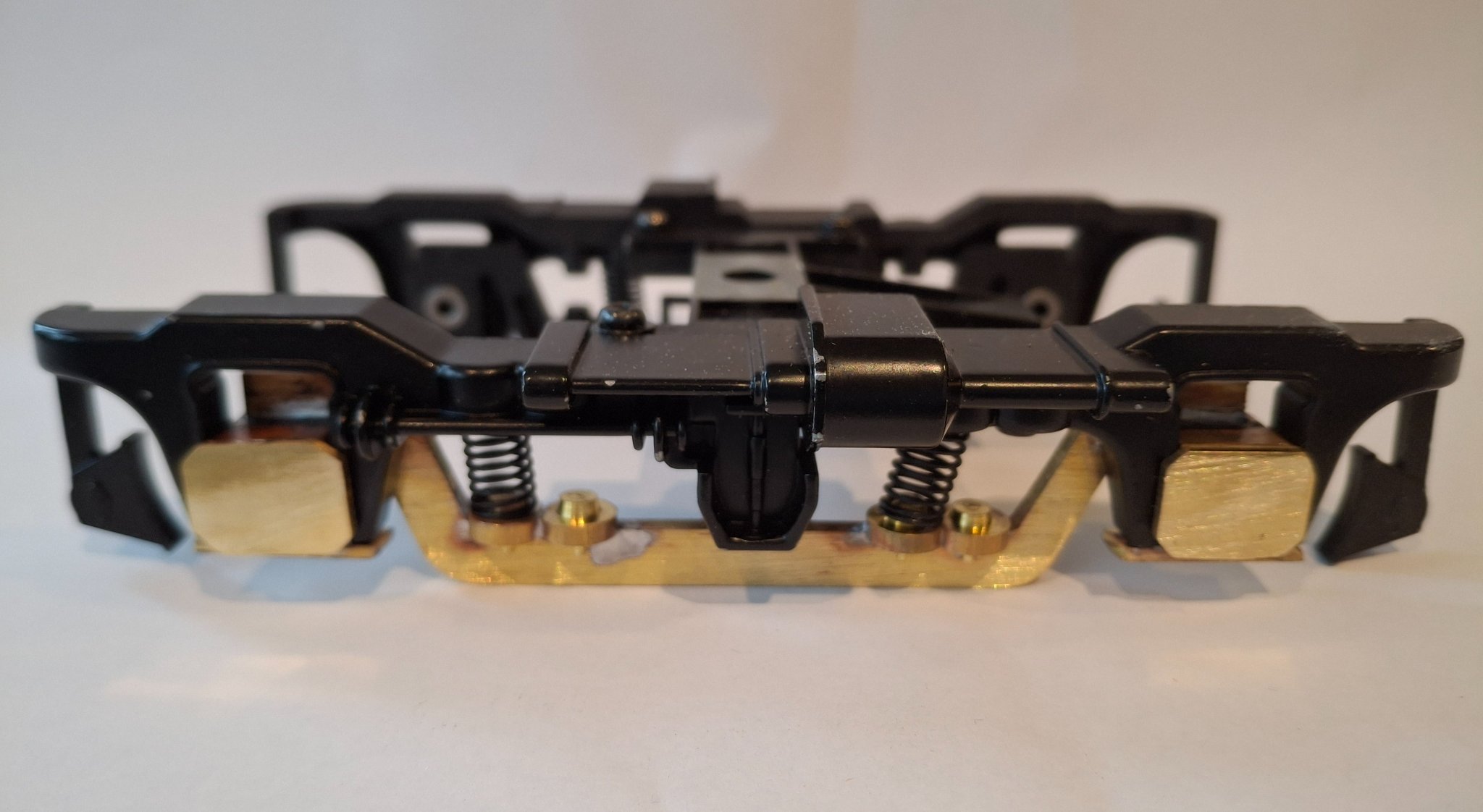

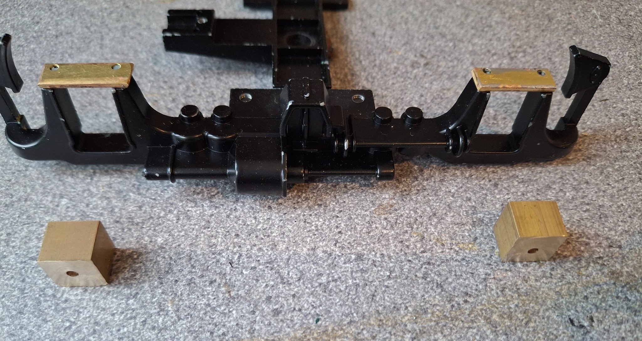

It was at this point that I realised that the new side member wasn't quite the right size but a) I was in too far and b) the difference is mostly aesthetic. So axlebox covers were sweated on with low melting point solder and a couple of springs pinched from the other side of the bogie.
View attachment 348411The result, whilst not perfect, looks well enough*. The next challenge is finding wheels and axles, the latter being a rather odd diameter...
*The spring cups don't line up, but I don't think it will show too badly once everything is painted...

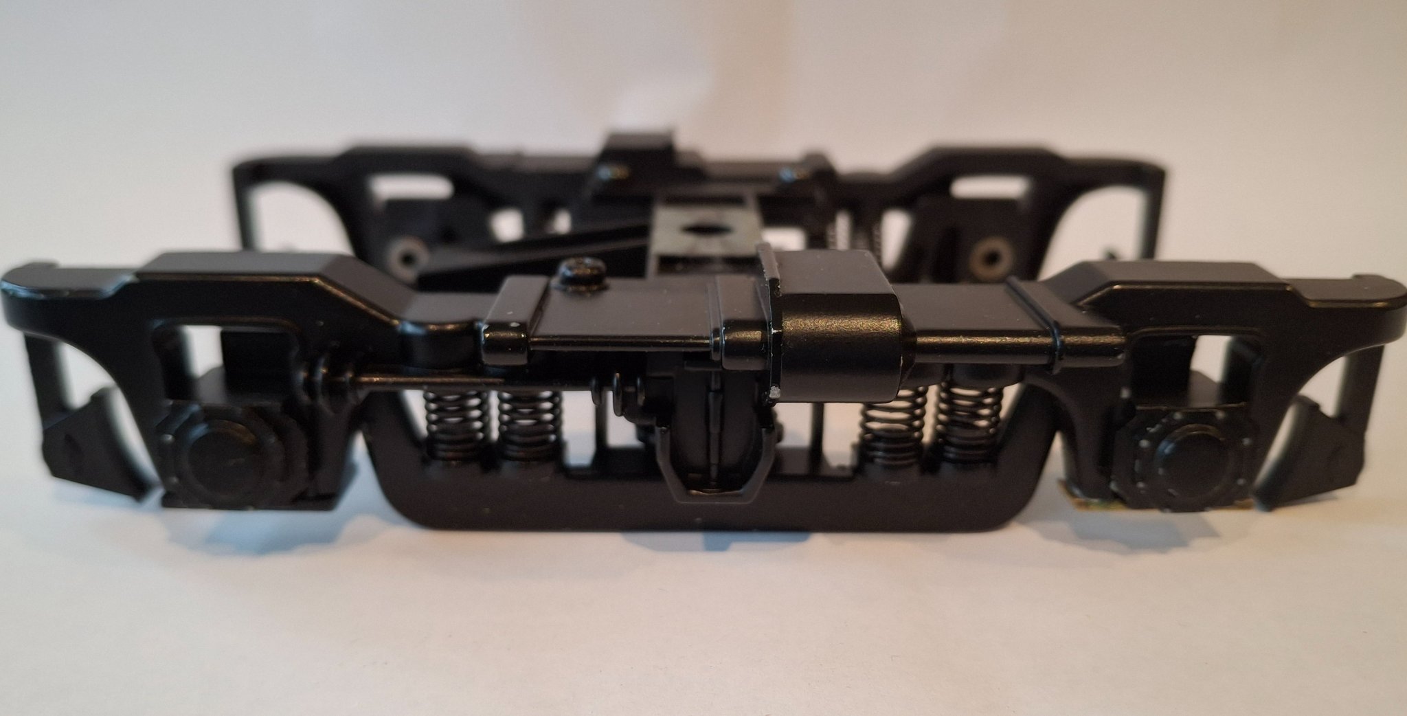

My version:
and a 'proper' one:
