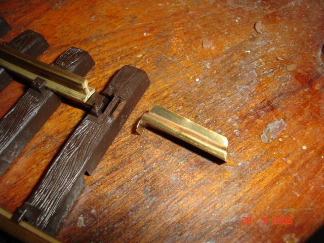

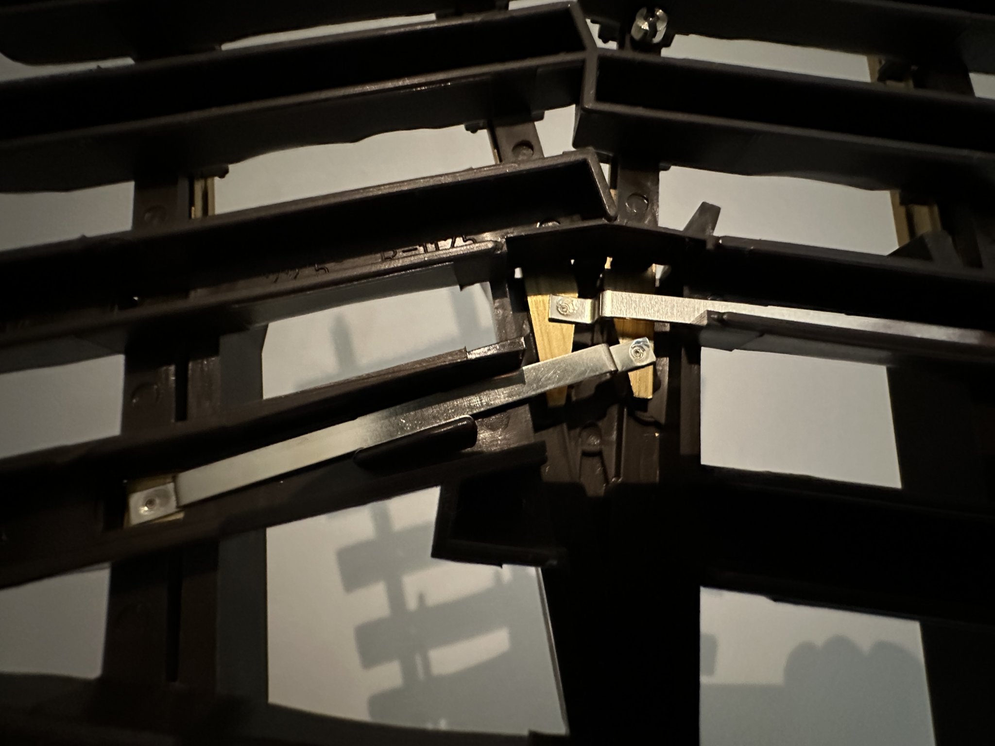

Simply stand on the right hand rail place a drift on the end of the left hand rail and gently tap till the rail slides back and the fishplate is released ease the rail back and all is done

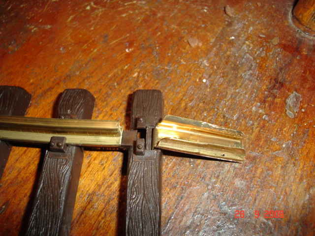

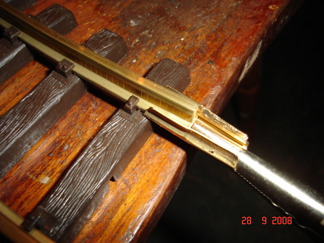

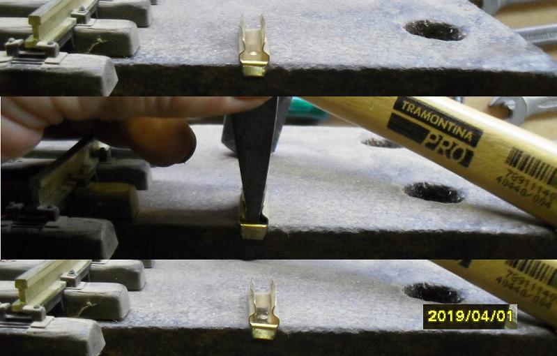

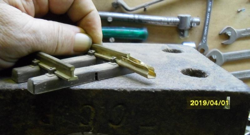

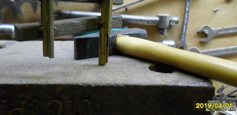

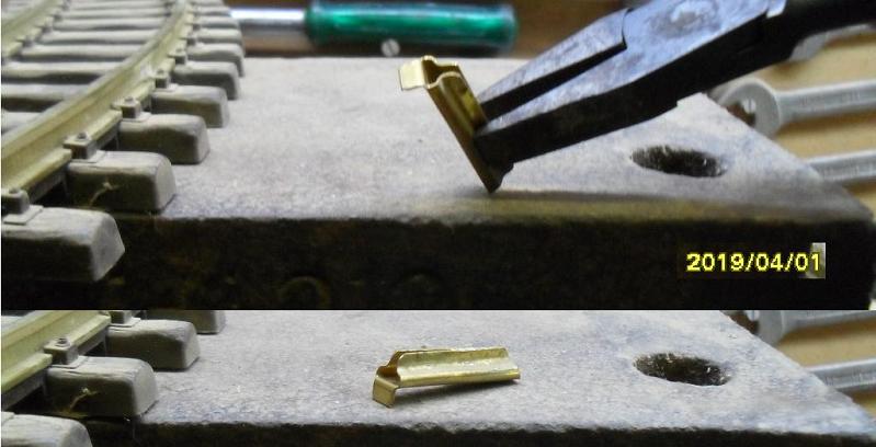

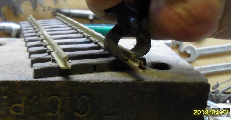

That method will not work for points as your illustration showing the rail behind the fishplate shows. My method related to earlier does work without destroying any points spot contacts as the rail with sleepers is pushed back, thus having no effect on the spot welded contacts.i do it this way:
wiggle a bit up and down toloosen it:

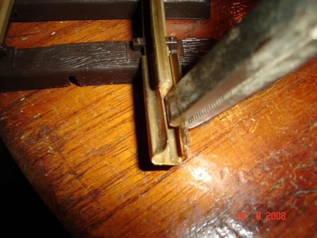

reconditioning:
first - flattening the floornipple

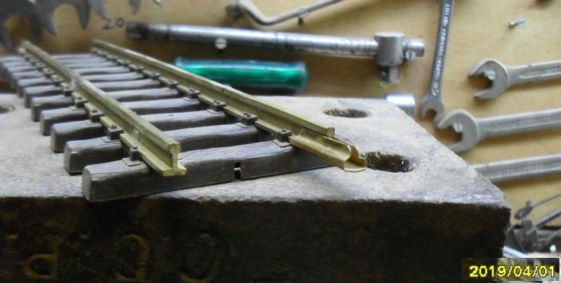

re-using:

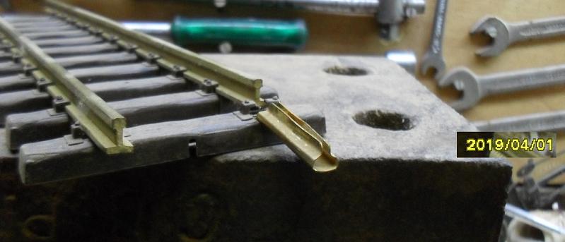

don't forget to control your work!
