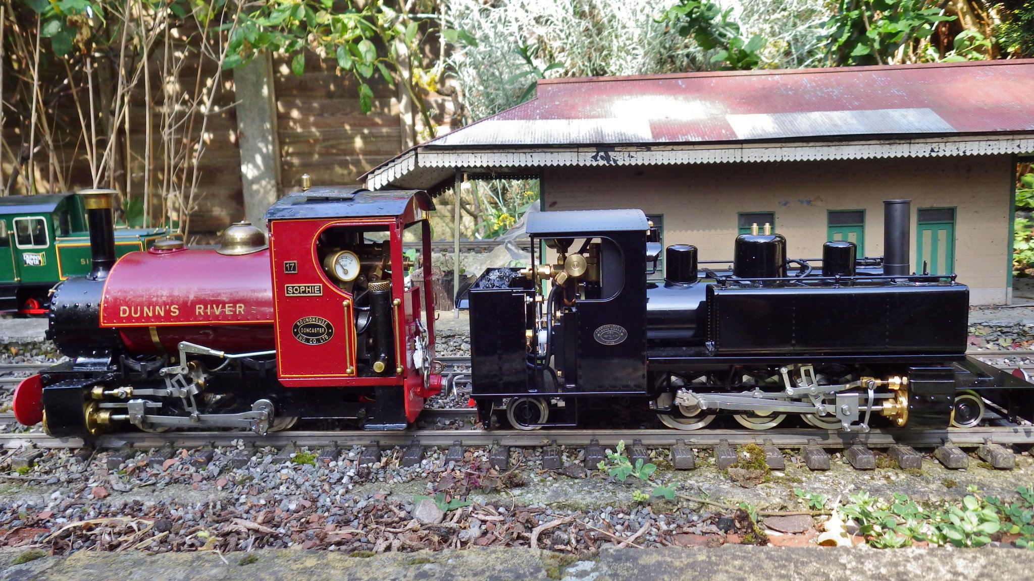

I have a Vincent and my good friend has a Challoner. Non-geared Regners do not seem very common in the UK. A few years ago someone brought an Emma to one of my open days; and it was indeed a fine loco. A bit more recently a friend brought this beast of an engine to test on my line. Originally built from a Regner kit, with every conceivable refinement: whistle, draincocks, lights etc - all r/c.As for Regner: some of their models are indeed meant as 7/8" scale, as are their Lorry kits.

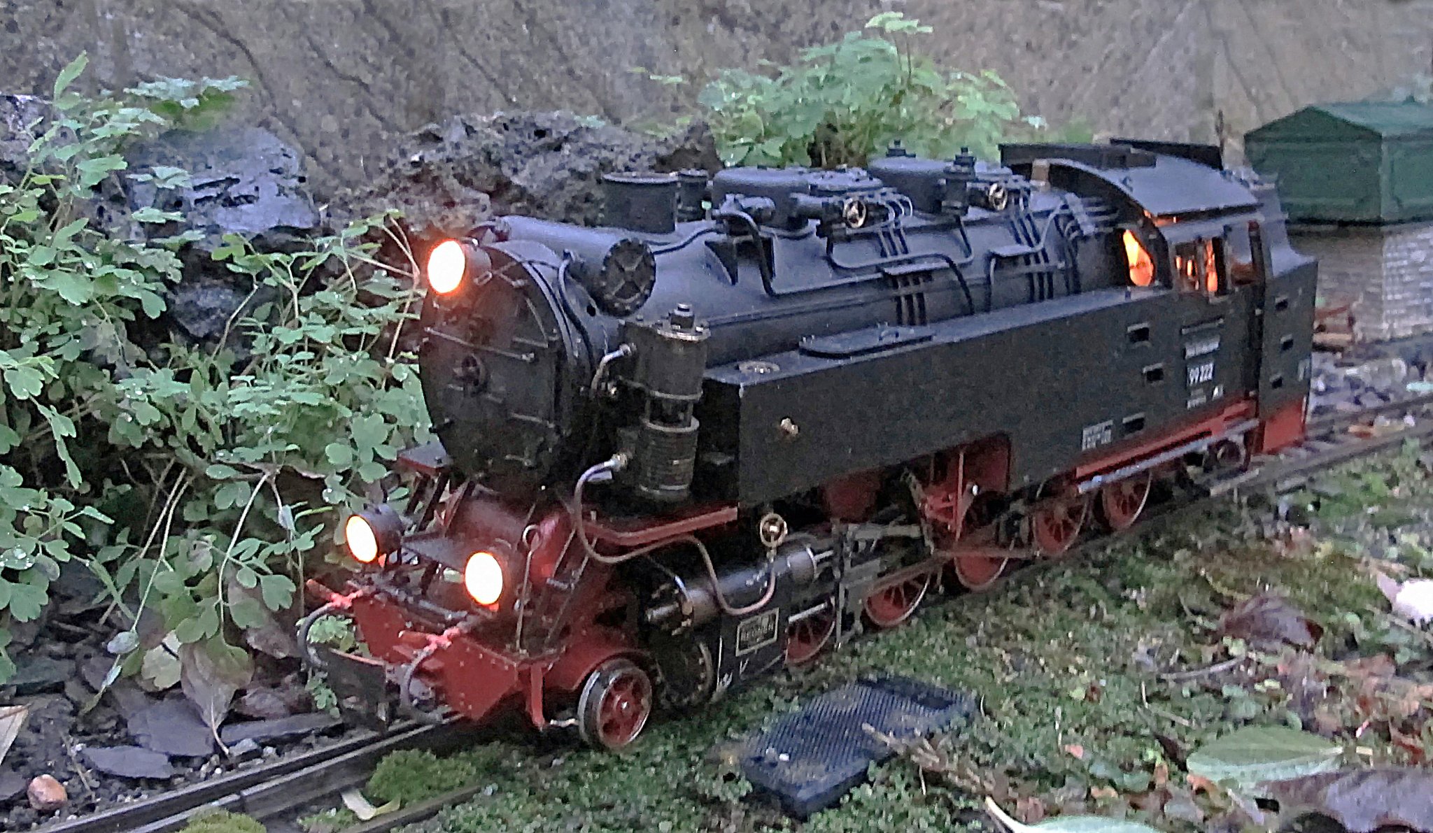

Here it is, and you can see that even an R0 curve (422 mm) is no problem. It's the curve on the near right hand side.

Very nice - how did it handle your curves and points?I have a Vincent and my good friend has a Challoner. Non-geared Regners do not seem very common in the UK. A few years ago someone brought an Emma to one of my open days; and it was indeed a fine loco. A bit more recently a friend brought this beast of an engine to test on my line. Originally built from a Regner kit, with every conceivable refinement: whistle, draincocks, lights etc - all r/c.

We only gave it a short test run before it got dark. It was ok on the R5 curves and points that I have on most of my line. We didn't try it on the R3 loops at either end.Very nice - how did it handle your curves and points?
