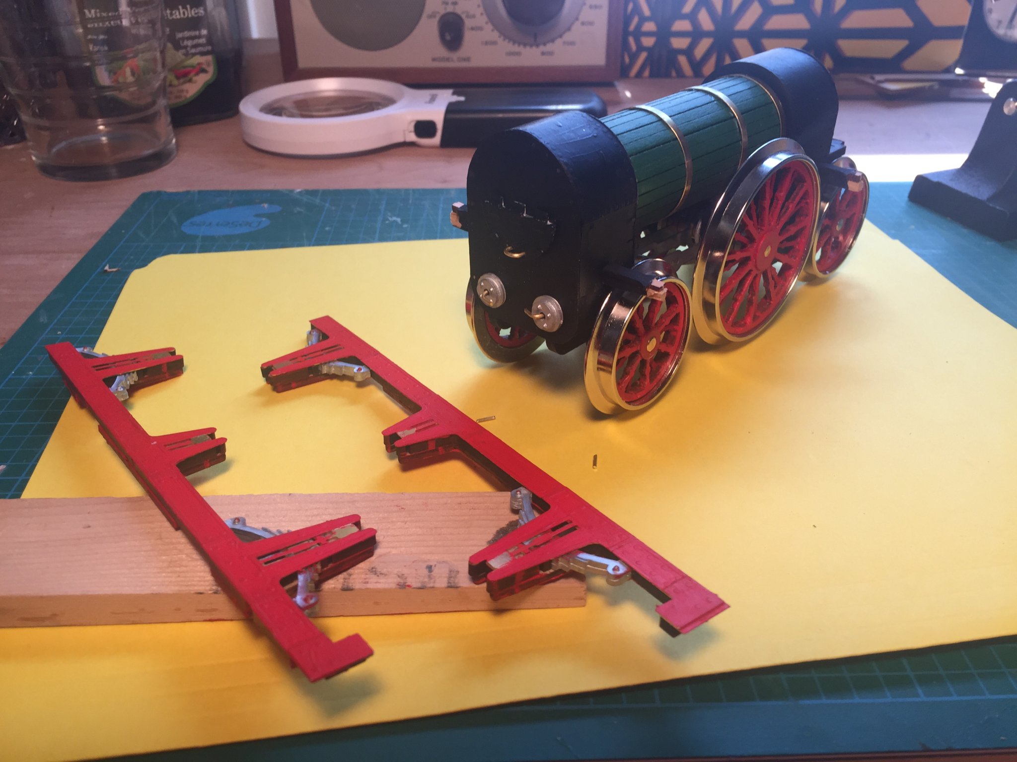

I started my new project - the Adler, a model kit from Occre. This is my second attempt. I had such fun with the Lisbon Tram, I decided to try another. The Covid lock-down has provided me with lots of time to work on these. Here are some photos showing some of my progress.

I just finished the locomotive portion of the kit. I had to make some adjustments. The part that mounts the smokestack was missing, so I had to make my own version. I also used the leftover borders from the brass cut-outs to make some trim which I added here and there.
I had a hard time getting small pieces of brass rings to glue and take hold, especially on painted wooden parts. Perhaps I should glue the brass to naked, pre-painted wood? Also painting the brass was a challenge. I did a bit of sanding, and used IMG_0860.JPGacrylic paints, but the paint came off easily. Maybe I need to use a primer of some sort. I did experiment with a shellac, but it didn't make any big difference. So if anyone has any suggestions, I would appreciate it. IMG_0855.JPGIMG_0855.JPGIMG_0857.JPGIMG_0857.JPG

I had a hard time getting small pieces of brass rings to glue and take hold, especially on painted wooden parts. Perhaps I should glue the brass to naked, pre-painted wood? Also painting the brass was a challenge. I did a bit of sanding, and used View attachment 268546acrylic paints, but the paint came off easily. Maybe I need to use a primer of some sort. I did experiment with a shellac, but it didn't make any big difference. So if anyone has any suggestions, I would appreciate it. View attachment 268544View attachment 268544View attachment 268545View attachment 268545
MMmm an etching primer is recommended with most metals - brass is particularly tricky.
Humbrol used to make a plumbate (?) primer - canary yellow, but it worked with most things.
I use an etching primer from Halfords - it's OK to spray on everything, and I believe it's a US manufacture because it has a # before the number (#5 maybe ?? )

Thanks, I'll look into this.

Carl, before you even begin to paint - give everything a coat of the Tamiya All-surface primer. Too late now, I know, but for future models.

Just finished the Adler locomotive and tender. I made a number of changes and a few enhancements. Now, on to the next project- Stephenson's Rocket.DSCN6837.JPGDSCN6838.JPGDSCN6837.JPGDSCN6837.JPGDSCN6838.JPGDSCN6838.JPGDSCN6844.JPGDSCN6837.JPGDSCN6838.JPGDSCN6839.JPGDSCN6840.JPGDSCN6842.JPGDSCN6843.JPGDSCN6844.JPGDSCN6838.JPGDSCN6839.JPG
